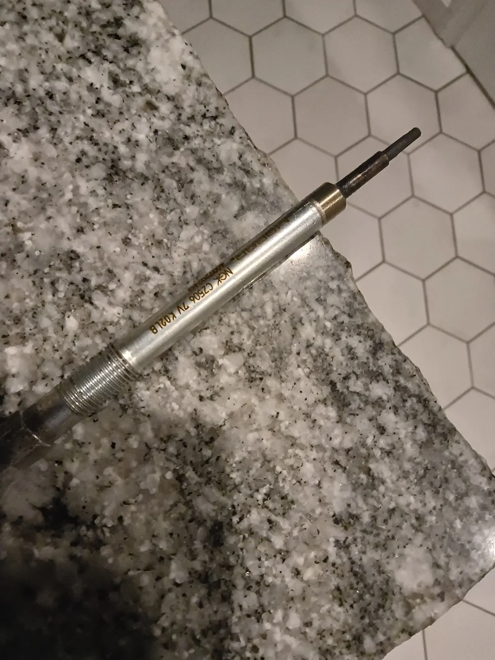

So besides the cover what else needs to come off to take them out?
RickelPickel
Rickel
Jun 25, 2026
Jeep Gladiator
On the drivers side= air filter duct, the air duct from the inner cooler, and the metal plate under the inner cooler duct. The passenger side I’m not sure as I only replaced #4 plug.
