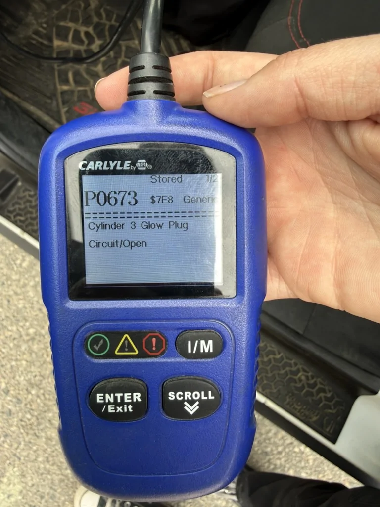

Passed by NAPA and they connected a generic OBD2 reader and got error P0673 Glow Plug Circuit/Open.
Chat GPT said it was 90% sure it was that a glow plug coil failed/broke and the circuit was open. But then 1hr later we stopped and on restart the CEL was gone....

The lady using the reader was not to familiar with it... and im just now seeing the 1/2 on the top right... Now that im back home i might go to another auto parts store and see if they can read old codes and see if anything else is there.

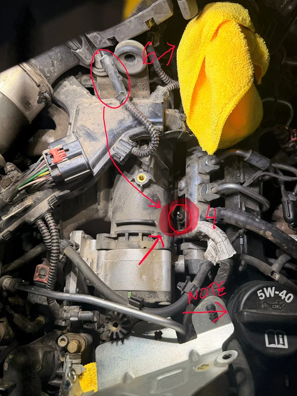

Jeep Gladiator CEL/Glow Plug Flashing on Dash - P0673 Glow Plug Circuit/Open IMG_0294
I just replaced my number 4 cylinder plug a few weeks ago. Just look for the little harness (circled in red). The picture above is for the driver side. The plugs/cylinders are numbered going from front to back= 1,2,3 are on the passenger side. And 4,5,6 are on the driver side. Yes the glow plugs are hard to find the first time (Put hair on it and turn the lights off, I could have found it right away!). The plug wires pull off just like a spark plug boot. I recommend putting brass high temp antiseize on the new ones going in (Threaded part only). Hope this helps.
