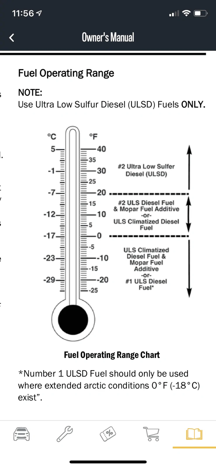

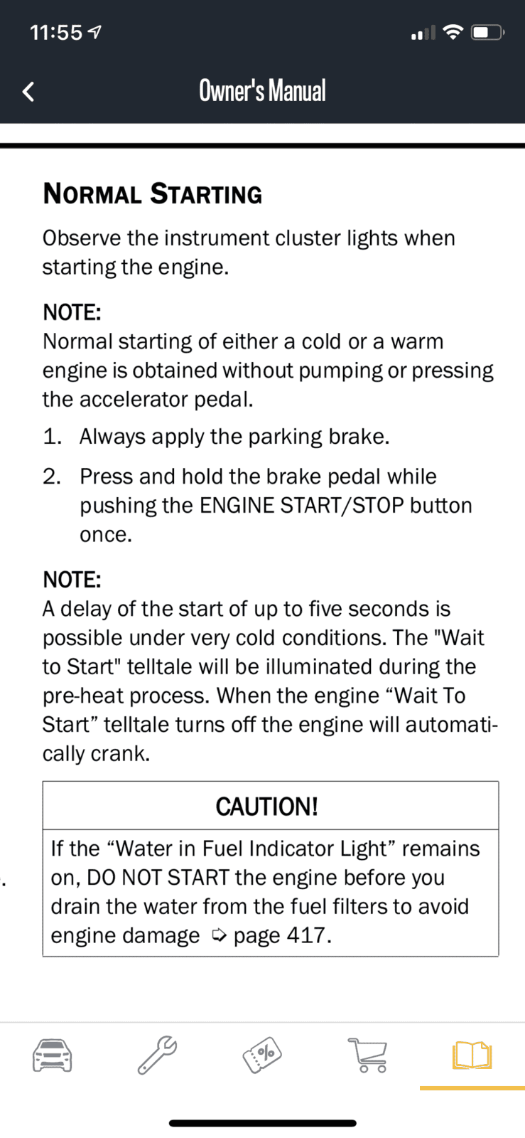

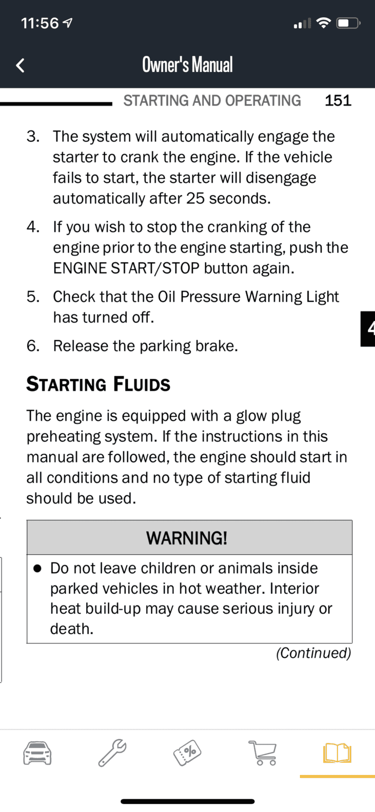

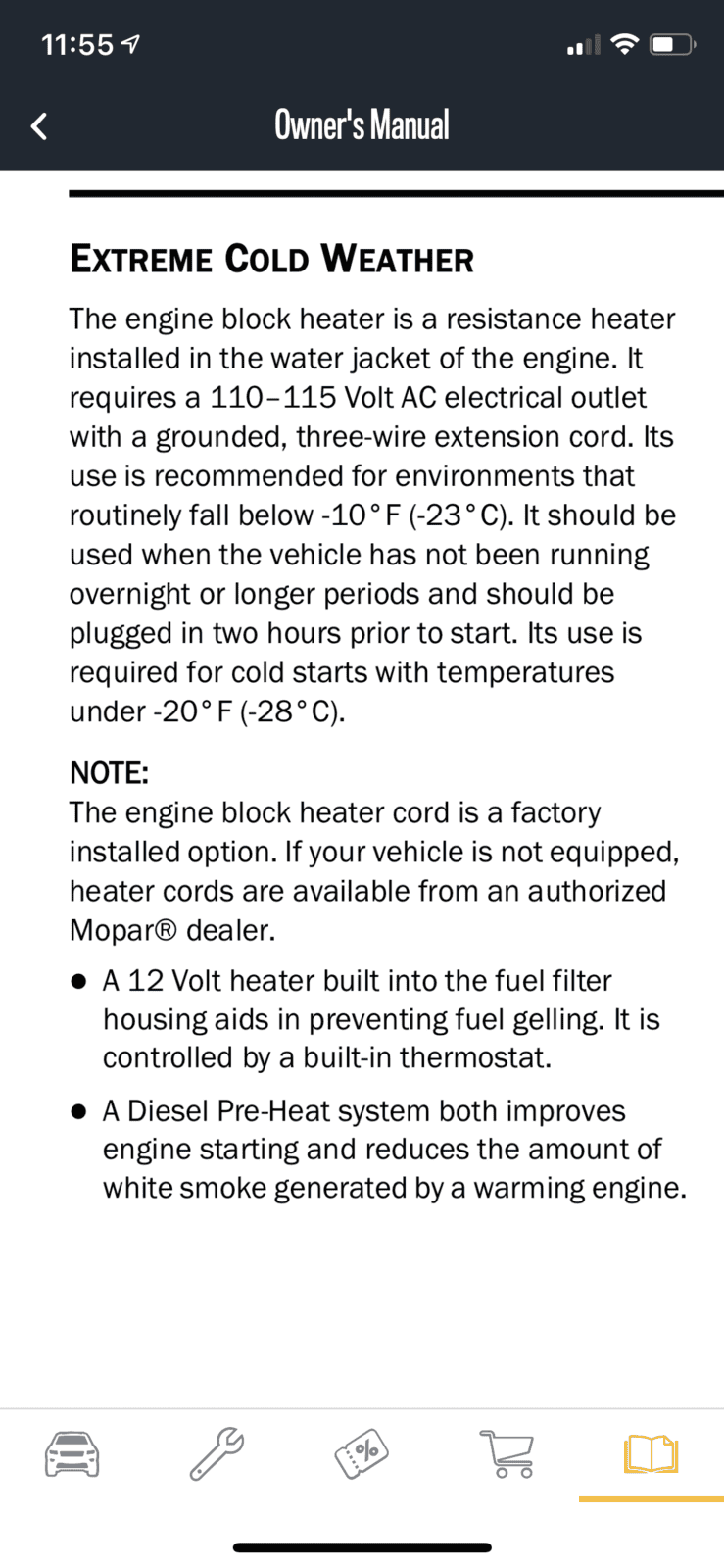

Okay, found answer in the manual. Imagine that? LOL
Cliff noted: down to 0, no issues.
p.151 in my manual

Even though the winter blend diesel fuel has some anti-gel formulated into it out of the pump, it would be a good idea to get a bottle of anti-gel additive to mix with the fuel any time it is in the single digits, or colder. You won't be going anywhere in the morning if your fuel gels up overnight. Take that for what it's worth from a Class A CDL driver.

Diesel 911 is always good to have on hand. It helps to get gelled fuel back to a liquid state.

it does have a 12v heater on fuel filter and the computer will not let engine crank until glow plugs have done their thing.
