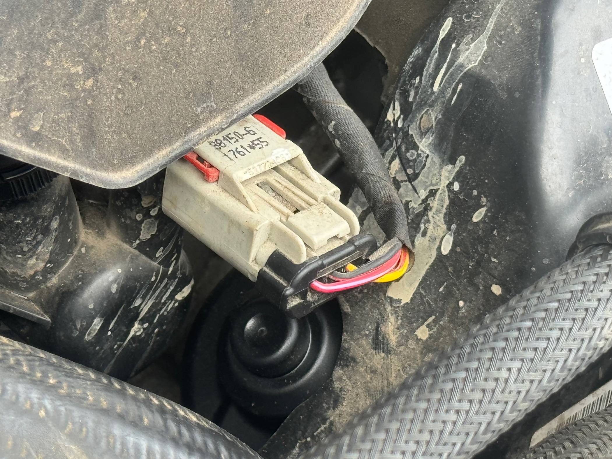

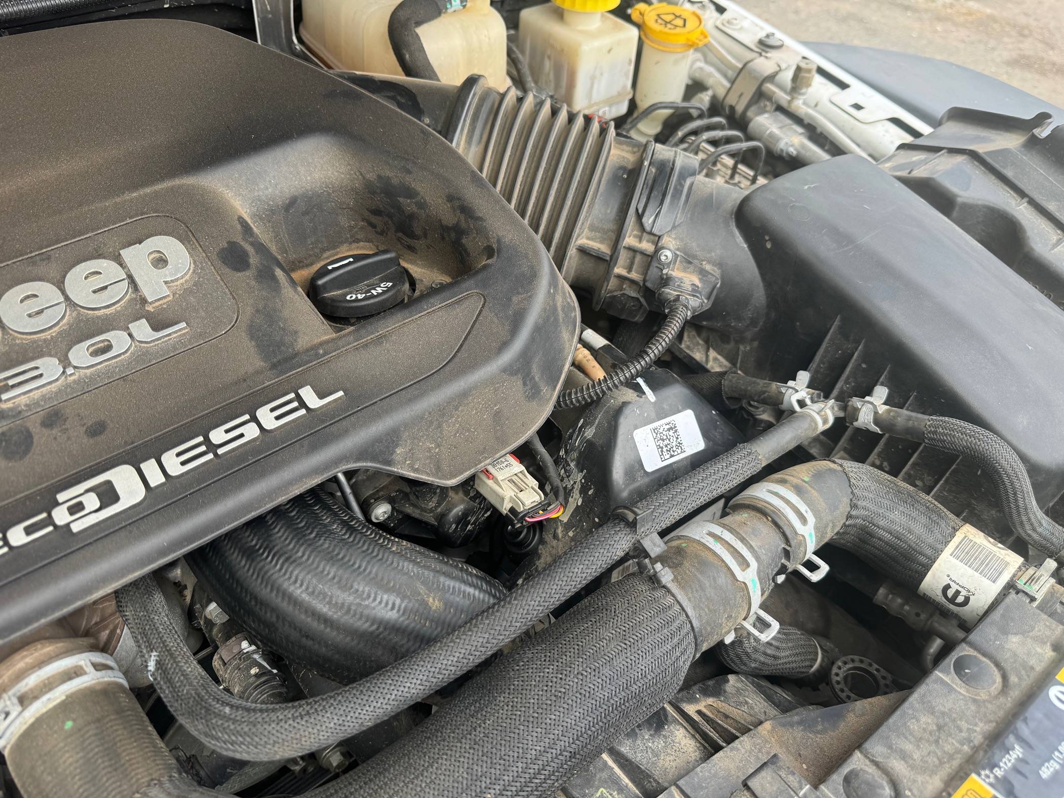

The original pump is so dirty, it will be obvious if it was replaced or not. It would take more work to clean it than to replace it.
