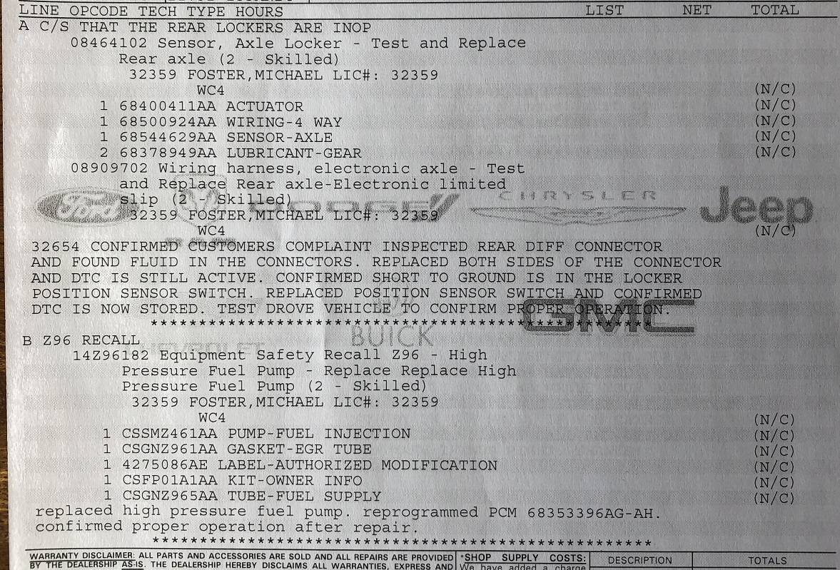

@DylanM Can you check if there is a part number for the PCM flash on your paperwork? Something like 68353396AH.
Bottom line shows the PCM reprogram. I am starting to wonder if it's just the earlier models that are getting a target of opportunity software update to the latest version, hence the disparity as to why some are saying they got a reflash while others aren't.
@DylanM Looks like that is what is happening as I received 68353396AH back in Jan of 2023 so it wouldn't be specific to the new CP4 fuel pump. Thanks for posting as it confirms that 68353396AH is the latest PCM version to date.

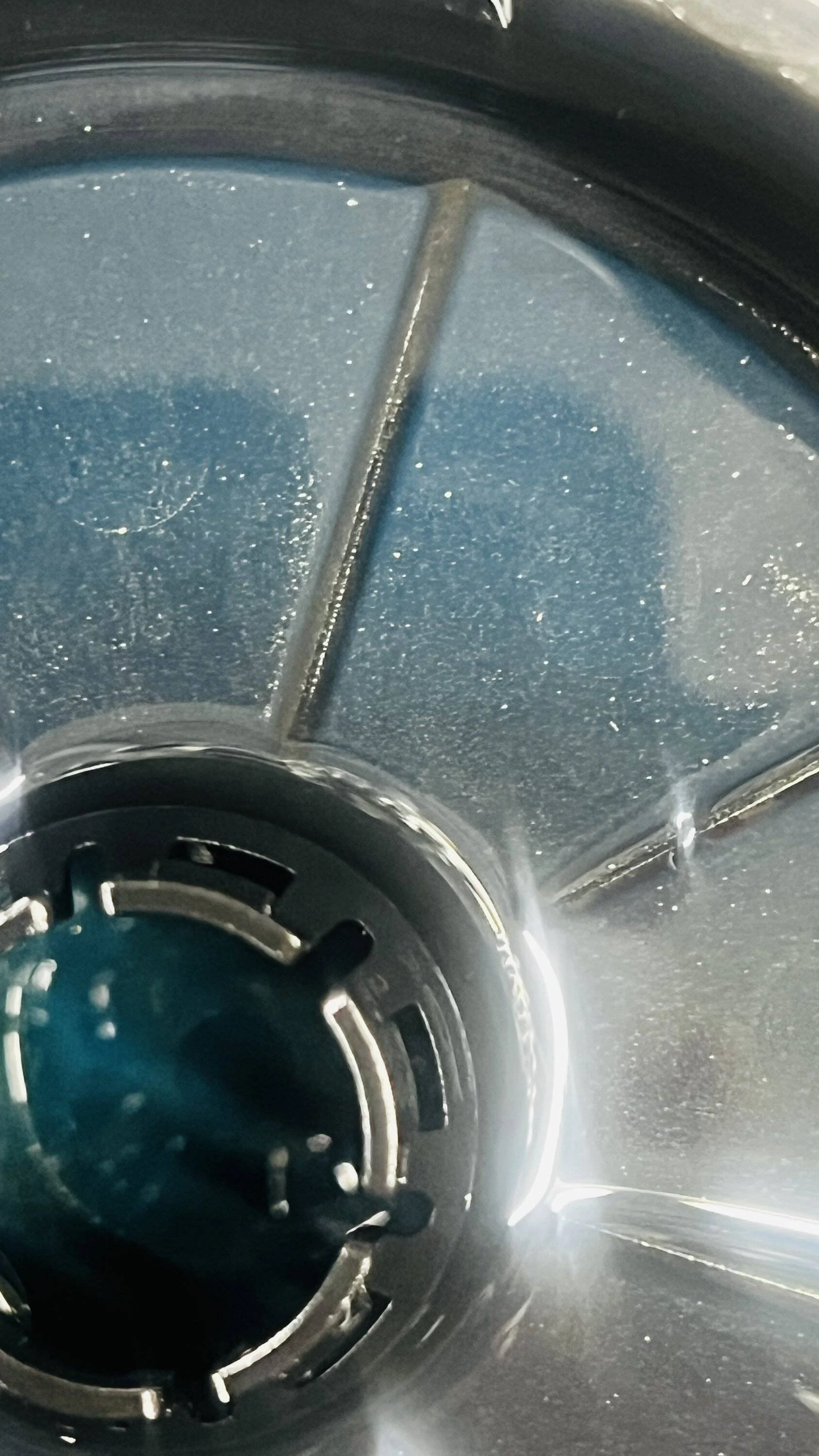

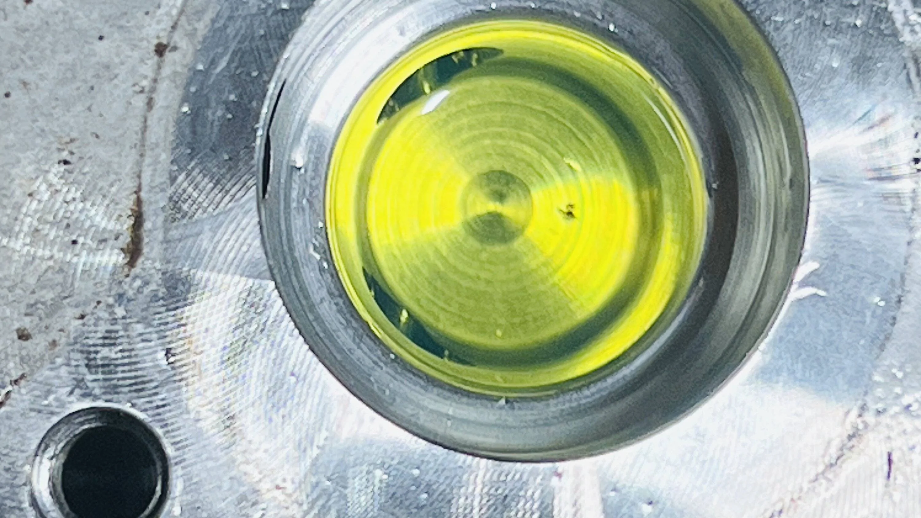

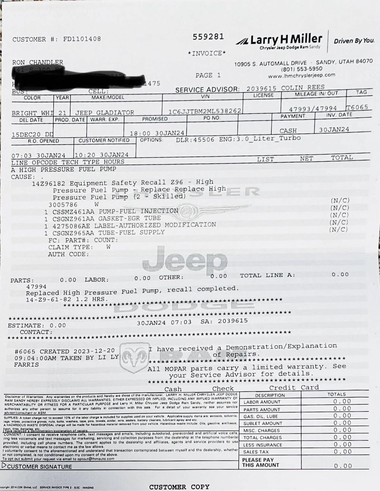

I just got mine done today. They said they could not find any metal in the system so only the pump was replaced. They would not tell me what they check, where they check, or anything about the procedure for finding contaminating metal in the fuel system. So as I was told by others, if it is running when you bring it in, you only get a new HPFP.
Here is my documentation photos of metal in the pump and in the filter housing.
And the INVOICE for the RECALL repair.
I feel better that it isn't making anymore metal and the filter should clean out anything before it gets back to the pump.
Cheers.
