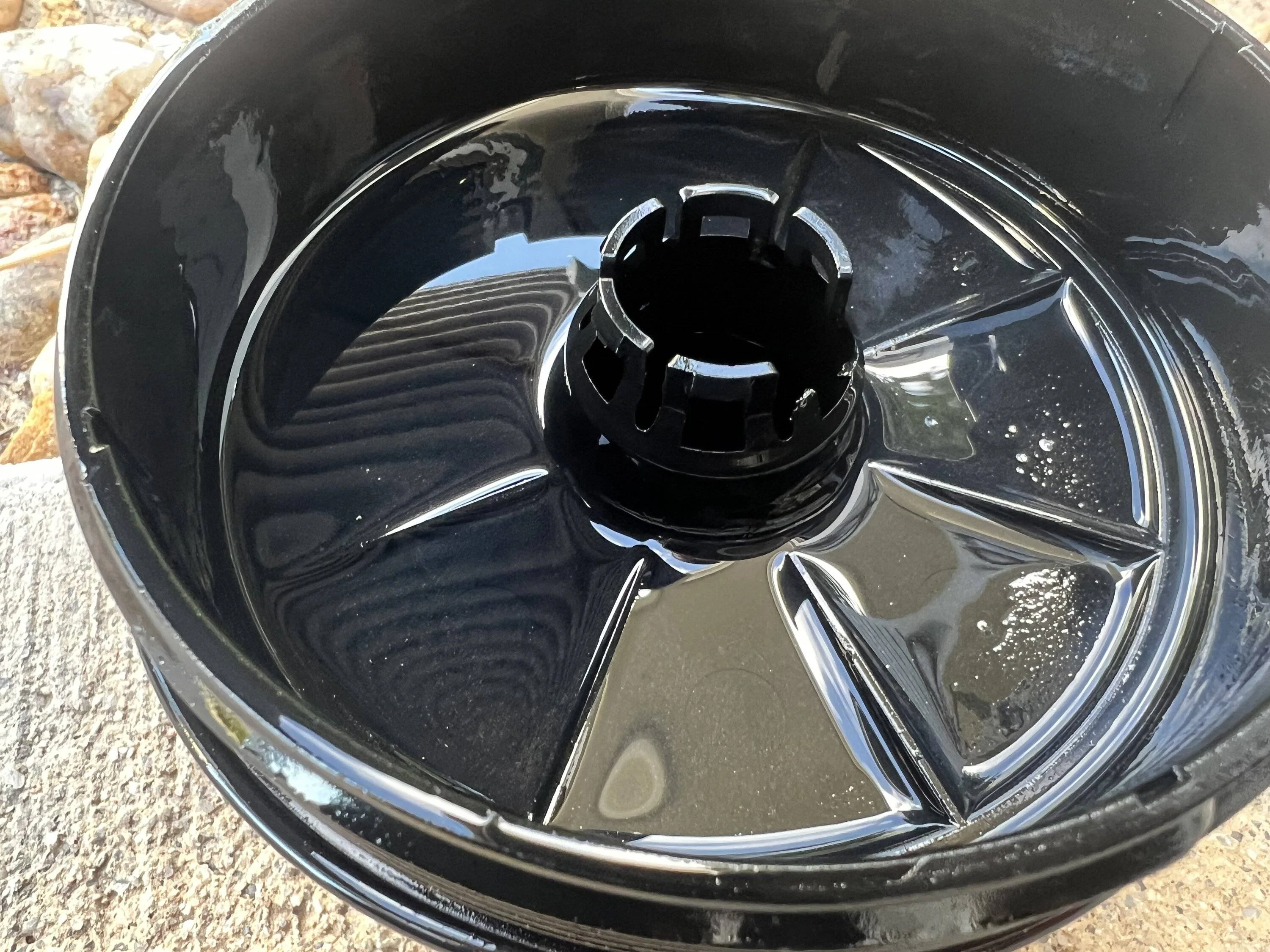

@JeepCares setup an appointment for me to get my jeep inspected and have the safety recall completed as my fuel filter housing is showing metal shavings.

Did you check the sediment in the fuel filter to see if it was metallic? Algae is commonly mistaken for metal shavings and is very similar in appearance to what you’ve posted.
Yup! it was a mixture of both.
My pump, lines, etc. has been replaced and all is good now.
