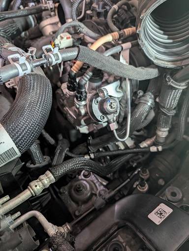

New pump installed
Jeep Gladiator HPFP aftermarket fix? 1000005670small
Like I said, they cover and foam insulation is a bit difficult to get back on. I did have some before pics to help. I'd recommend watching closely when you remove it (better than I did), so you can get it back on.
I've been driving for a few days and everything is just fine - no leaks or anything funny. I had to put the Banks Derringer on the highest setting and drive "spiritedly" (lol) to test it. Everything is fine
12,253
32,616
I'm happy to post a bit more. I followed the Stellantis procedure for the most part.
Some notes - If I were trying to be quick, I could probably finish in 2-2 1/2 hours. I was in no rush, so I took my time at 4 hours. The hardest part? Putting the stupid cover with the rubber insulation back on...tight spot and its a bit grumpy to get it together.
Special tools I used included the Mopar installation studs (~$70, could be replicated by cutting the heads off of 2 bolts the same thread/length - I can measure if anyone wants me to), and a small spanner wrench for installing the gear and clocking it. Pictures below. Instructions called for a degree wheel, but I didn't use it (to mark the gear position when removing the old pump).
The procedures say the high pressure fuel lines to the heads are not re-useable, so I bought a set along with an extra o-ring for the pump (RCD sends one on it). Those parts cost me about $150 with shipping and I didn't use any.
The lines are stainless steel with a bubble flare. If they leaked, I was prepared to change them. The fittings are visible with the cover installed.

The gear on my OEM pump had a small blue mark and the round hole for the spanner wrench. There were no marks on the shaft or pump; i believe the gear will be in a random position when removing it. There are plenty of landmarks to use though. You'll see in my pictures that used a blue sharpie to mark the orientation. I aligned it to the hole on the gear.
The gear only fits on the shaft in one position dictated by a slot on the gear and an associated roll pin on the shaft. To align the gear to match the original, you turn the gear (was pretty easy with the spanner wrench)

If you don't rotate the old pump when you remove it and match that orientation on the new pump when its installed, then no new timing procedure is required. There is a mechanical timing procedure that involves rotating the engine to TDC on #1 cylinder (I was hoping to avoid that and was successful). The pump doesn't turn super easy, but isn't too difficult using the spanner wrench - as long as you're careful I think the risk of losing the gear orientation is low

I only removed the cover, lines and the pump. Only consumable/wear part was the o-ring on the pump (new one provided by RCD)
