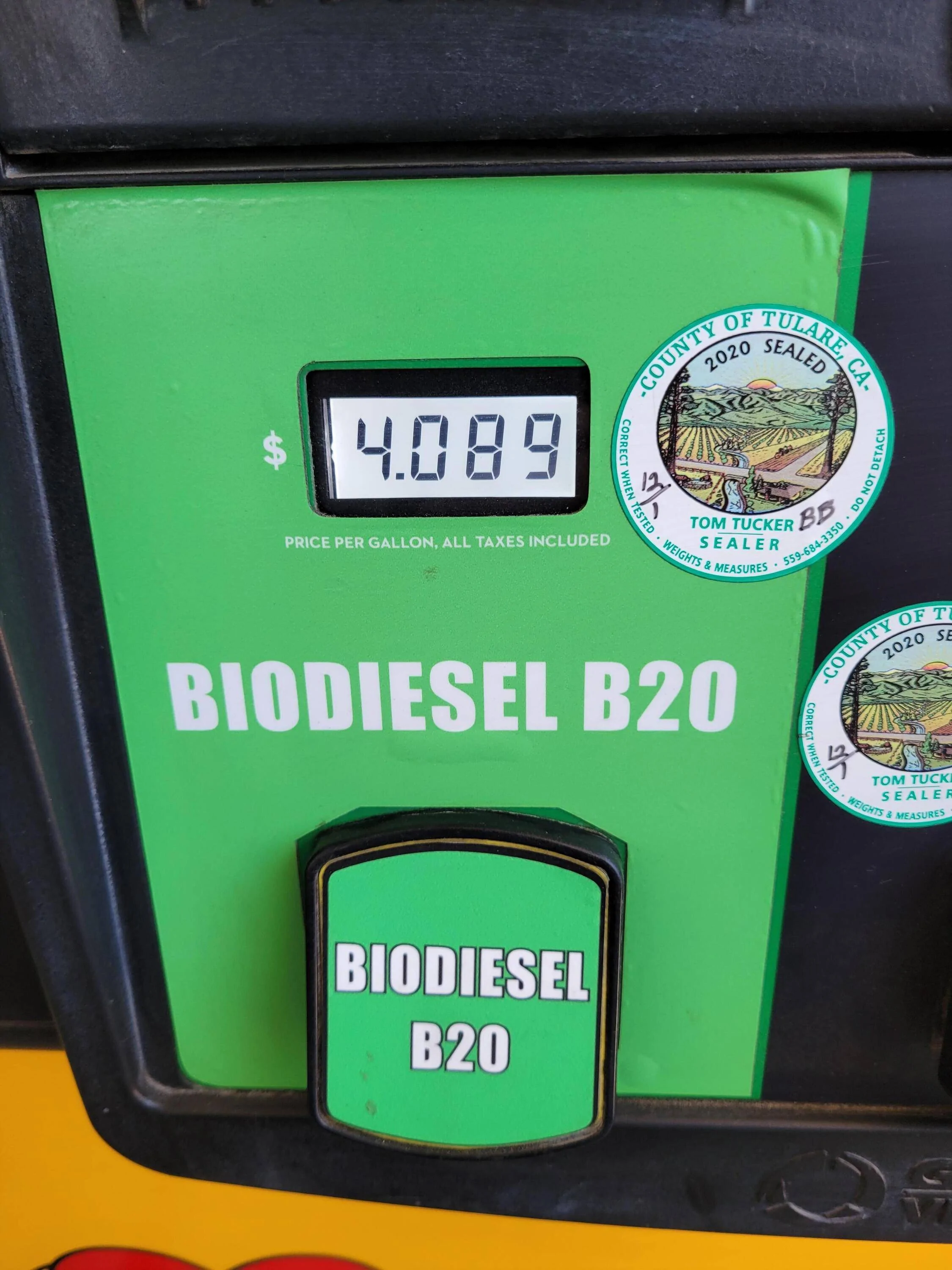

That very well could be true for other fuel stations. I can only speak for Love's. Love's will actually have a specific B-rating sticker on 'some' pumps. I've seen B2, B5, B10, B15, B19, and B20 stickers, but I've seen many pumps with no stickers at all. The website has the most up-to-date information, so that's what I look at. As mentioned earlier, California has had B20 for as long as I can remember.
Jeep Gladiator Biodiesel after HPFP X7aO4Bv
Jeep Gladiator Biodiesel after HPFP az4Yd5f
Jeep Gladiator Biodiesel after HPFP AwHM4Mr
