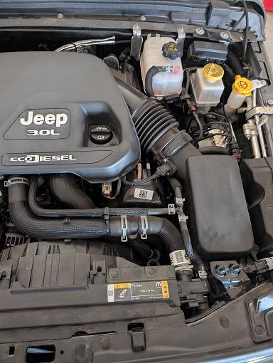

I replaced the recall HPFP with an RCD CPX this past weekend. Although I had new fuel lines, the old ones are working fine with no leaks. I took plenty of pctures. It took me 4 hours, taking my time working slowly and methodically.
Here it is installed before the charge pipe and air filter going back in

I'm happy to post a bit more. I followed the Stellantis procedure for the most part.
Some notes - If I were trying to be quick, I could probably finish in 2-2 1/2 hours. I was in no rush, so I took my time at 4 hours. The hardest part? Putting the stupid cover with the rubber insulation back on...tight spot and its a bit grumpy to get it together.

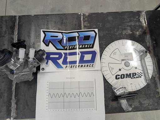

Special tools I used included the Mopar installation studs (~$70, could be replicated by cutting the heads off of 2 bolts the same thread/length - I can measure if anyone wants me to), and a small spanner wrench for installing the gear and clocking it. Pictures below. Instructions called for a degree wheel, but I didn't use it (to mark the gear position when removing the old pump).

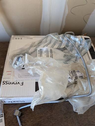

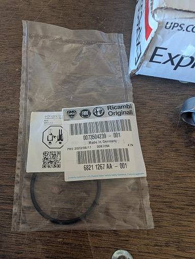

The procedures say the high pressure fuel lines to the heads are not re-useable, so I bought a set along with an extra o-ring for the pump (RCD sends one on it). Those parts cost me about $150 with shipping and I didn't use any.
Jeep Gladiator HPFP aftermarket fix? 1000005659small
Jeep Gladiator HPFP aftermarket fix? 1000005660small
The lines are stainless steel with a bubble flare. If they leaked, I was prepared to change them. The fittings are visible with the cover installed.

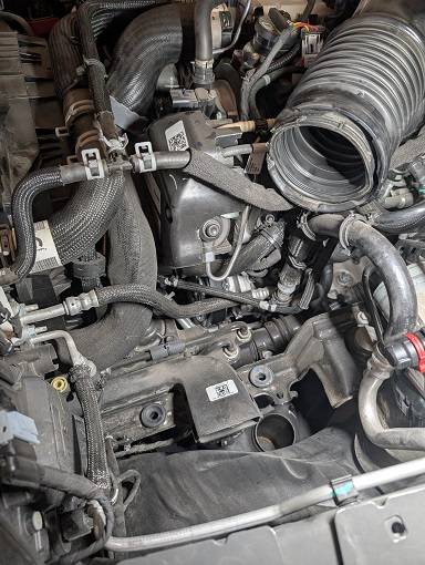

Its tight in here, but removing the air box and the charge pipe gives enough room. The charge pipe has a metal ring on the top connection. I removed the bottom clamp first, pulled the rubber hose up and rotated it so I could get to both ends with a screwdriver to release it.
Jeep Gladiator HPFP aftermarket fix? 1000005655small
With the air box removed
Jeep Gladiator HPFP aftermarket fix? 1000005661small

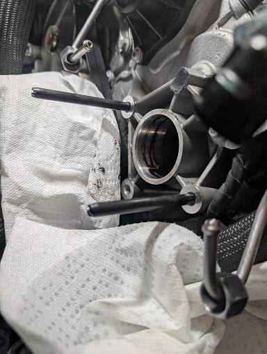

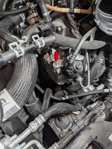

Old pump with the cover removed, top lines disconnected. Just need to disconnect the high pressure lines and then its ready to pull off. Once the 3 mount bolts were removed, there is a little room to gently pry it off the engine.
Jeep Gladiator HPFP aftermarket fix? 1000005662small
Removed
Jeep Gladiator HPFP aftermarket fix? 1000005667small
You can see the Mopar installation tools here - just studs that screw into the top 2 mount bolt locations. I only put them in finger tight. I'm sure they line up the gear for installation. Putting the new pump on took a little wiggling. I lubed the oring with a little engine oil to help. You can also see the bubble flares on the high pressure lines in this pic

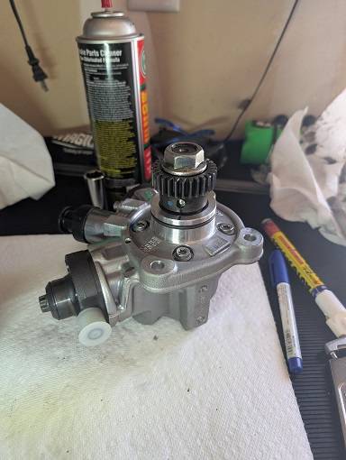

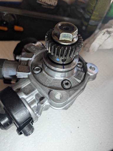

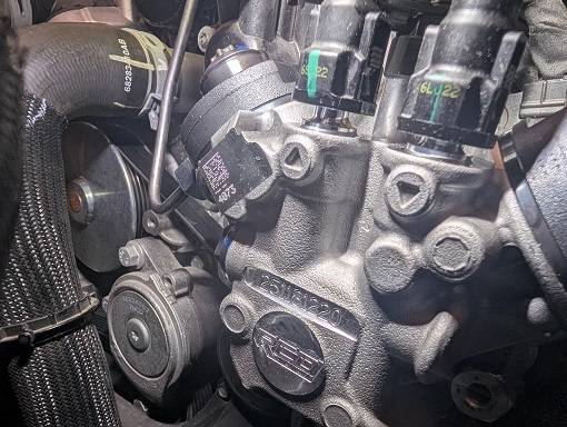

Time to swap the gear from the old pump to the new. Instructions say to torque to 37 ft-lbs. I had to use a short extension (pipe) on the wrench to hold the gear while torquing it.
Jeep Gladiator HPFP aftermarket fix? 1000005665small
RCD pump
Jeep Gladiator HPFP aftermarket fix? 1000005668small
