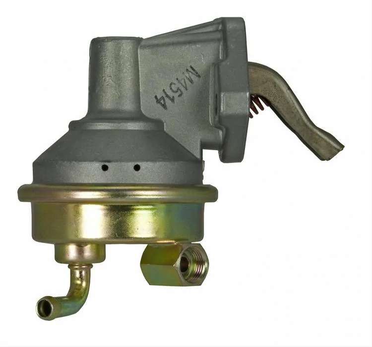

Seriously??!!! Does the gear need to be aligned with anything or is it just a mechanical pump? It's not actually timed with cylinder 1?
So just a bit more technical than an old Chevy 350 mechanical pump
Gear has a keyway, pump has slots for timing, but wherever I put mine, it worked, I'm sure the PCM just offsets as needed.
