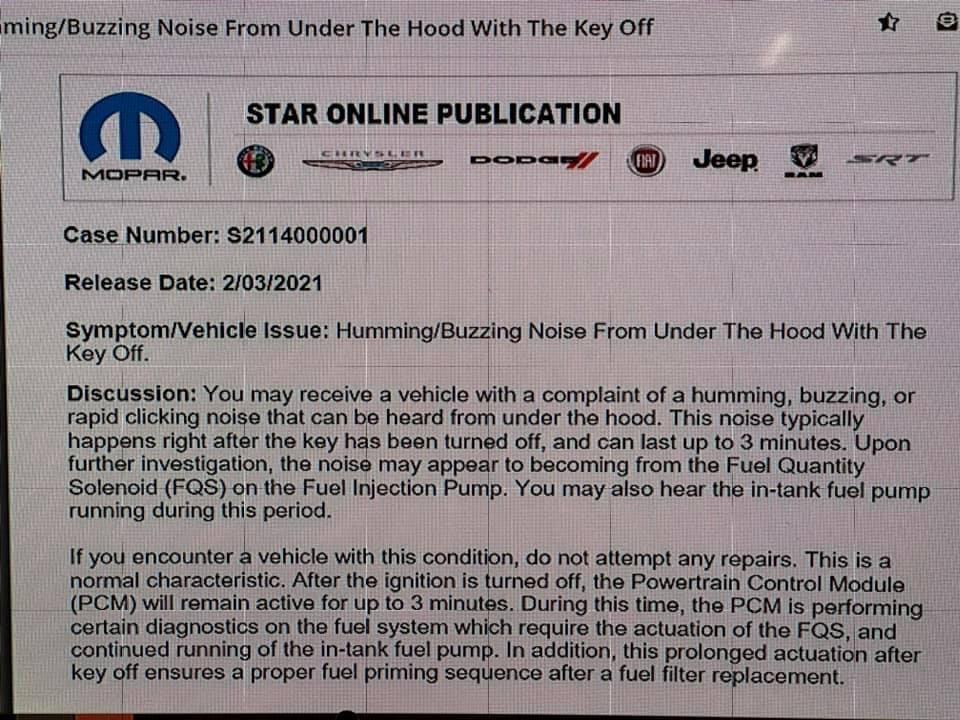

Mine makes the loud whining/squealing noise almost every cold start, it really does sounds like a fuel priming noise. If it's the throttle valve, that's the loudest throttle valve I've ever heard. The buzz after shutdown is the turbo cooling pump from what I've been told, but it looks like it is actually fuel related:
Jeep Gladiator HPFP weird sounds 195490-f511f0558b93147d1db490a37ba45cc7

There is not s pump specifically for the turbo. The cooling lines come off of the low pressure egt to cool the turbo
