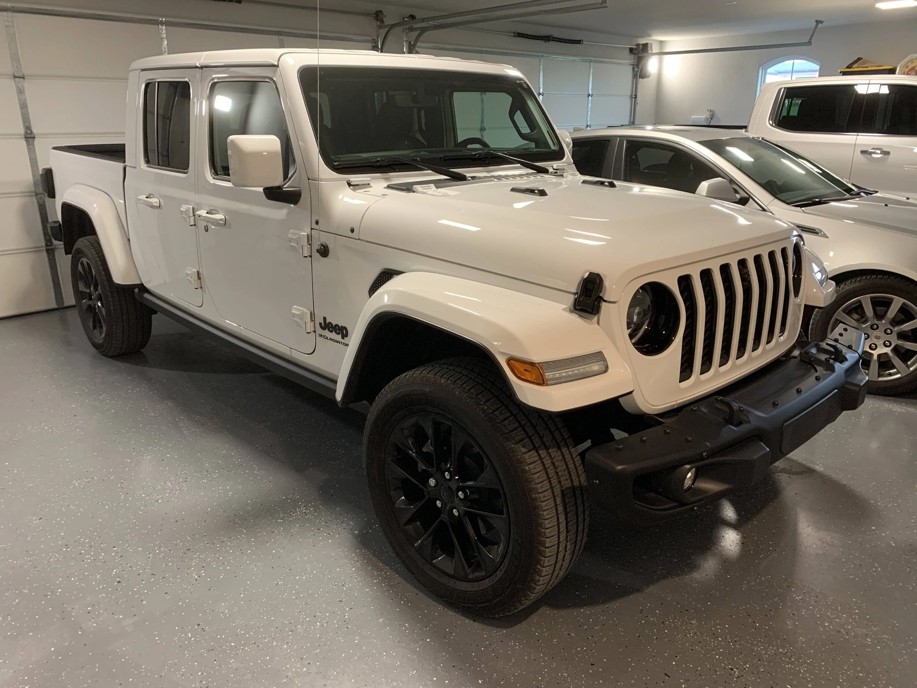

I bought the new High Altitude Diesel yesterday. 16 miles on the odometer. I forgot to take the copy of the repair sheet and the window sticker (left them at the salesman’s desk), but they replaced the complete fuel system. Drove 4 hours (240 miles) after picking it up in San Antonio, driving against a North head wind of 25mph, with 35mph wind gusts. Average mpg of ~23 at speeds of 65-70 mph. RPMs mostly under 2000. Drove great with plenty of power.

Yes, but this is not the gladiator diesel that I ordered back in March. This was one on a dealership lot that I saw advertised. They would only let me pick it up after the repair was completed.. They replaced the fuel pump plus a bunch of other parts that I don’t remember from the list. They had received the new fuel pump, and I had to initially wait an additional week on a new fuel line.
