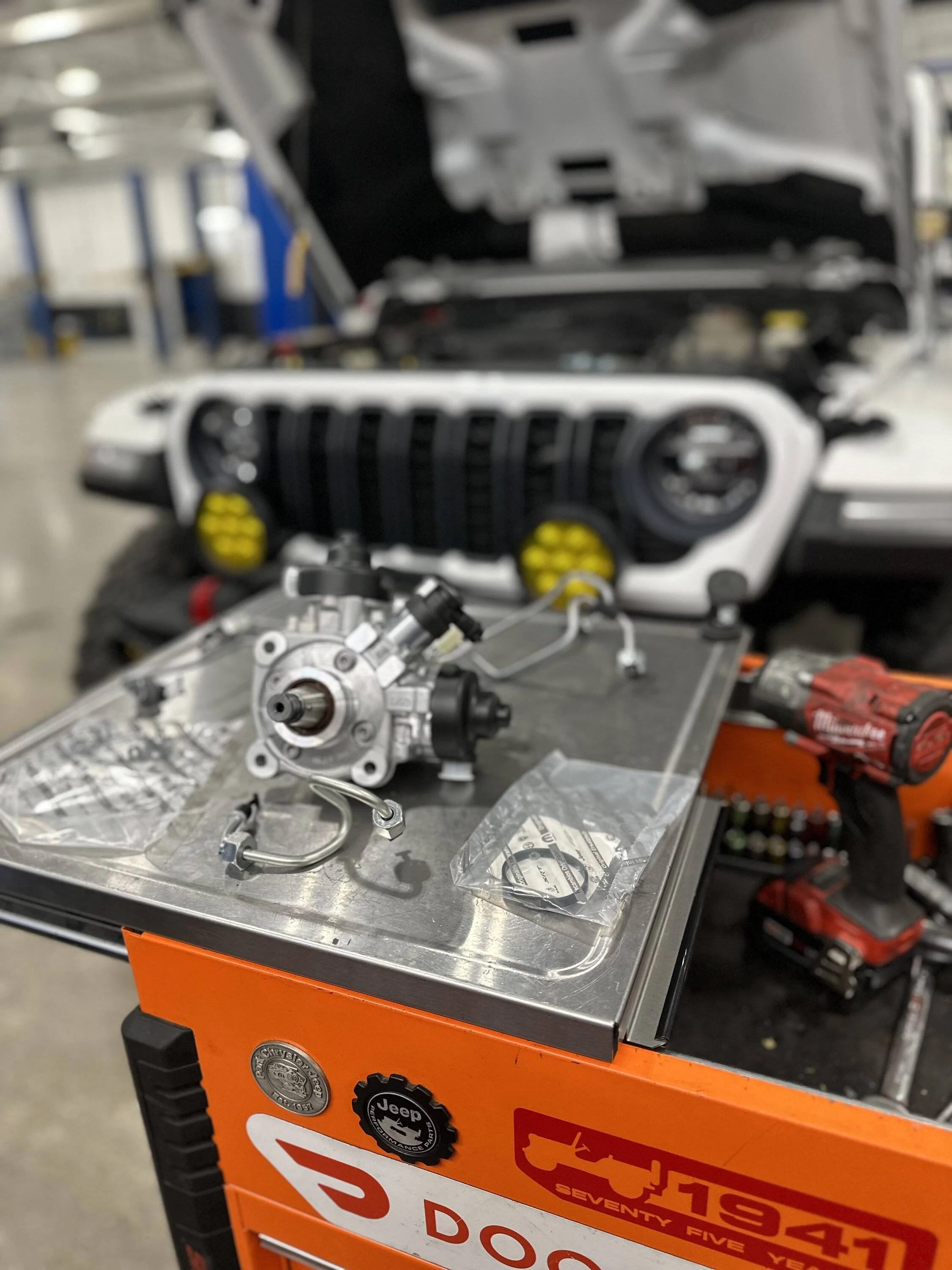

Doing mine as we speak I also started a new thread in the 3.0 ED section
Jeep Gladiator HPFP Replacement Recall - Post Fix Review IMG_7964
