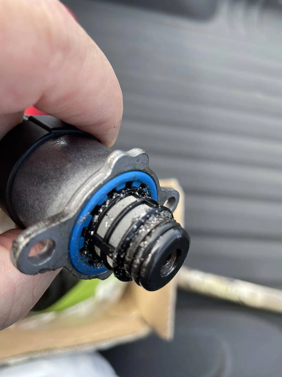

I’m just surprised- I thought that the point of the recall was to inspect for any signs of metal contamination in the fuel system to determine whether it’s just a pump or an entire fuel system that needs replacement. Not sure how that can effectively be done without pulling the fuel filter.
They can pull the solenoid on the pump and inspect the screen. If there is anything on it. The pump is failing.

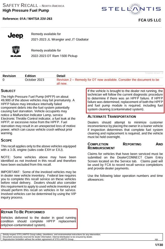

Per the recall instructions, if the vehicle is running and driving fine when it's brought in then only the fuel pump replacement procedure is done. If the vehicle cannot run and the cause is determined to be a shelled out pump, then the "contaminated" procedure is performed. Kinda crappy if you ask me as there may be debris in a system that hasn't completely failed, but that's direct from Stellantis. I wouldn't count on the dealership to even bother to pull the pump solenoid to inspect the screen of a running vehicle.
