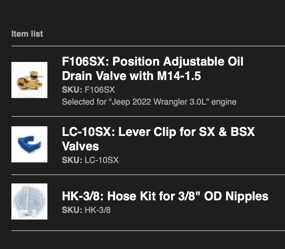

I was looking at the Fumoto, but I believe the Diesel (after 05/2020) uses a
M18-1.0 plug and Fumoto seems to only have the M14-1.5.

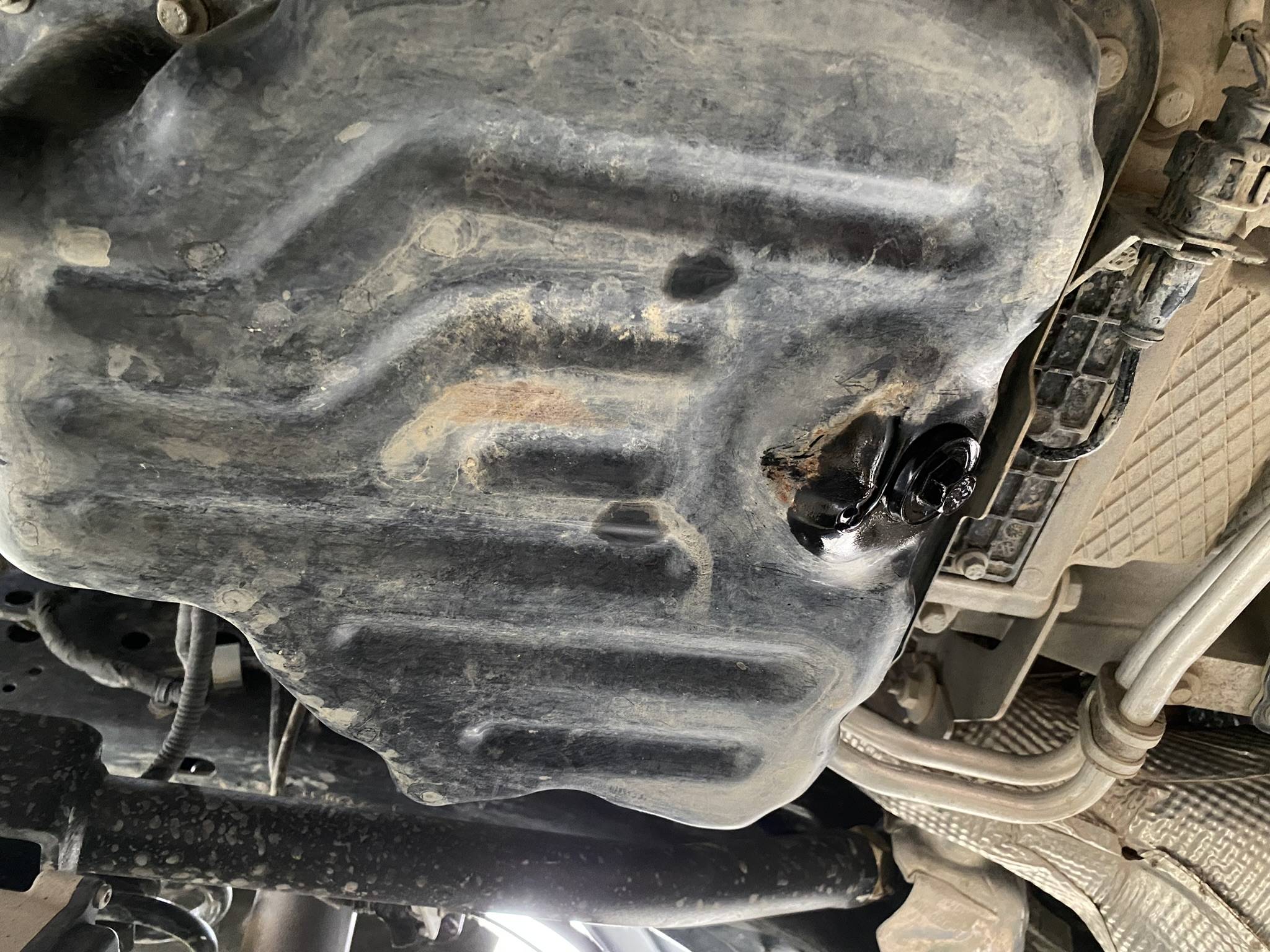

I have this for mine, and it works, though you could use another angle; I just wanted to avoid it hanging down since I step on rocks.
Jeep Gladiator Oil Drain Plug 1711670443746-ql
11,910
31,775
I haven't installed one because I'm scared that I might hit it off roading. Low hanging fruit to a rock.

Oh, I hear you :)
That's why I took the angled one, and it looks sideways so it doesn't hang lower than the pan.
Jeep Gladiator Oil Drain Plug 7556C006-EE17-4306-AF02-42CDCB5DF039_1_102_o
Like I said, I'm often on the rocks. That picture was taken before installing it. If a rock hits the oil pan at the right angle, it can pierce or slice it open, so I'm not too worried about the cap. I was lucky it only deformed the oil pan there. The real solution is a proper bash plate protecting the oil pan and, thus, the cap.

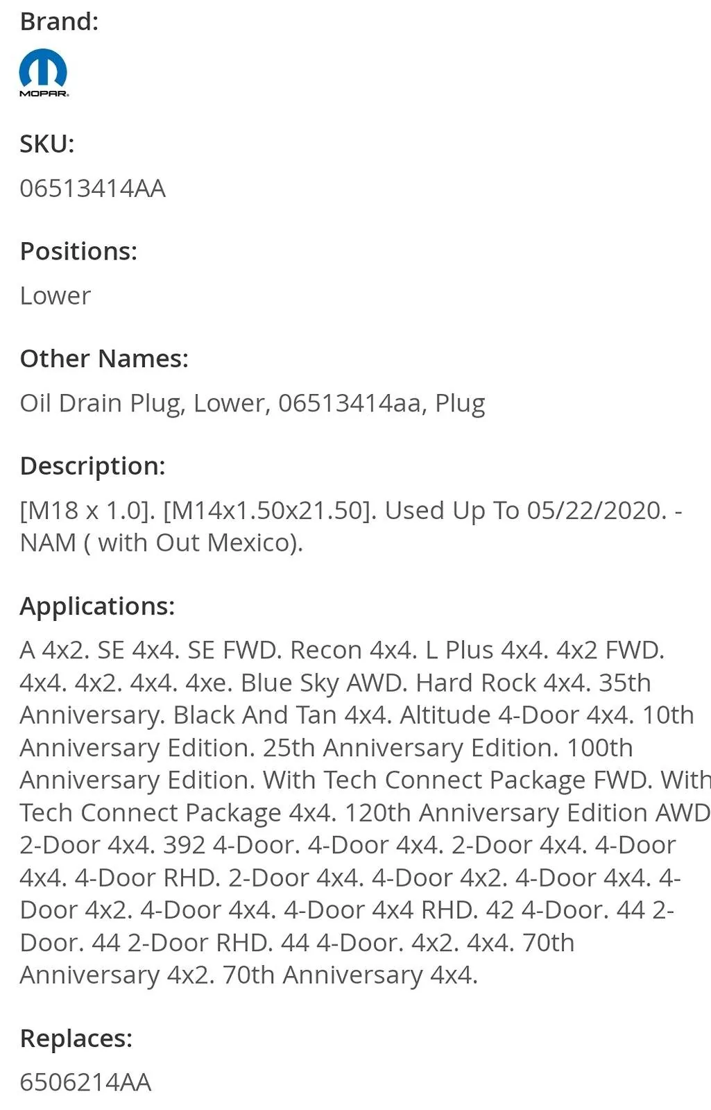

It does, somewhat, I'm still confused, but that's not your fault.
I'm sorry. I thought you figured it out afterward. It's on the picture itself (2022 Wrangler Diesel), under my profile on the side, and this is in the Diesel section of the forum ;).
Sorry I couldn't tell from the front angle, I'm not that good... I totally missed what sub forum it was in... maybe give me a pass, I'm a JT owner ?
I can check my OEM drain plug against my pitch tool if you want to confirm the 1.5 pitch.
Nah if you're sure your sure.
My research was for the JT, maybe that's the difference ?
BUT
The part# is 06513414AA and I thought it covers a range of models.
I had my local dealership measure the length of the one they pulled up and it was 1", leading us to believe it was a M18.

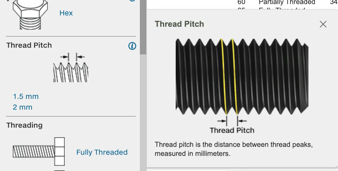

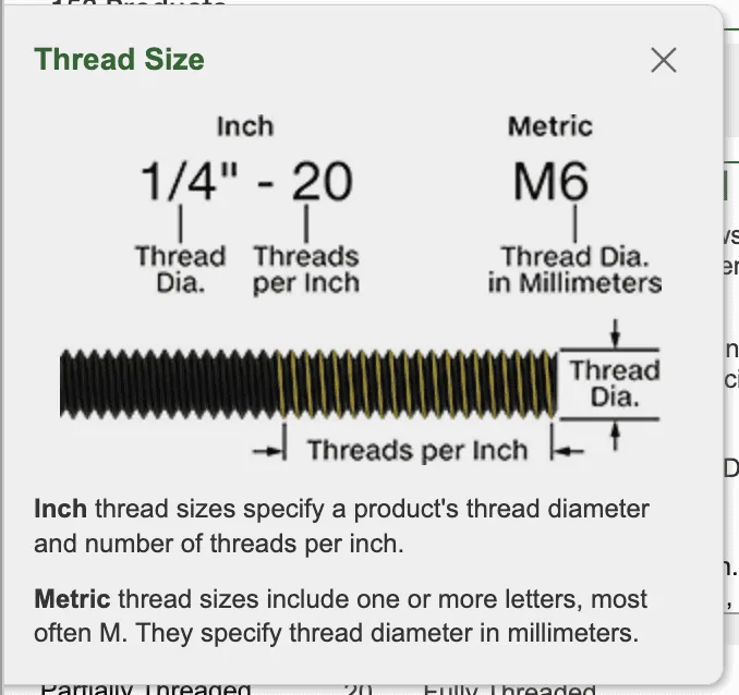

Ok, I think I understand where the confusion comes from:
Your dealer has mixed up the length of the bolt and its diameter. M4, M10, and M18 are all different gauges, like a #10 and a #4 SAE screw. In other words, it is a measure of the diameter of the thread. A full screw specification would have 3 numbers, diameter (gauge), pitch, and length. If you measured a 1" long screw, then it just tells that it's a 1" long screw, nothing about diameter or thread pitch.
e.g., M18x1.5x20 would be a M18 screw with a 1.5mm pitch that is 20mm long.
The pitch in metric screws is the distance between threads, while in SAE, it's how many threads are in one inch (much more confusing to me).
Play a bit on McMaster if you like; this can be helpful, in my opinion:

P.S: For that part on the Mopar website:
[M18 x 1.0]. [M14x1.50x21.50]. Used Up To 05/22/2020. -NAM ( with Out Mexico).
I agree that it is confusing and does not tell you which is what. I believe that they meant to say is
ScrewDate
M18 x 1.0 x ??Up to 05/22/2020
M14x1.50x21.50Starting 05/23/2020

If you look at the attachment from Mopar Parts, it only shows M18-1.0 , so I'm unsure of the 3rd measurement.
I agree, the dealership and I both mis-measured.
I'm thinking you are correct, the more I inquire, seems M14-1.5 is what the newer models are using.
If this is indeed the case (which I hope it is) this opens up more opportunities.
Thanks a bunch for your time and effort.
