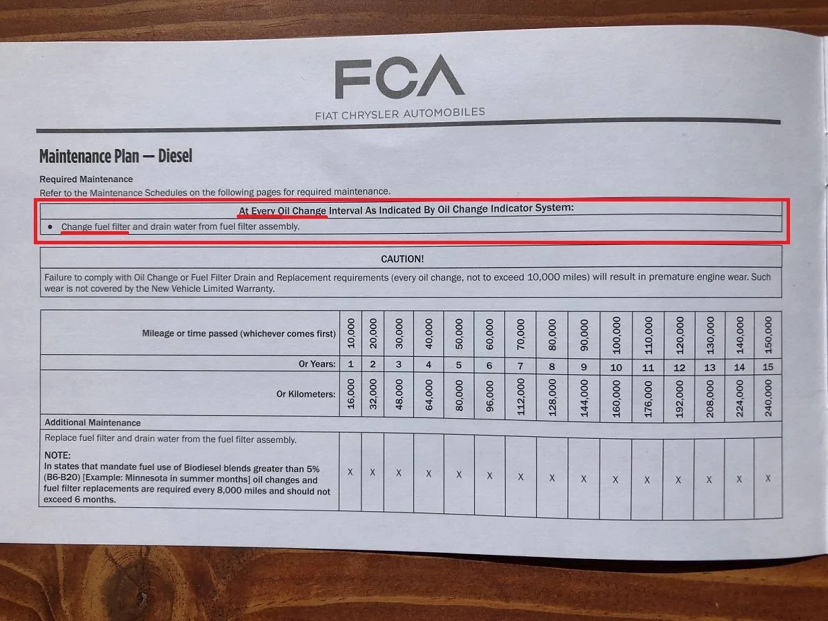

New member with new to me previously owned JT Diesel. Purchased a 2021 3.0 with 35k miles last week. Recall was completed in January at Jeep dealer I purchased JT from. No pump failure so just the pump replacement. There is no stickers from campaign and no owners manual addendum. In talking with diesel tech and service mgr, they weren’t sure why labels were not installed or addendum put in glove box. Does anyone have a photo of the owners manual addendum. I see images of stickers but haven’t seen anything on the addendum and exactly what it says. The dealer stated that the addendum on changing fuel filter every oil change is only if using biodiesel. Otherwise they state every 20k miles. This dealership performed all maintenance on this vehicle since new.

Never mind. Just found a photo on Wrangler forum. Looks like if using B6-B20 biodiesel, filter should be replaced every oil change.
The fuel filter replacement interval has changed overall, not just for when using B6-B20. Previously it was required every second oil change, not to exceed 20k miles, whereas now it's at every oil change not to exceed 1yr/10k miles. It's also very important to note that the fuel filter and oil change criteria for B6-B20 use is every 6mo/8k miles, so the time change interval drives a minimum of two changes per year regardless of the amount of use.
Jeep Gladiator Ecodiesel Recall 01A HPFP Parts are Available IMG_2280v2
Jeep Gladiator Ecodiesel Recall 01A HPFP Parts are Available IMG_2281
Thank you for clarifying. The addendum I saw did not look like the one you shared.
