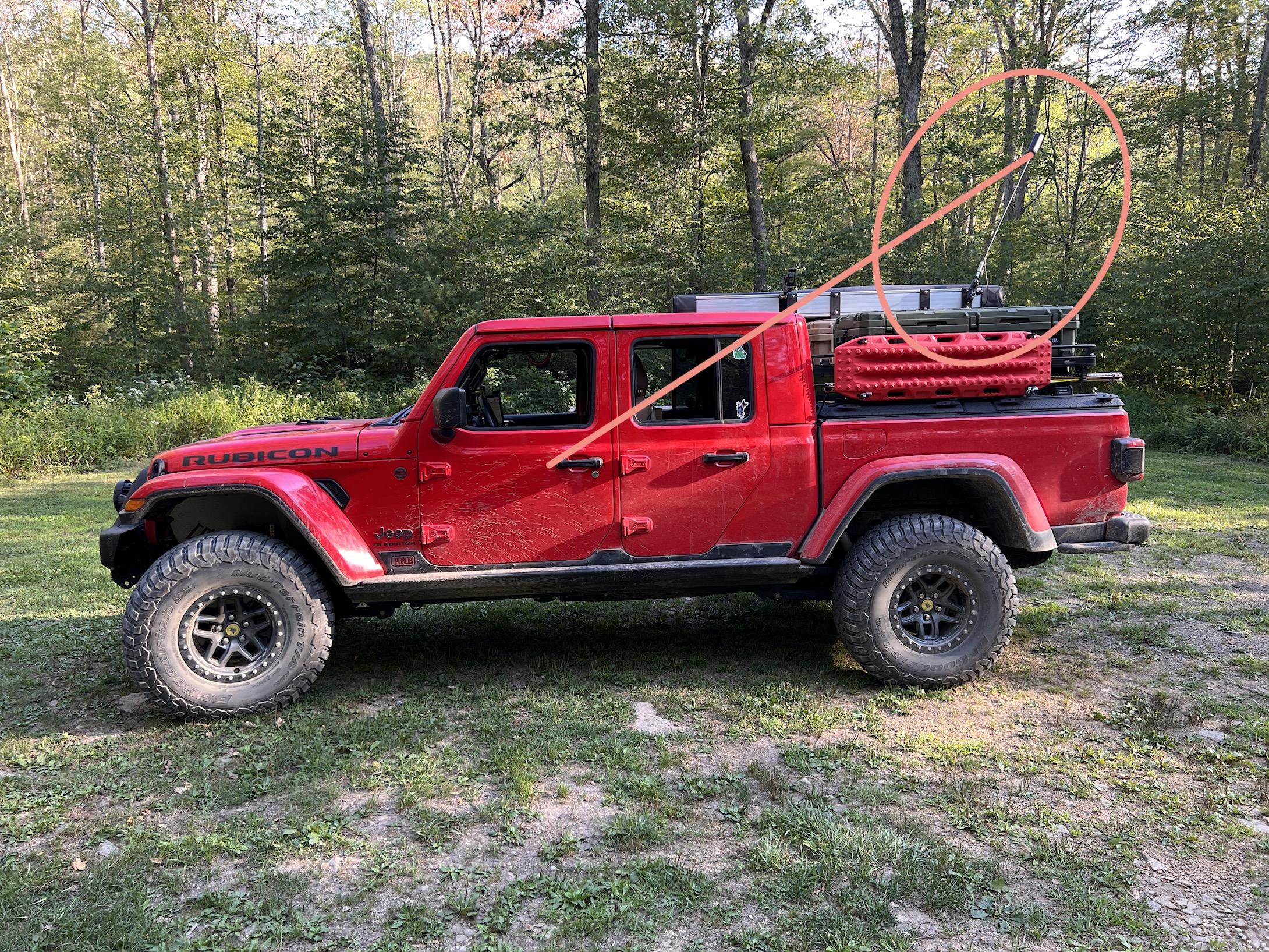

I tried the Weboost and so far it’s been a total game changer. There’s a lot of confusion about these and then peoples attempts to correct misconceptions and manage expectations are also sometimes wrong. It won’t create signals, that’s true, but it will pick up signals that don’t register on a phone’s built in antenna. I was consistently able to go from “no service” to 1 or 2 bars turning it on. I was also able to pick up higher speed networks like 5g or LTE when the phone could only get Edge. Along the interstates in Virginia I stay typically stay at 4-5 bars. So yes, you can get a signal where you would not otherwise be able to detect one with a handheld device.
In my experience in the backcountry, even having 2 bars usually still means unusable data regardless of network. I’m used to having 1 or 2 bars that still won’t work. This is where the Weboost really shines. With it you get much better speeds so the data connection worked as normal even with 1 or 2 bars. Of course there were times when I still couldn’t pick up a signal but those times were surprisingly rare all throughout central Pennsylvania on the MABDR.
A big part of the issue I think people have with the WeBoost is antenna placement. This is where mine is below. The higher the better and the two antennas are as far apart as the included cables will allow.
The aerial antenna is circled and the straight line represents the approximate distance between the it and the inner antenna mounted to my center console. There’s a quick clamp up near the front of the awning where I can secure the antenna in a down position. It still works well in that position.

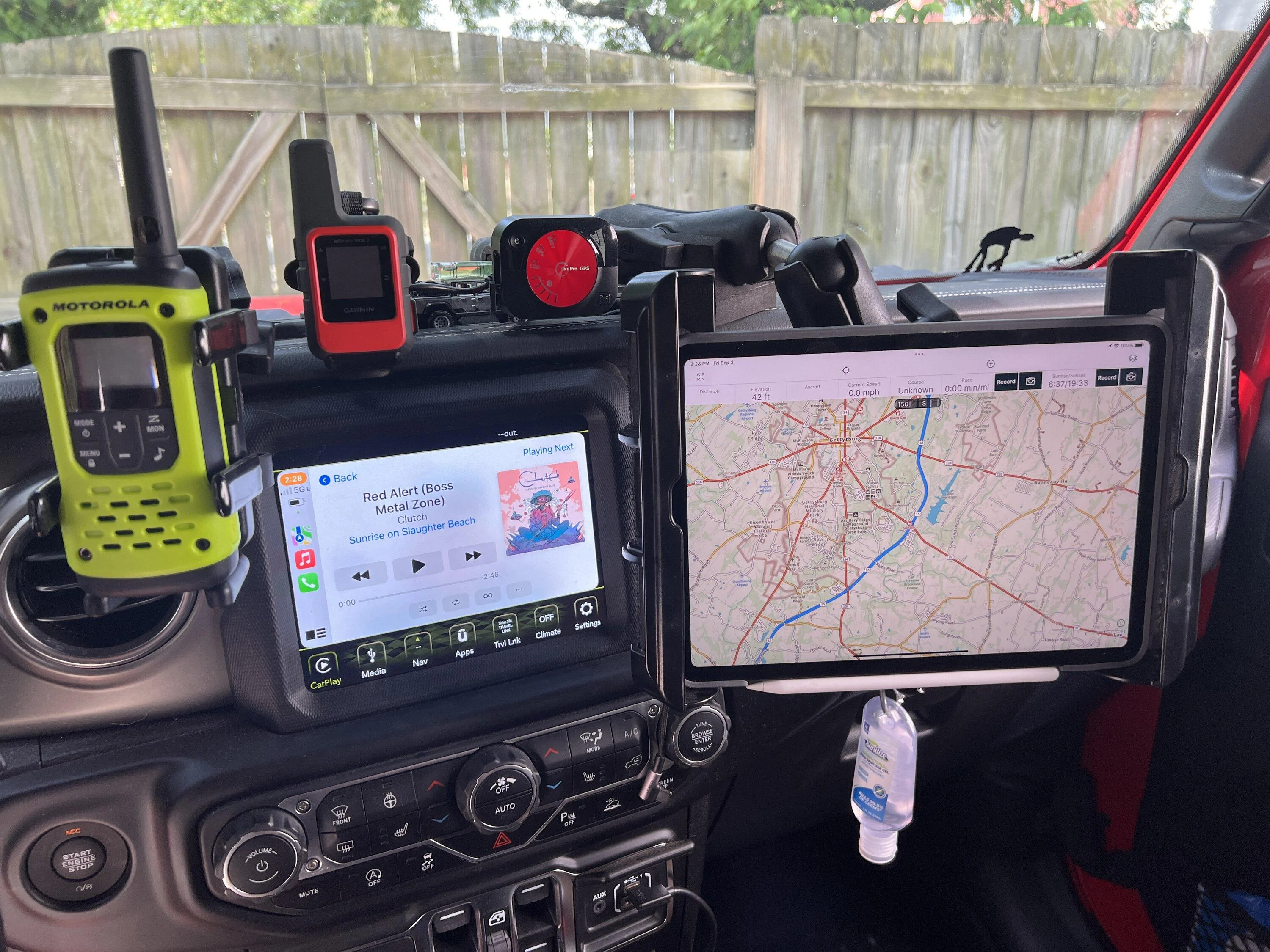

I use a SPOT messenger to stay in touch with the wife when away from cell service. Have used it camping, off roading, ATV trips, Snow mobile, etc etc all over the country in all sorts of weather/environments and its been great. Have been on the fence about getting a WeBoost, but after talking to a couple folks in person with them, both said "Honestly I wish I spent the money else where, it doesnt help that much" havent got one yet. Would love to hear some more opinions on it myself.
Heres how I have my JT setup currently:

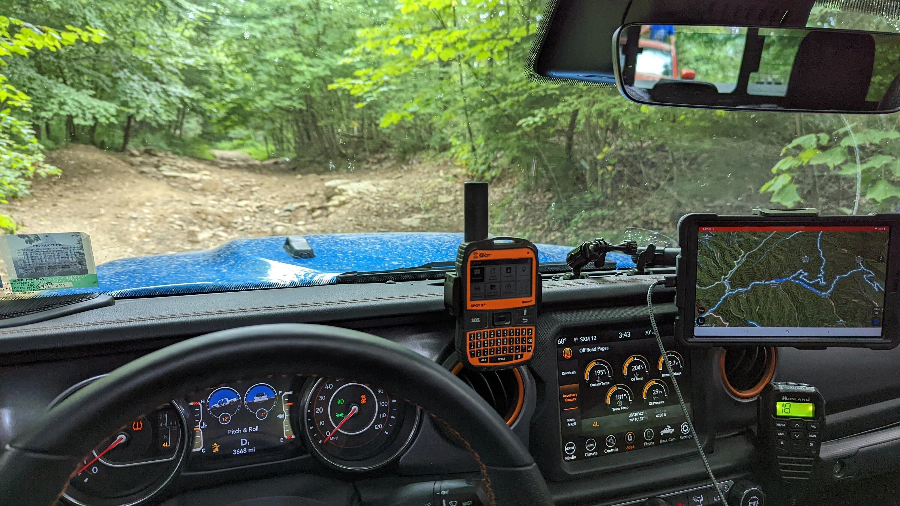

Antenna position is critical. Interior antenna position is critical. I also will have to toggle the phone in and out of airplane mode when I turn the booster on. Consistently, I gain another 1 to 2 bars or go from no service to 1 or 2 bars. Data goes from unusable to usable with it. This was my experience in Bald Eagle State Park and elsewhere in Pennsylvania with AT&T but other peoples experience will be different based on a multitude of factors.
If all I wanted to do is send someone a message I wouldn’t get one. I’d only have a Spot or InReach. But I want my cell service to work so that I can work remotely from almost anywhere, have navigation search and route finding work, have music streaming, etc. For that, the Weboost fit the bill. I will probably still get a StarLink as well.

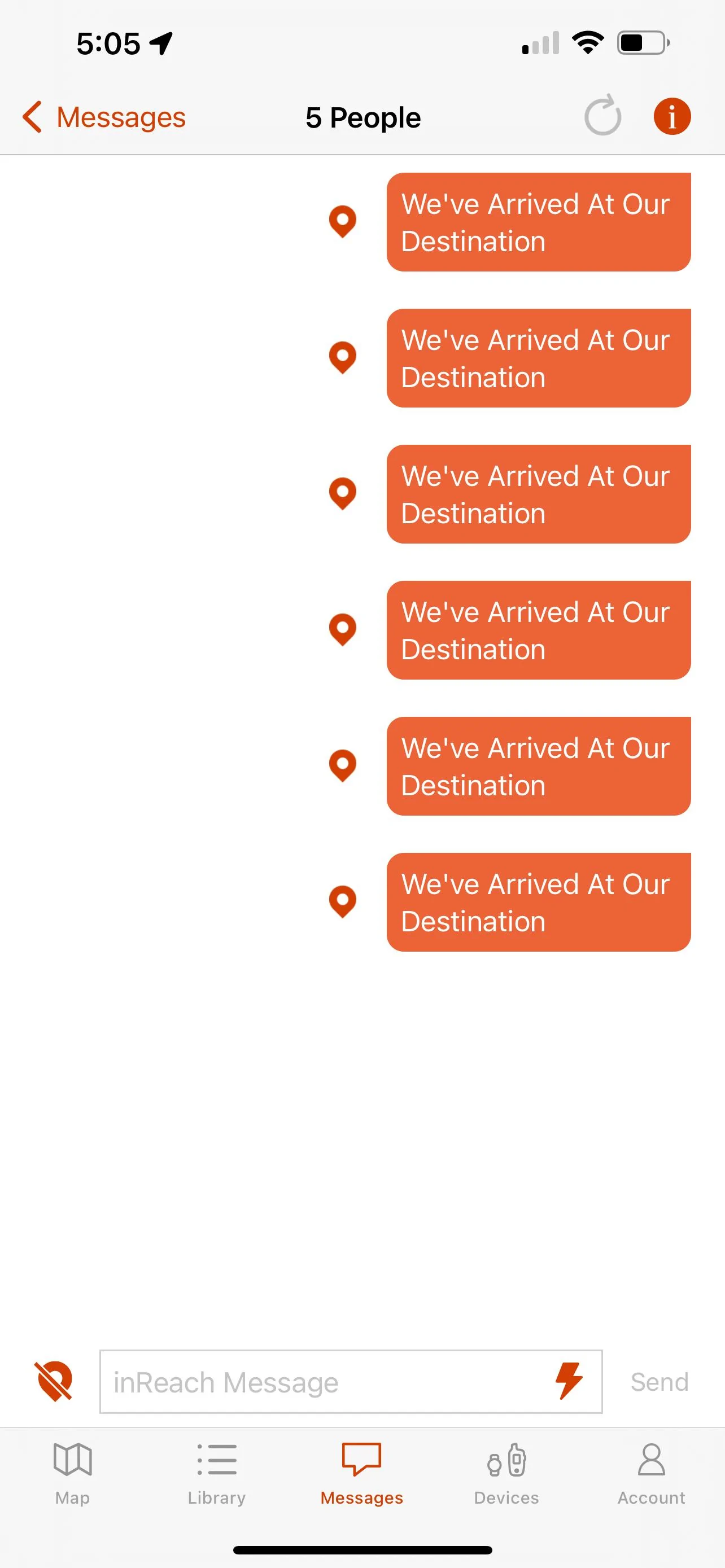

Whenever I tried to send a message this last week (the first time I used it in the field) it would tell me that it couldn’t detect any satellite and give me the option to send anyway or wait. I tried it both ways. Usually I’d find clear sky and place on the ground or a rock or something and leave it to go do other things like set up camp.
Some time later (maybe a day later) I’d see that someone would have replied. I didn’t see any indication of when my message was sent only that obviously it eventually was because someone replied. It was never clear on the device or phone app which message of mine people were responding to so I’m not sure which messages actually made it out.
I don’t really care if people reply. What I was hoping for was some kind of notification on the device that my message out was successfully sent to their system. I never saw that and given that every time I tried to use it I got the same error that it couldn’t find a satellite, it sort of shook my confidence in its reliability.
I’m going to continue to play with it. I noticed when I got it and registered that it needed an update. That update took an hour. I found that strange. Setting up canned messages was flaky and it sent multiple messages while setting those up. The web app and phone app are flaky and glitchy.

Yeah, this is super janky. I went out in my backyard where I have clear view of the sky. Nav is working fine. . I tried to send a message and it gives me a warning that the signal is weak. I send anyway. On the phone app it shows 6 messages were sent to the 5 recipients of my canned message. 1 person responded that they received 2 back to back messages.
Jeep Gladiator Cell booster vs personal locator beacon? 19144429-4E38-49B3-A747-6A18BDAAAD49
Edit:
So all of those showed 4:59 as the time when you click into them. I just sent another one and now they show different dates like this is a message thread.
The app appears to separate each outgoing message of the same type (preset 1,2, or 3) accept that it doesn’t always. Then responses from people are in their own thread. That last one makes sense.
I think the software is just super buggy.

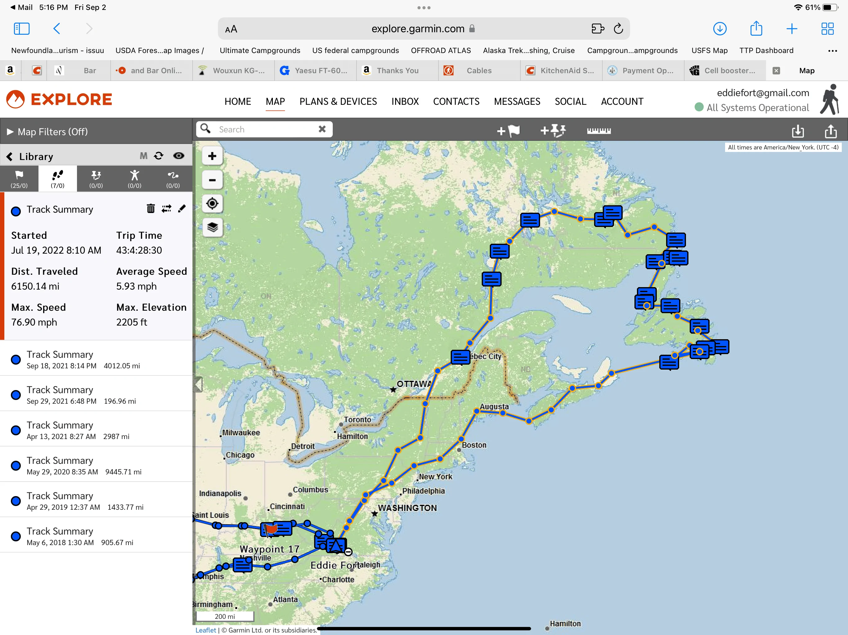

I agree. I think the upshot is that people should get both a sat communicator and some other device for general comms/data, despite my (seemingly unusual) issues with the InReach and other peoples complaints about cell boosters. A more interesting comparison is cell boosters vs StarLink. They’re both about $500 for the equipment and both have their own pros and cons.
Agree. Here is the track of our 6 week trip to the northern Canadian Maritimes. Our DIL who works with sat intel likes the date we are able to send to her while we are out of cell range..
Edit:
If its under warranty I'd just send it back to Garmin. That definitely isn't how mine behaves.
