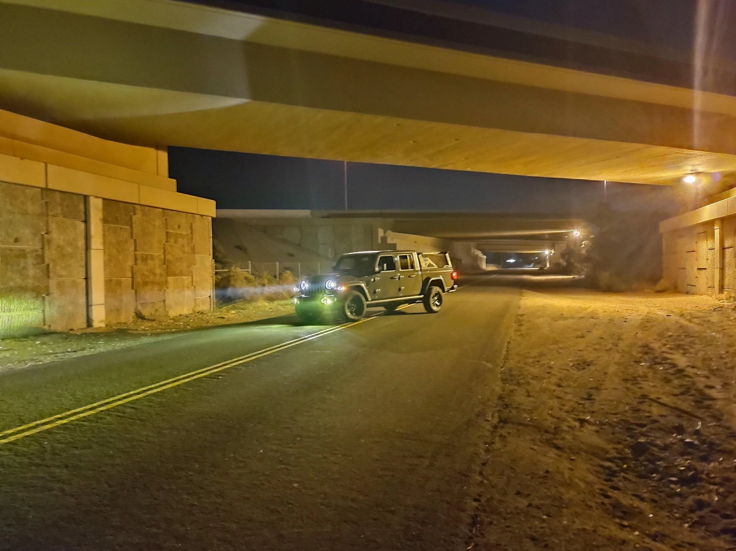

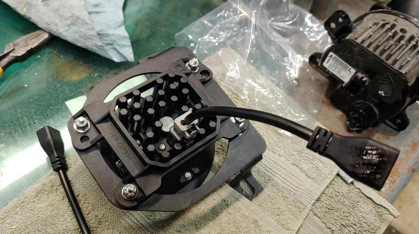

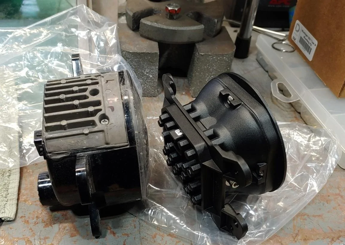

These things make a HUGE difference. Very difficult to photograph or video the true difference but I would say probably 3-4 times brighter than my stock halogens. One downside is I had to change the DRL’s to just clear halogen bulbs from amber bc 3 different color lights up front were killing me. Aside from that these are worth it and super simple to install. All in it probably took me about 40 mins and I took my time. 2 days in and very happy, hope they hold up well to the weather.

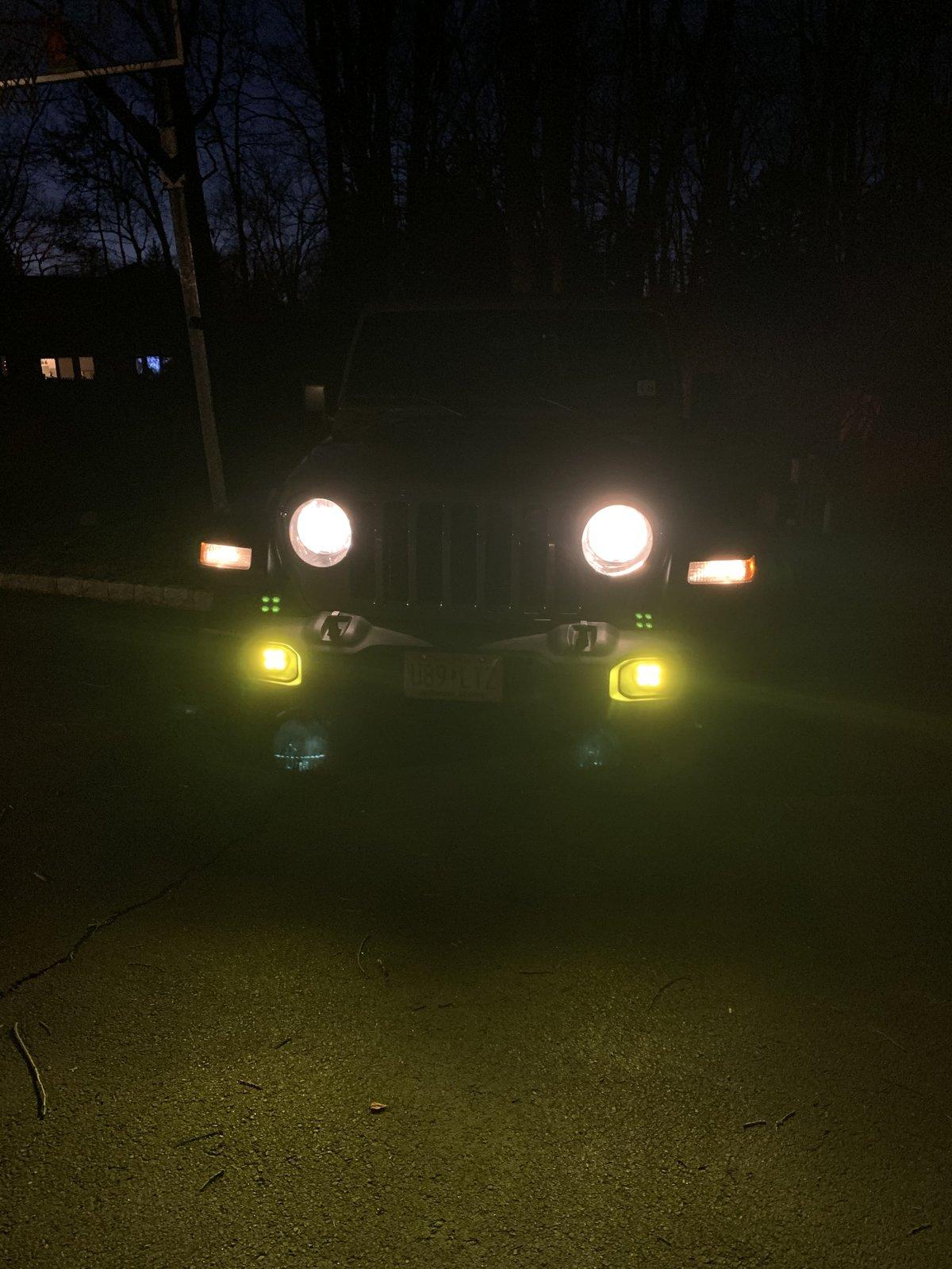

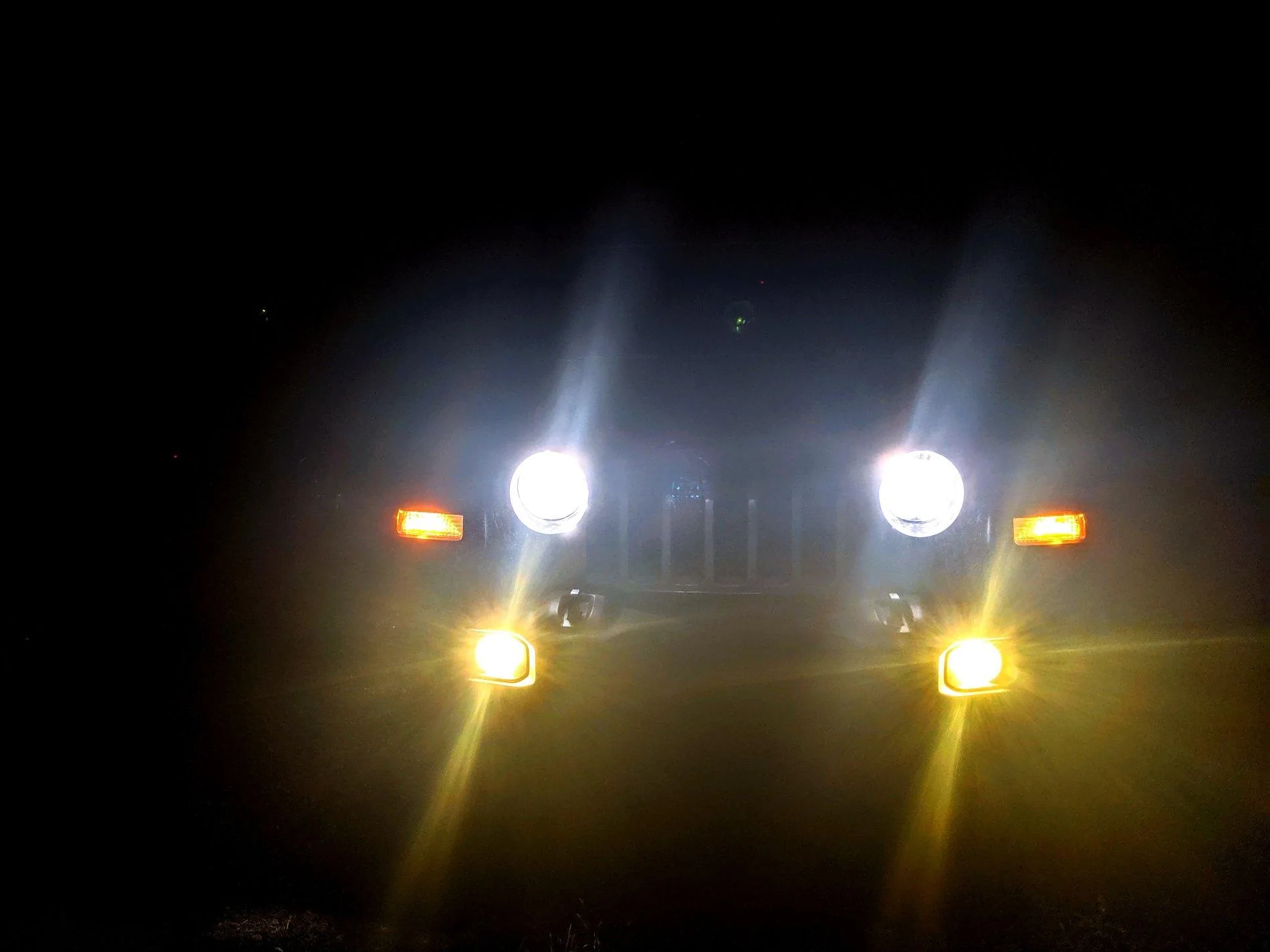

I'm trying these out, there hasn't been any real bad weather yet but they worked great a couple of weeks ago when the snow was blowing and high beams weren't cutting it (and there was too much traffic to leave highs on anyway)
https://www.diodedynamics.com/ss3-led-fog-light-kit-for-2020-2021-jeep-gladiator.html
Their description is selective yellow:
White or Yellow. All Stage Series LED pods are available in a cool white or selective yellow color. The white is a 6000K color temperature, which is a true cool white output, and matches most factory LED lighting. The selective yellow is a 3000K color temperature, great for high contrast in poor weather or a distinctive look on the road.

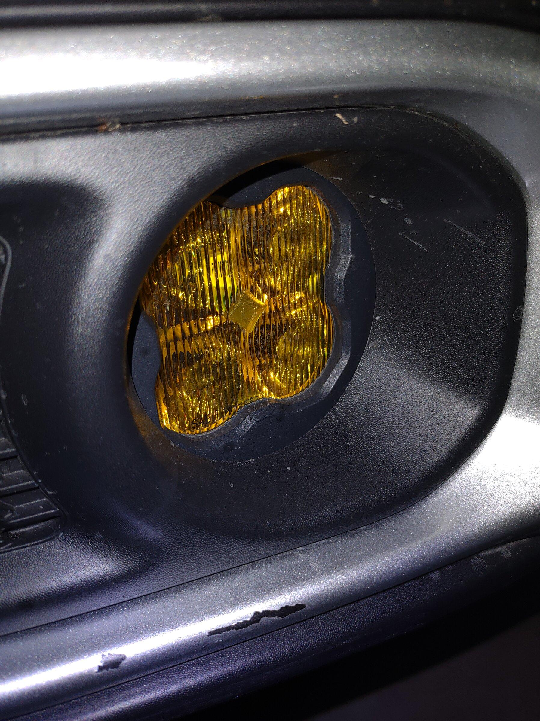

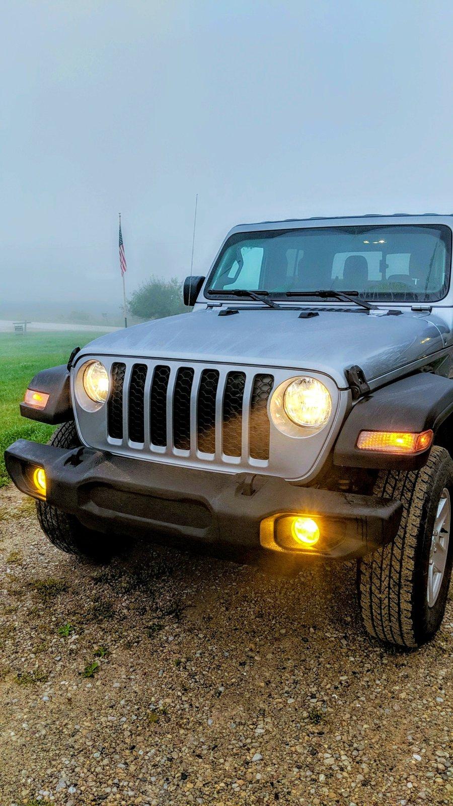

Love my Diode Dynamics Sport SS3 in amber. Plug and play. Jist remember to get the right mounting kit.

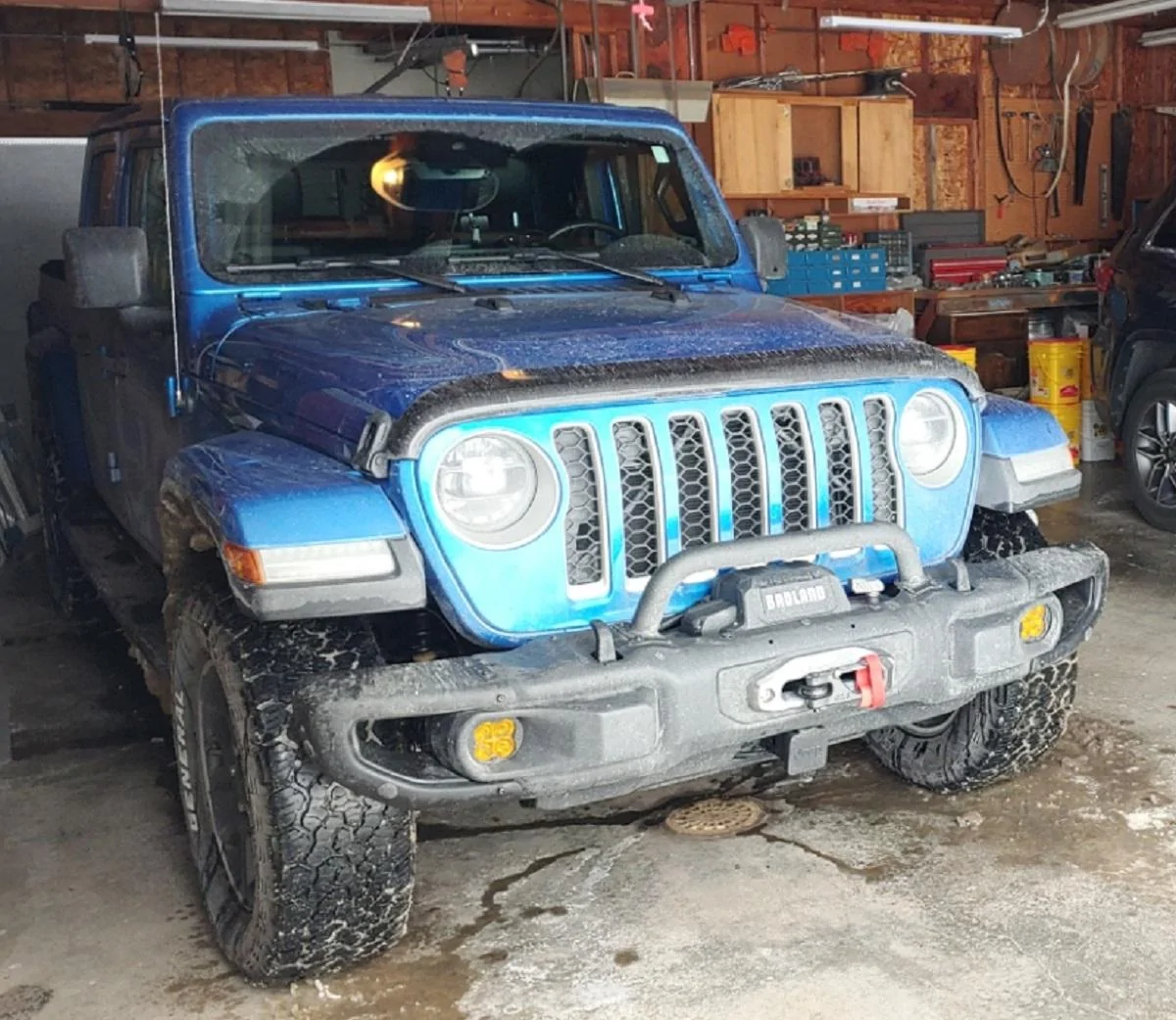

I had to get the kit for the Overland plastic bumper even though I have a steel bumper because my bumper came with adapter brackets, saving me 50 bucks. I didn't have to get the mounting kit for steel bumper.

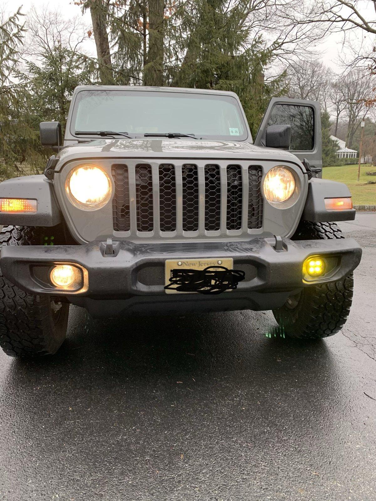

I also have the sport in selective yellow. Well-built lights.
