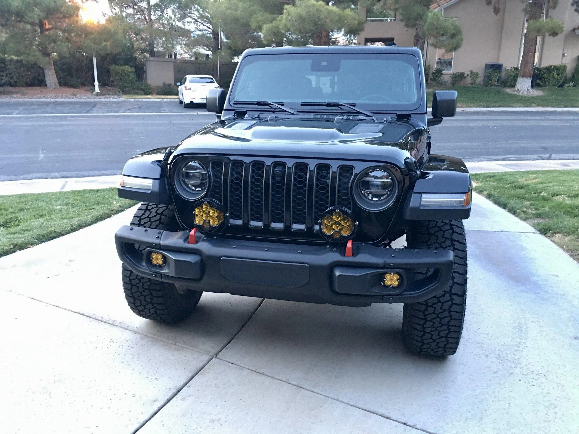

Baja Designs amber Squadron R - plug and play. They work extremely well for me. Hard to tell from my pics, but the BDs give me a much wider view and do not reflect back or glare at me in snow or fog, IME.
Pictures show lights installed; view with headlights; view with headlights and BD Squadrons.
I like those a lot! Are those the SAE compliant version or just regular Squadron - Rs?
They're fantastic...promise - Jeep JL, Sport/Sport-S, Squadron-R SAE, Fog Pocket Kits (Wide Cornering). Contact Paul McGrath at Baja Designs for questions. He is very easy to work with and knows his stuff.

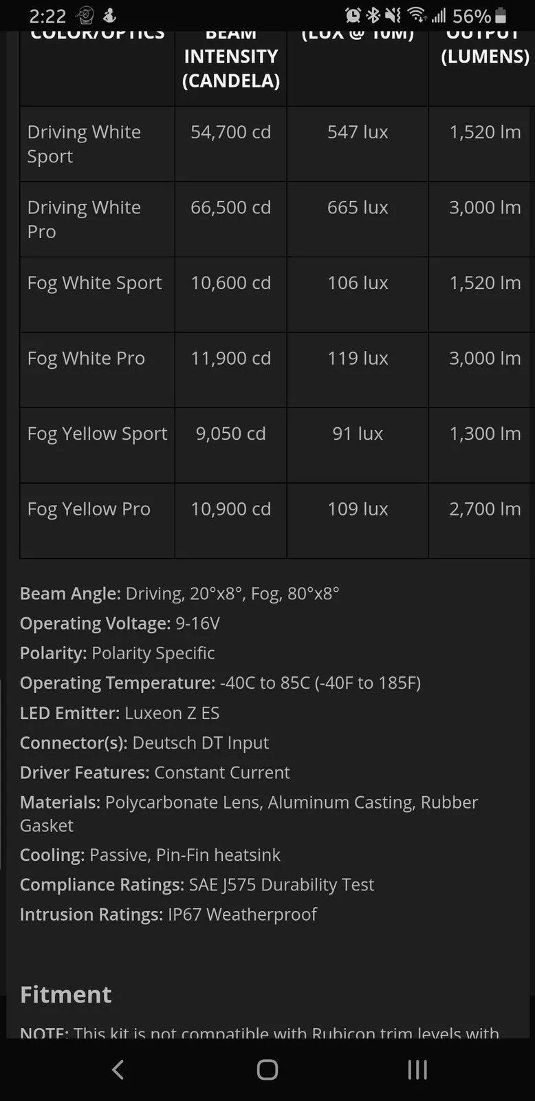

Doesn't look like a bad get. Especially at $200 with wiring, brackets, and all. Interesting that they don't offer anything for the steel bumper variant. Also, "extensively tested for moisture intrusion." Does this mean waterproof or...?
Jeep Gladiator Changing Fog lights to amber? Screenshot_20191210-022247_Samsung Internet
IP67
