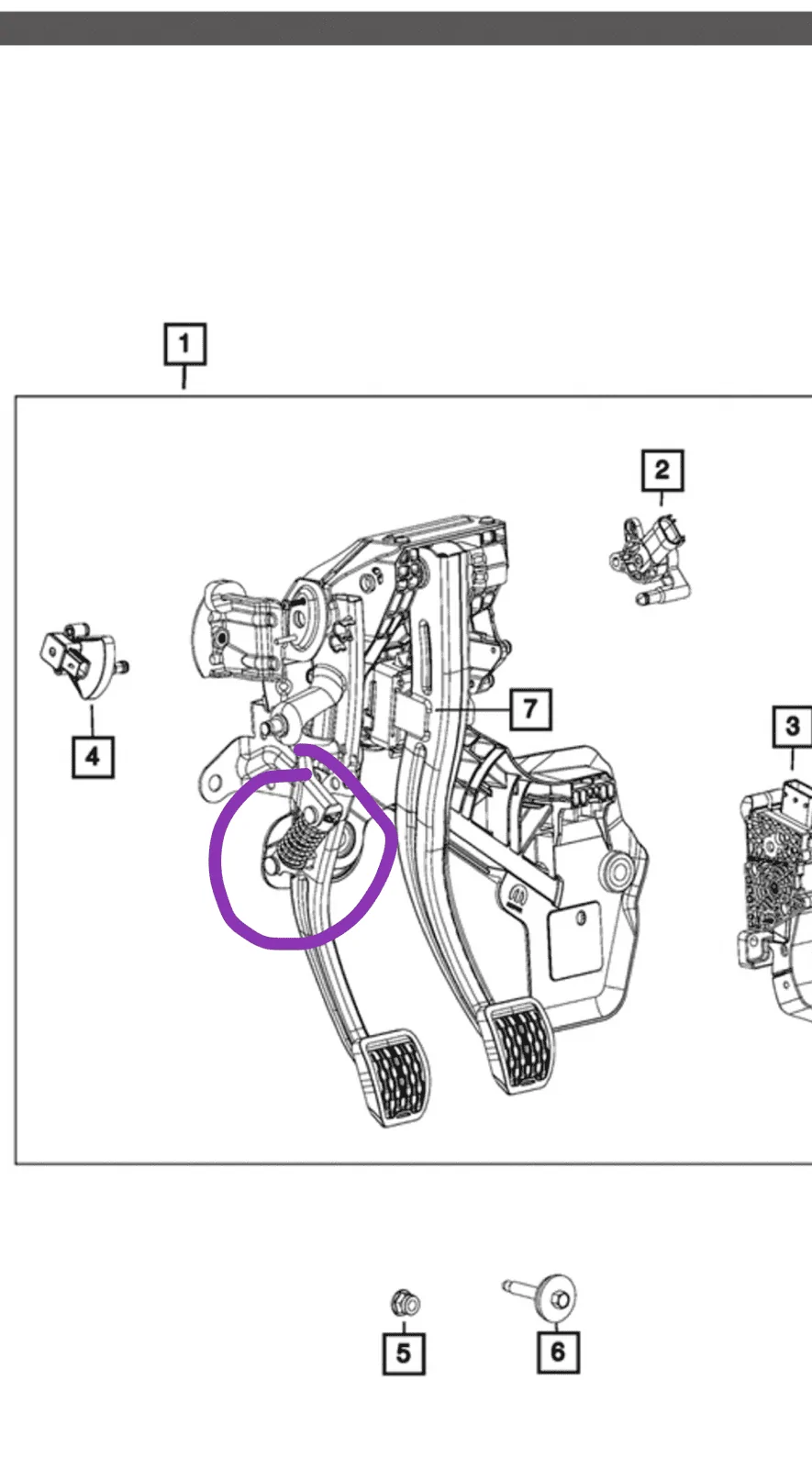

So couple things to add from me.
1.) I haven't heard my sound for months now. I did remove the clutch return spring on the pedal, Put foam padding on the top and bottom , never heard it again. Im not saying that was the issue, because seems weird that a spring that is applying pressure constantly would be able to rattle lightly, but harmonics are a fun side of physics so, might be worth looking into for y'all since the sound always went away for me barely touching the pedal, but not actually touching the master cylinder rod, oh, that was also not fully clipped in for me, I think I already mentioned that though. Any way, might be worth a check for y'all
2.) The whole Dealer story with the cams, I think his issues caused the rattle, not was the rattle, if y'all catch my drift. Also the cams snap from over torque, not under, seen more then a handful of tech think the torque wrench is not needed on 3.6's, they learn very quick. Also, the cam was worn, and they didn't replace it, or get Chrysler to pay for the LOF?? Yeah, go ahead and make another or lower your review and never go back. That's just assinine.
Has the clutch pedal noise stayed away? How much difficulty am I into to access clutch pedal return spring and modify as you indicate(any tips)? Little to no mechanical know how here/limited tools. Is this it?(pic) THX!
2022 Mojave 51000kms and this has been happening since 30k. 2nd, 3rd gear only, 3000k-4000k or so with brisk acceleration/load. Noise gone if i touch clutch pedal at all, every time.
Easy to change that spring - push pedal to the floor,hold it down with a block wedged to the brake pedal. Reach in with your right hand and pop it out. It will have some grease on it.
So yes, but also no. I never heard the sound after I did the stated repair (no tools needed, very easy), but I have since change out the spring to a lighter one (honestly not really even worth a recommendation) and I do hear it on occasion now. Not if a coincidence or related. Eitther way, I think this continues to be an unsolved mystery. Only last real guess I have is throwout bearing noise, but the only way to verify that is by installing a hydraulic one.
