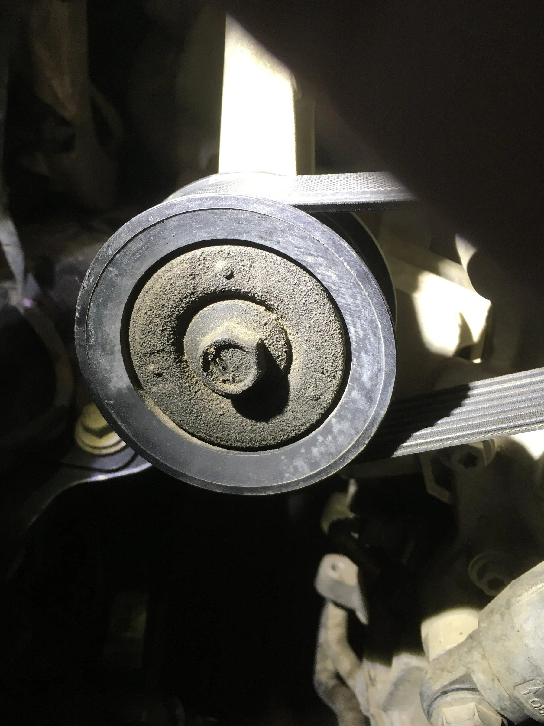

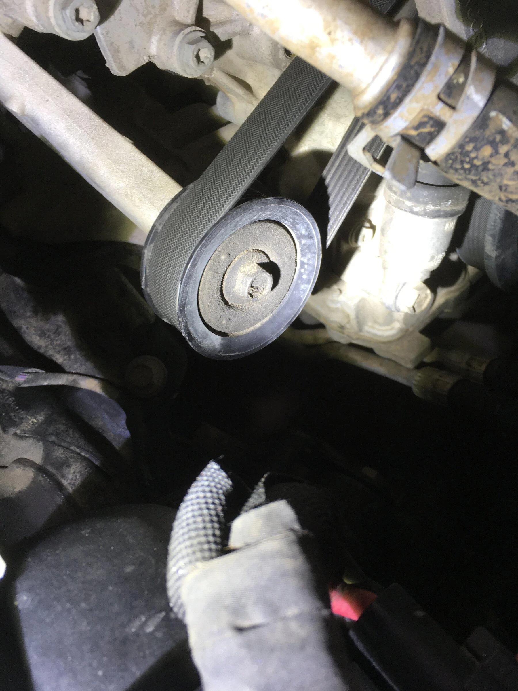

Water Pump, ?
local dealer ordered one and waiting on a Parts ETA. I can drive it unless it starts leaking coolant or overheating.
Mines been doing this exact same noise they said they replaced the water pump and belt tensioner pulley. Still making the noise and sounds like the same location. . Did you stop the chirps with water pump ??? 10 months of it And filed lemon laws and they fought me and won yet I still have the chirp daily comes and goes but shows back up every day in idle some times faint when I’m driving I can still hear it Friggin jeep manufacturer. Sucks. . They just never fix the dam thing I’m so tired of bringing it in and I don’t think they really replaced anything I think they just say they did and keep the new parts tell me what you found

They claim they put belt tensioner pulley and water pump but still chirps
