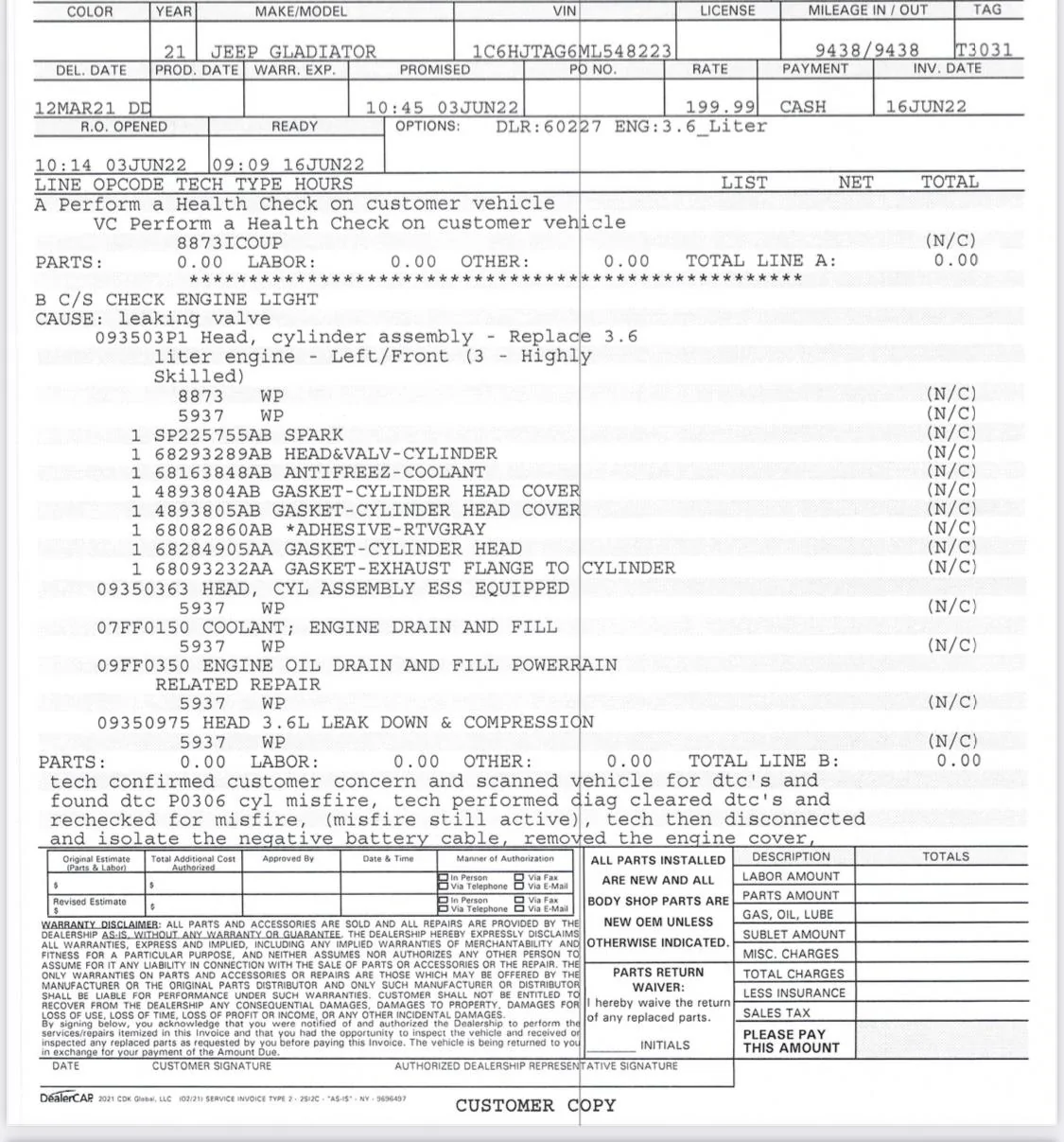

I started experiencing the “rough idle” ONLY AFTER the dealer repaired a misfiring cylinder. I’m attaching images of the 3 page service receipt. Jeep dealer’s first available appointment is in a month (which I scheduled for this rough idle). #jeepcares @JeepCares
To keep track, before the misfiring cylinders, I found large metal chunks in my rear differential and posted pictures of it. I can’t say that I’m thrilled.
page 1, service receipt

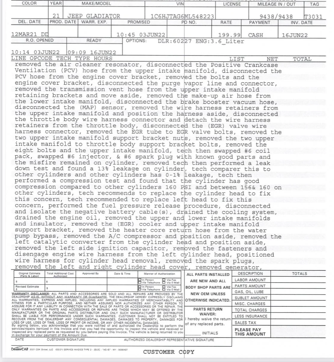

page 2, service receipt

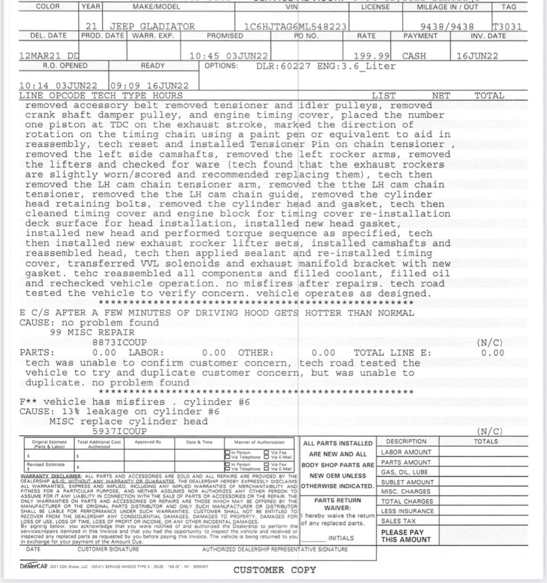

page 3, service receipt
Jeep Gladiator Shuddering at idle 1E1918BF-C9F5-4FF2-88AD-822C3C3DEEE3
The thing about engine issues like "rough idle" is that it can be caused by any one of a number of things, maybe even more than one. So a solution for one may not be the same as yours.
It may be helpful to know how another was fixed, but I'd not count on it being the same issue.
Have you thought about seeing a dealer about it since it's under warranty?
