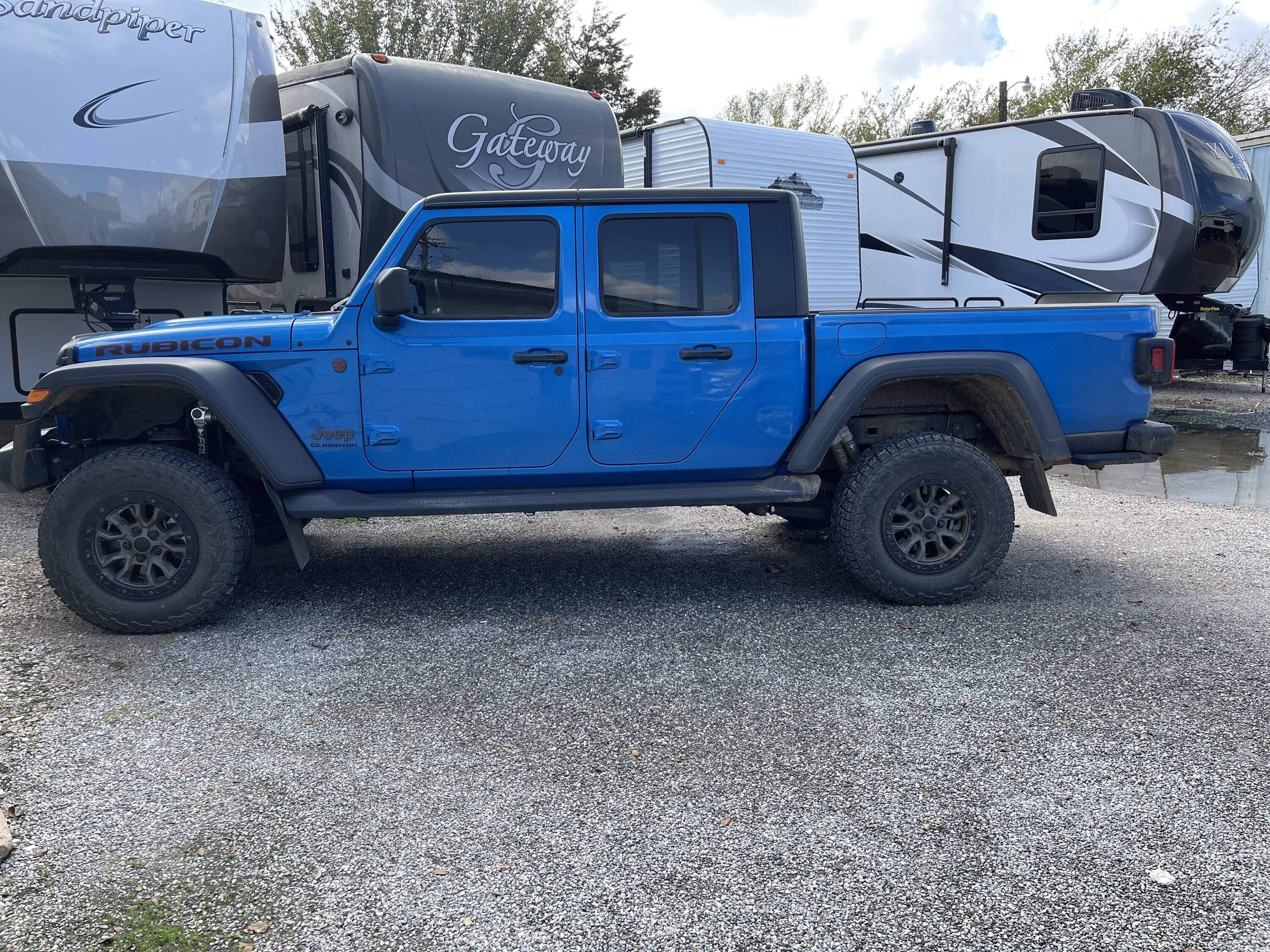

I will ask them. All of a sudden, it got me thinking should I go with 2.5 inch or 1.5? (Since they are the same price) Lol. I have 315 tires now. Would it look too small with 2.5 inch lift?
That another personal choice. I’ll attach a picture of mine with the 2.5” and the stock Wildpeak 285/70r17s. My tires measure about 32.5 and look off now. They only have a little over 20k on them now so I’ll probably wait another year before moving up

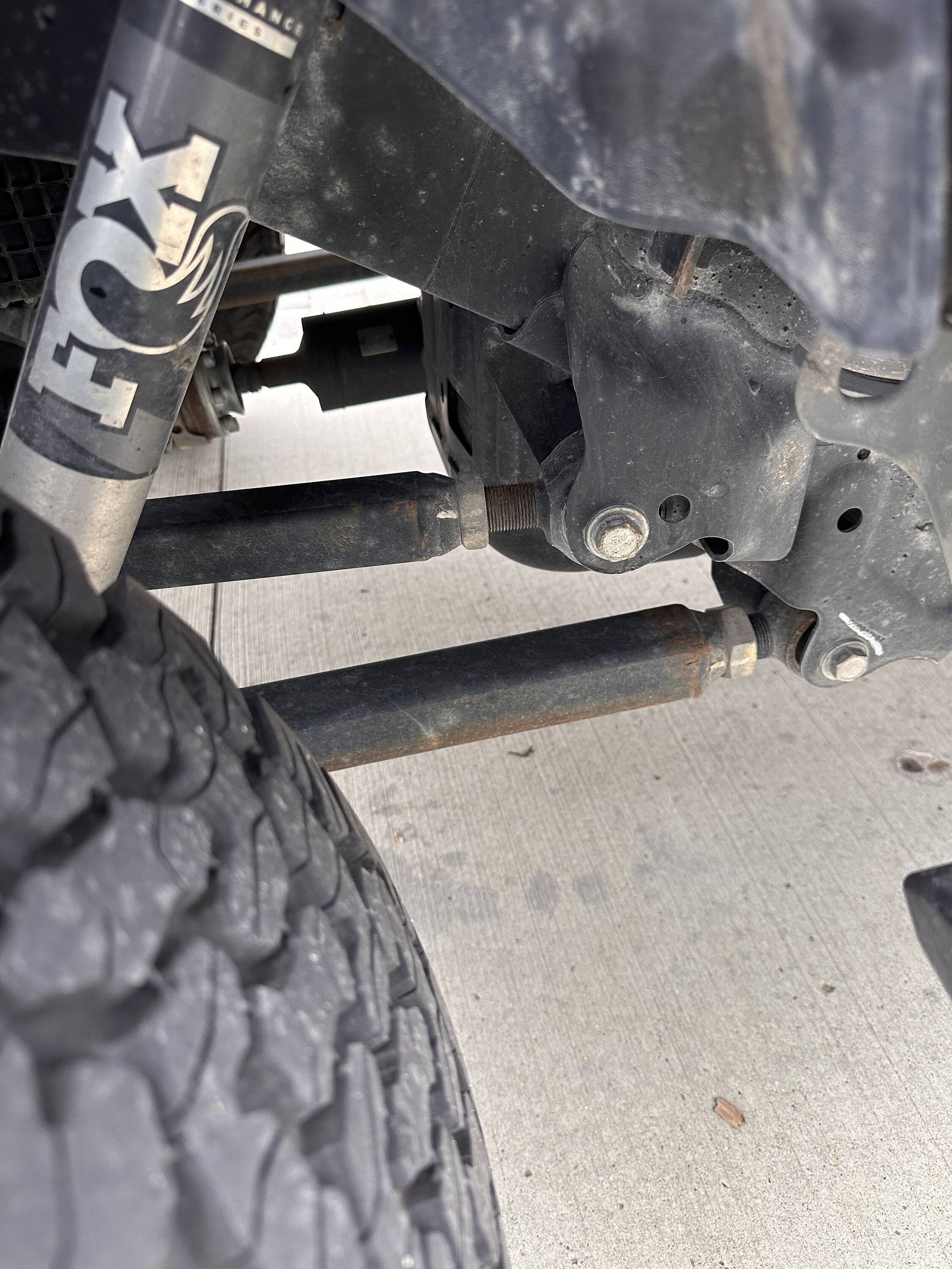

Damn. Good to know. Thank you. I live in Boston area and I am planning to do that. I wonder If I park my trunk indoor most of time, of course I will still be driving on road. Do you think I still need a undercoating? The reason why I am asking is becasue I will move to California next year, this is going to be my last winter here in MA.
honestly, I would just do it regardless. It would be easier to do it when they’re off the vehicle. I had to clean them then climb under the truck to spray them. It was a pain in the ass. But they look a 1,000 times better. Here’s the before. I don’t have a pic of the after but I’ll snap one later. The rust might not bother some, but I’m looking to trade the truck in and the rusty control arms makes it look like a beater
