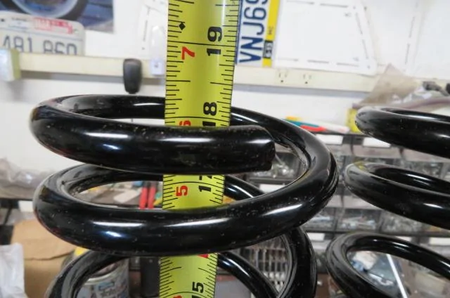

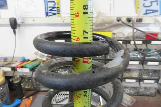

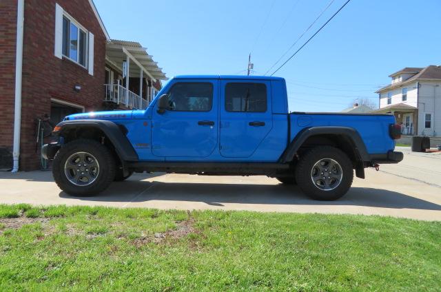

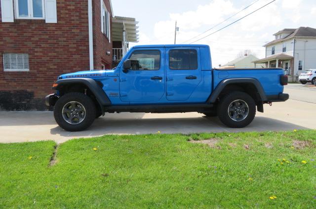

Clayton wanted me to take measurements at the front and rear of the rock rail. It was 16" in the front and 18" at the rear. At the bump stop was 2". After the install. The front was 17" and the rear was 18 1/8". At the bump stop was 3". So the front picked up 1".

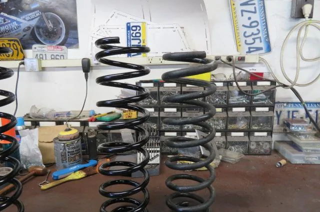

The stock springs were 17" in height. The Clayton's are 18" in height.
Pic's of before and after.

How did the length of the springs compare?
If I were to guess, probably about the same length. Lift amount came from a more firm spring rate?
(stock vs Clayton’s)
11,424
30,447
I have to add more to my post. The Clayton's are 1" taller. And the spring rate is higher. Think Clayton said 225.
