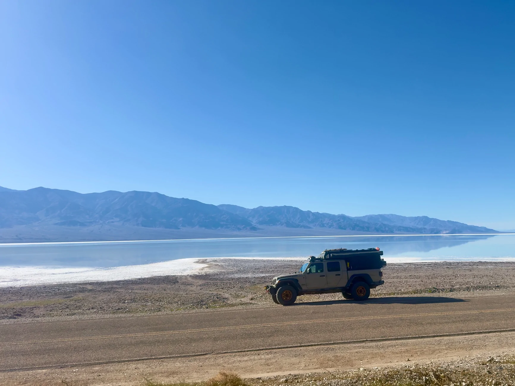

I have the Aev diesel HD springs in the truck along with with the teraflex 3 shocks and it’s never hit the bump stops. And I’m really heavy
