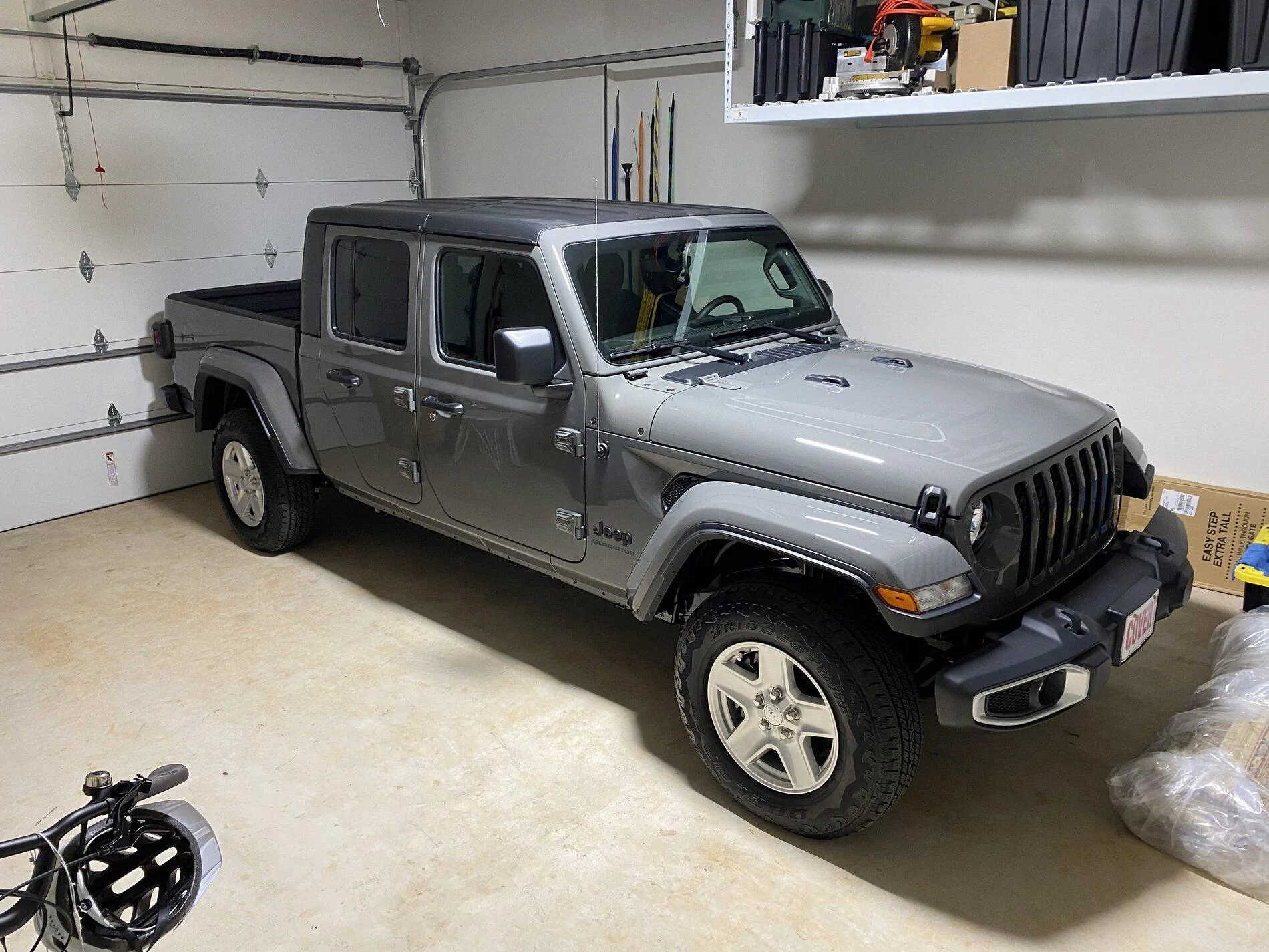

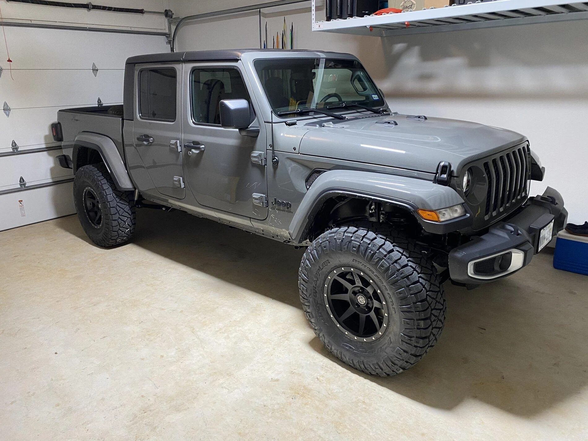

Here’s the before and after measurements with the 2.5 Ride Right and 37” Grappers.
front passenger before = 36-1/2
front passenger after = 43-3/8
front driver before = 36-5/8
front driver after = 43-1/2
rear passenger before = 38
rear passenger after = 44-7/8
rear driver before = 38
rear driver after = 44-7/8
bottom of hitch opening before = 17-1/2
bottom of hitch opening after = 24-1/4
That's a nice amount of lift! That's why I didn't go for the 3.5" version. Wanted to keep the center of gravity lower.
GladiatorCruzen
Sep 22, 2020
113
181
Austin, TX
2021 Gladiator Sport S
Elevator Superintendent
I had a hard time deciding myself, but after talking with Clayton over the phone, they assured me. They mentioned the same thing, a better ride quality with lower center of gravity. It’s plenty tall IMO. I gotta buy some steps of something to help me get in and out of it ASAP!! Lol
