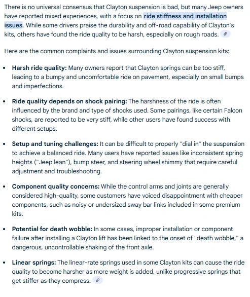

Jeep Gladiator Clayton Offroad Spring Install Problems 1760920231451-u9

As is mentioned in that AI breakdown, the only time we've really ever experienced issues is when paired with certain shocks, especially Falcon, as even though they are very popular, they could end up being too firm for some people when paired with our coils.
It's also important to mention that AI, especially Google's search AI, is heavily influenced or biased by the way you phrase your question and will provide answers based on the context of your initial inquiry. With that being said, I can tell from the initial response you received from your search that you looked something up like "why is Clayton's suspension bad" or something similar, and so it gave you exactly what you were looking for.
We appreciate your feedback, and I will pass along this information to engineering, but again I will say we that we maintain our 5 star rating on pretty much every platform because our kits deliver an excellent ride and we really care about the customer experience.
I understand there is no one-size-fits-all all for every customer when it comes to how a Jeep is supposed to ride, but we do our best to make sure we are hitting all of the marks when considering what is important for most Jeep owners looking for a lift with excellent road manners!

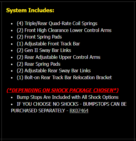

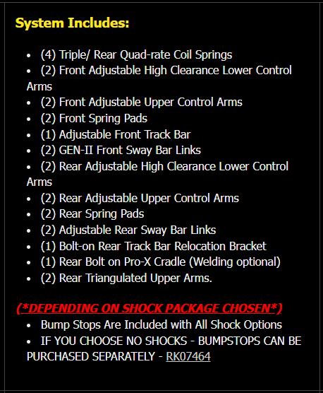

...It’s important to note that competitors like Rock Krawler, Evo, and MetalCloak do offer rear track bar brackets, correction pads, and carrier bearing spacers in their comparable 3.5” kits — not as optional “upgrades,” but as essential geometry corrections. ...
I just looked at Rock Krawler 3" and 4.5" kits.
I don't see a carrier bearing spacer included with any of them.
There also isn't a rear track bar included, so they're including the bracket to center the rear axle.
RK 3" Overland lift components:
Jeep Gladiator Clayton Offroad Spring Install Problems RK 3in Overland lift components
RK 4.5" Adventure lift components:
Jeep Gladiator Clayton Offroad Spring Install Problems RK 4.5in Adventure lift components
