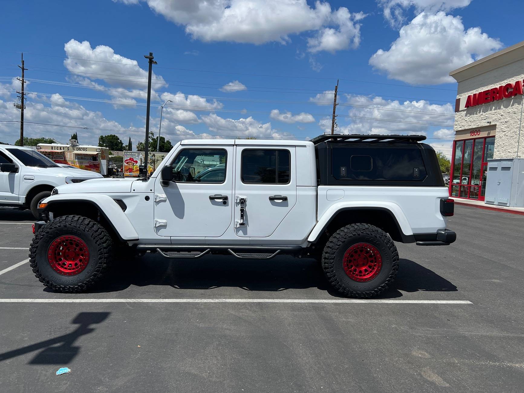

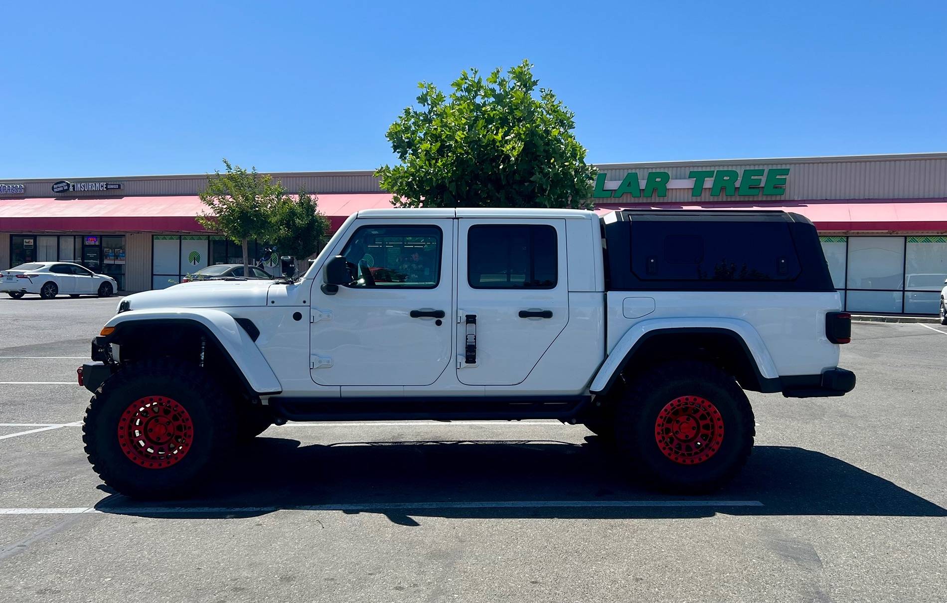

Here is a before and after pic. The truck is sitting on a preexisting AEV 2.5” lift with AEV geometry correction brackets, Clayton front and rear adjustable track bars, and fox 2.0 performance shocks for 2-3” lift. Was only swapping springs as I did not like the AEV springs.
Look leveled to me. Put the level on your rock slider. The Rubi front flares are higher.
When I had a question. Clayton told me to measure at the pinch weld behind the rock rail, behind the front tire and in front of the rear tire to see if it's level or not.

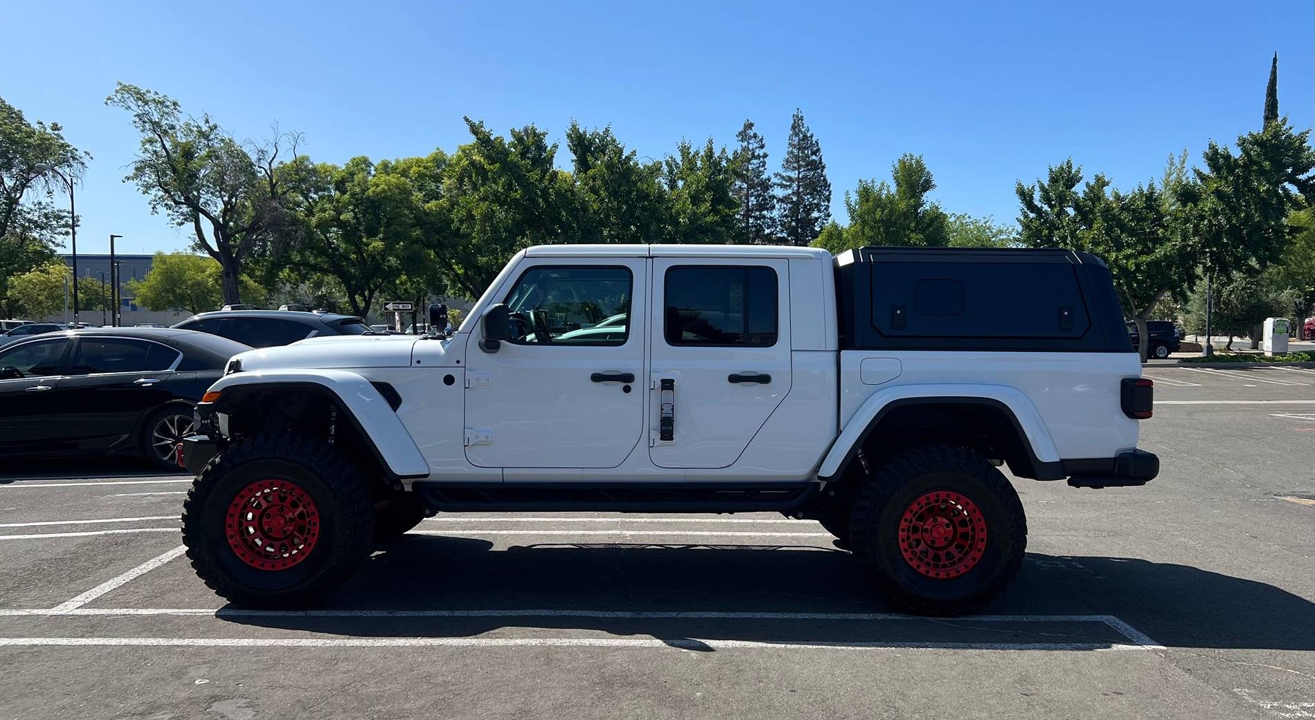

Update: they installed the 3.5” springs today. I am back to 1.25” of forward rake unloaded. I was originally looking to remove 1” inch of the factory rake which Is close enough for me. Satisfied with the result.
