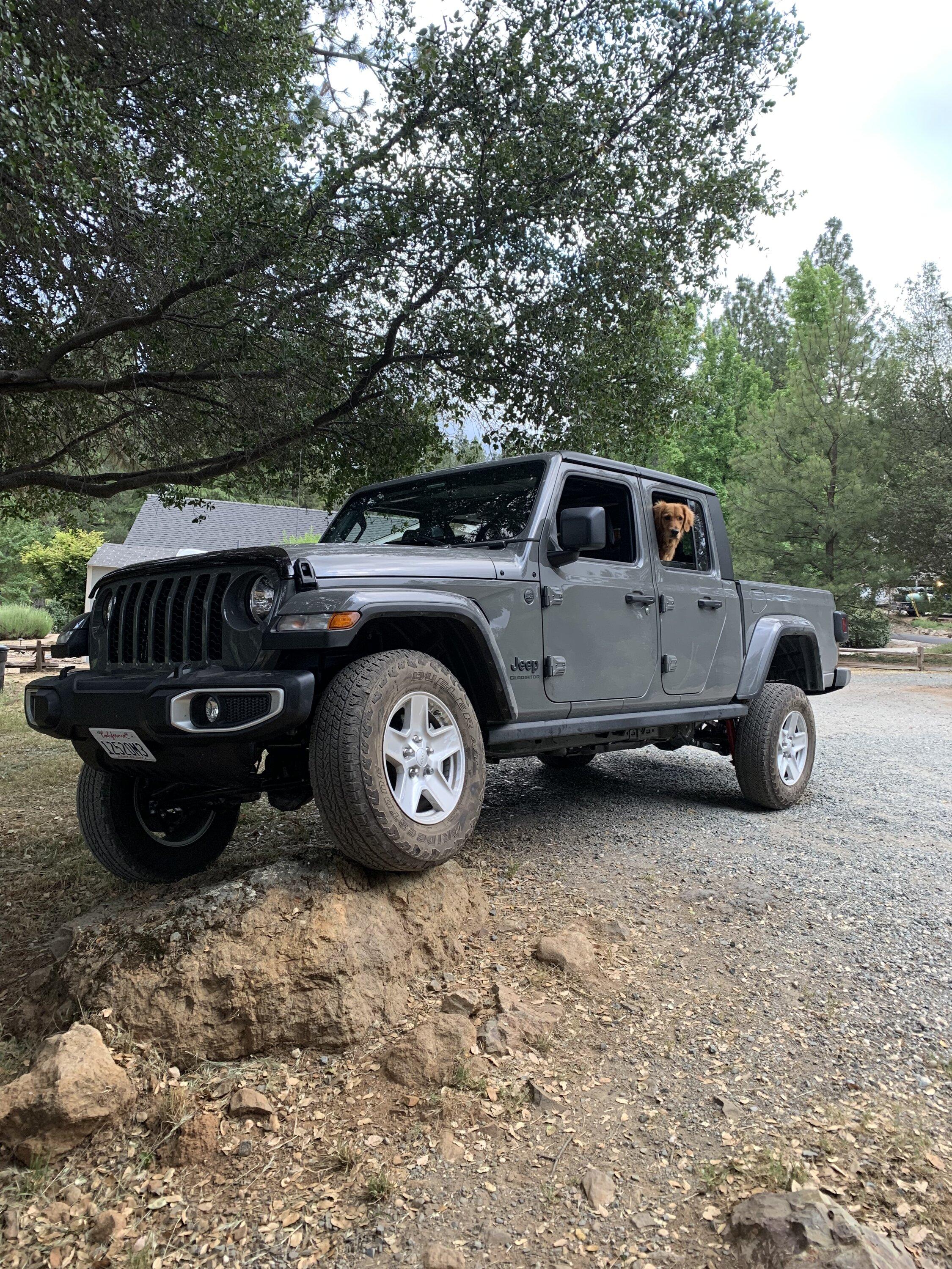

Jeep Gladiator Clayton or MC D1CB7232-D5DA-40EE-881F-650267361610

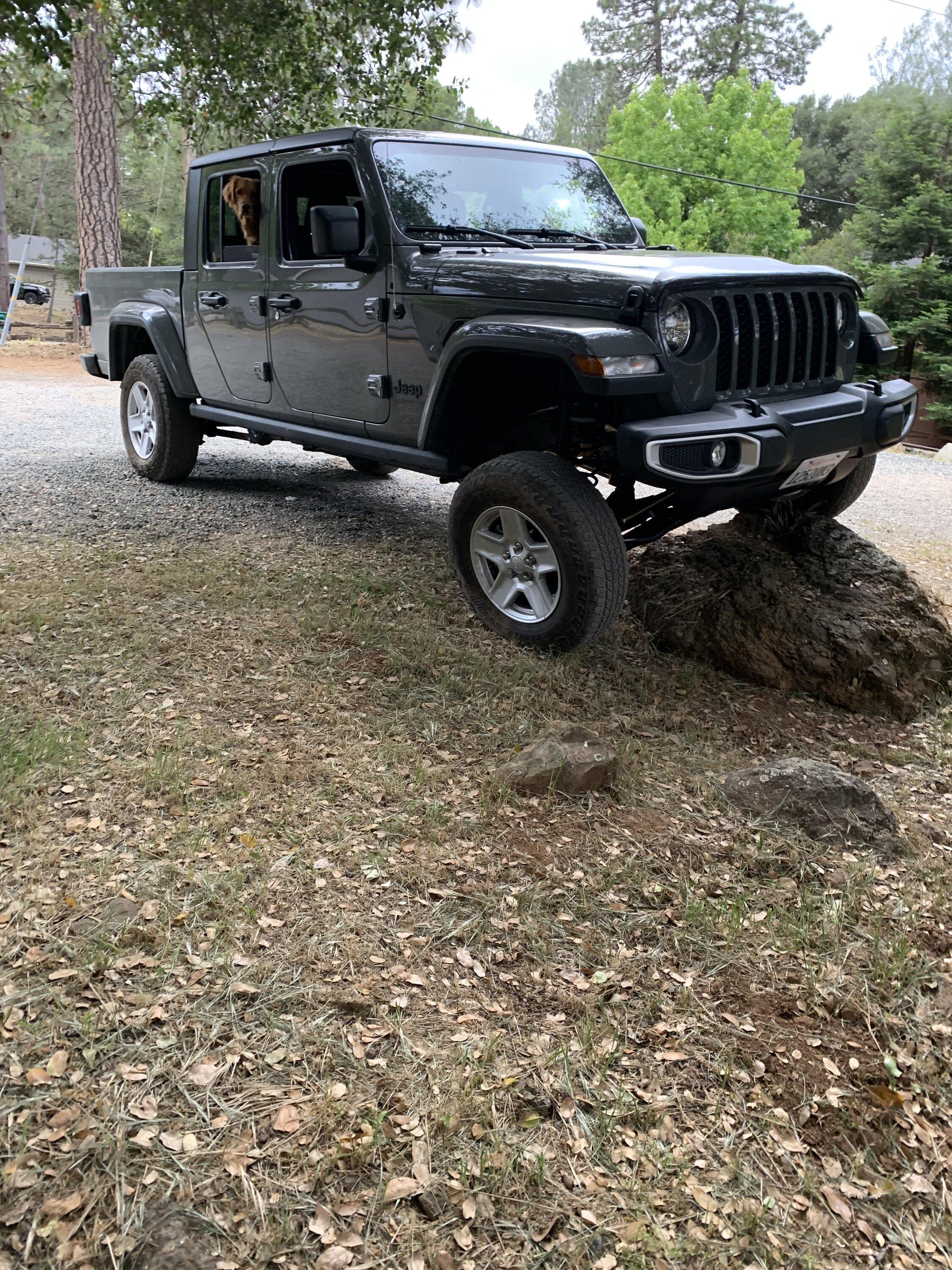

Jeep Gladiator Clayton or MC 36F7761D-5674-4570-981E-1729999BA93E

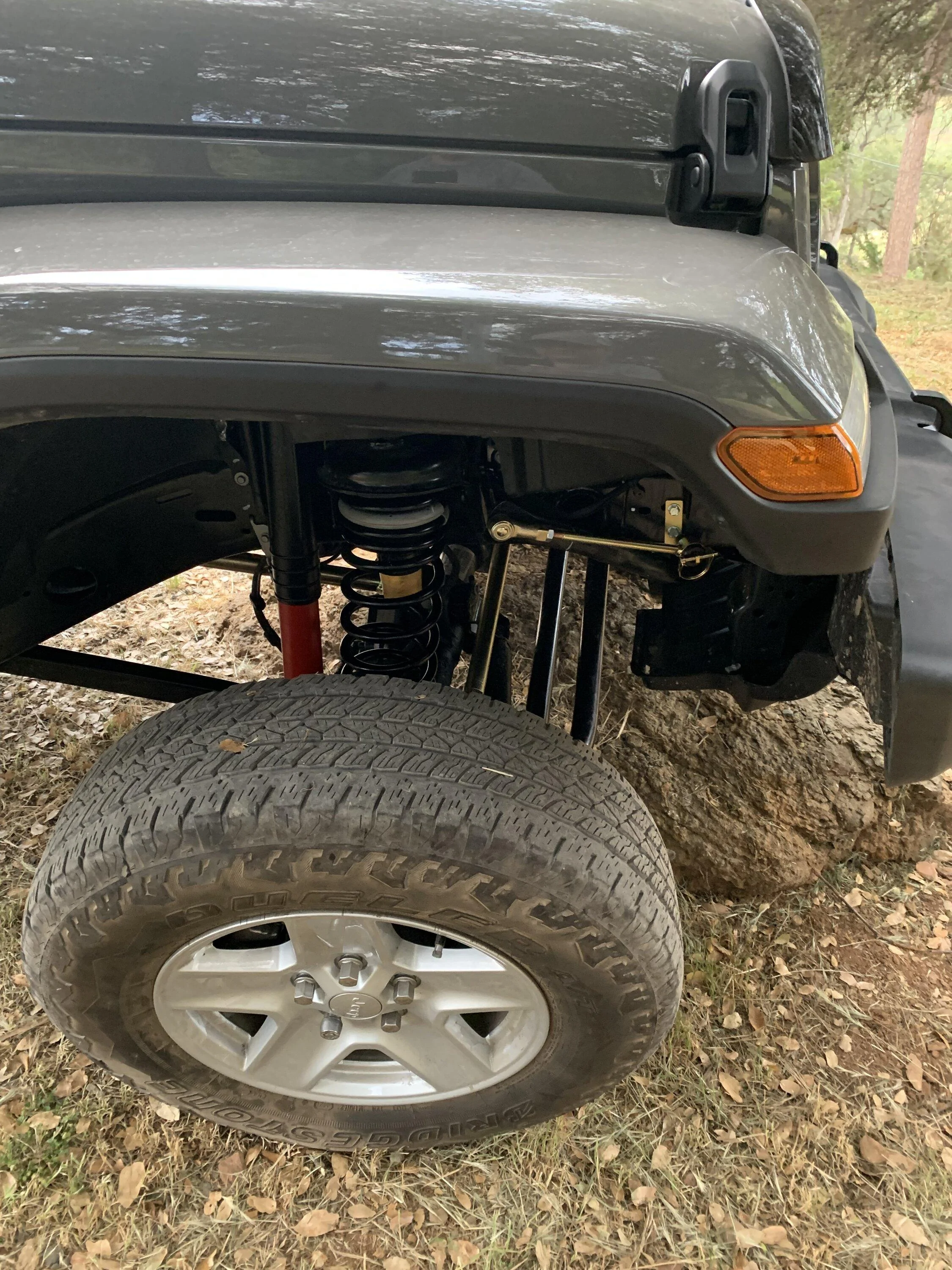

Jeep Gladiator Clayton or MC 6ADC4D9E-1DC5-4519-A7CC-6A40542EE047

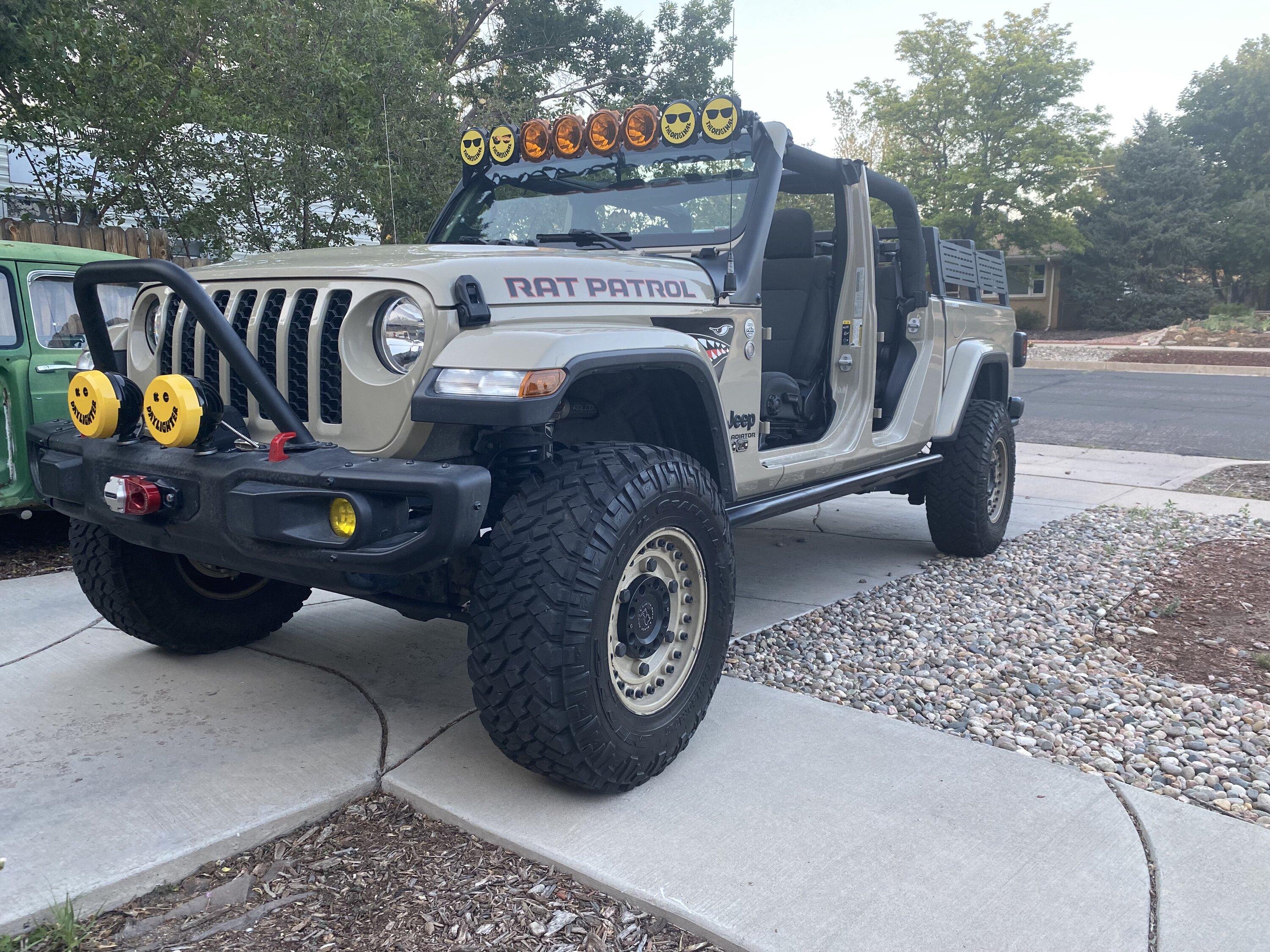

Clayton will get you higher with the 3.5 and the springs are heavier rate for towing/hauling. I personally went Clayton springs with metal cloak arms as I'm a big fan of their joints but wanted the heavier springs for the truck type of uses.

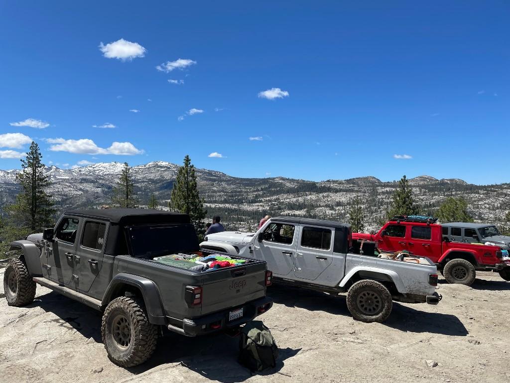

I have the 3.5" Clayton Overland Plus kit. The real main difference is that the Clayton kit has stiffer springs, and is higher in the rear... which is exactly what the Gladiator needs -- in my opinion. I would hate it -- if when I loaded up my bed, the rear sagged, and the lift kit dissapeared... Here is an example. Three loaded beds finished the Rubicon. My Gray JTR with Clayton, the white JT with another 3" lift, and the Red JTR with another 3" lift, where the owner added a 1" or 1.5" puck to get back his lift...
I had good ride height, and I stiffend my Falcon shocks for the rock crawling and I did not feel the weight, nor did I ever hit my bump stops.
