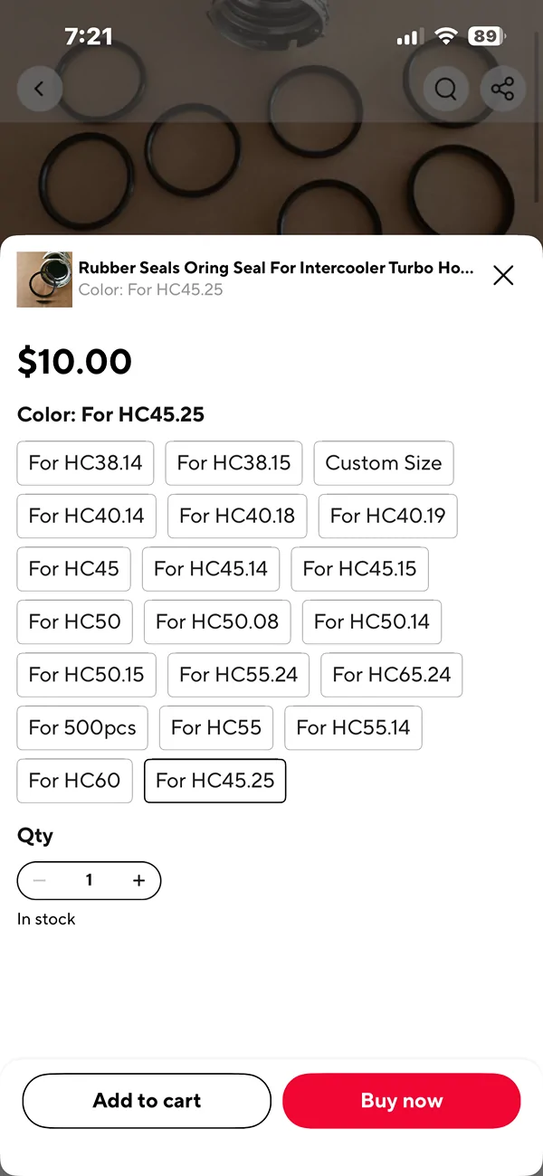

I checked my charge pipe connectors today.
Both hot side connectors to the turbo elbow and the resonator is HC 45.25. Cold side to throttle valve is HC 55.24. The seals can be purchase below. $10 each.
I just found this on AliExpress: https://a.aliexpress.com/_mNa9ZPV
Jeep Gladiator Code P026D and split cold side CAC pipe IMG_0757
