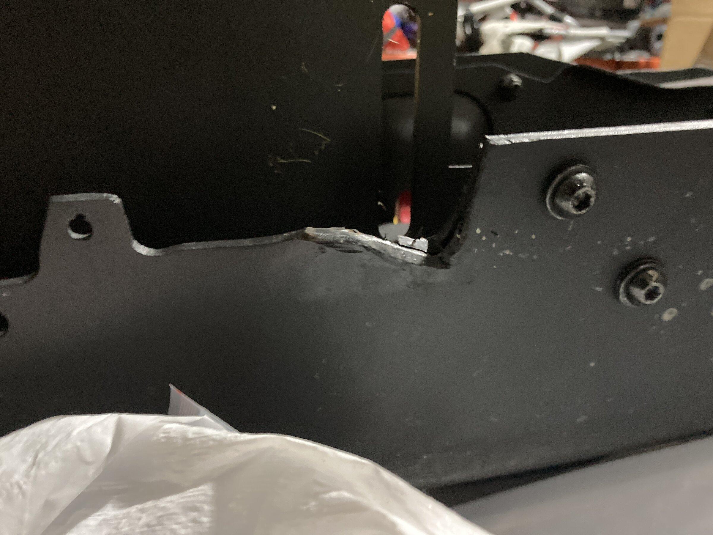

I got an ebay special “rubicon” bumper off a fella a while back. He modified it to work with his mojave skid. Ill snap some pictures in a bit.

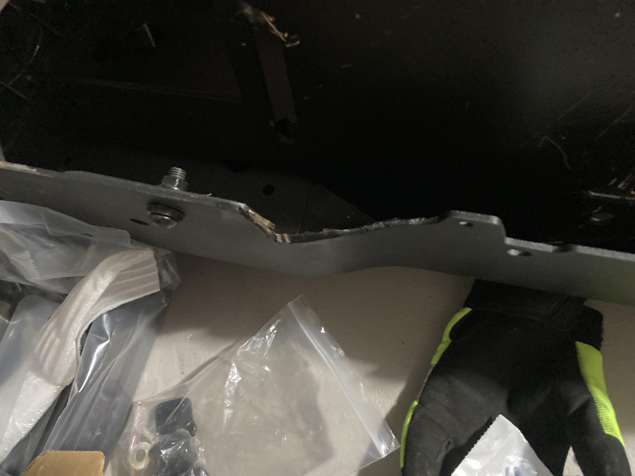

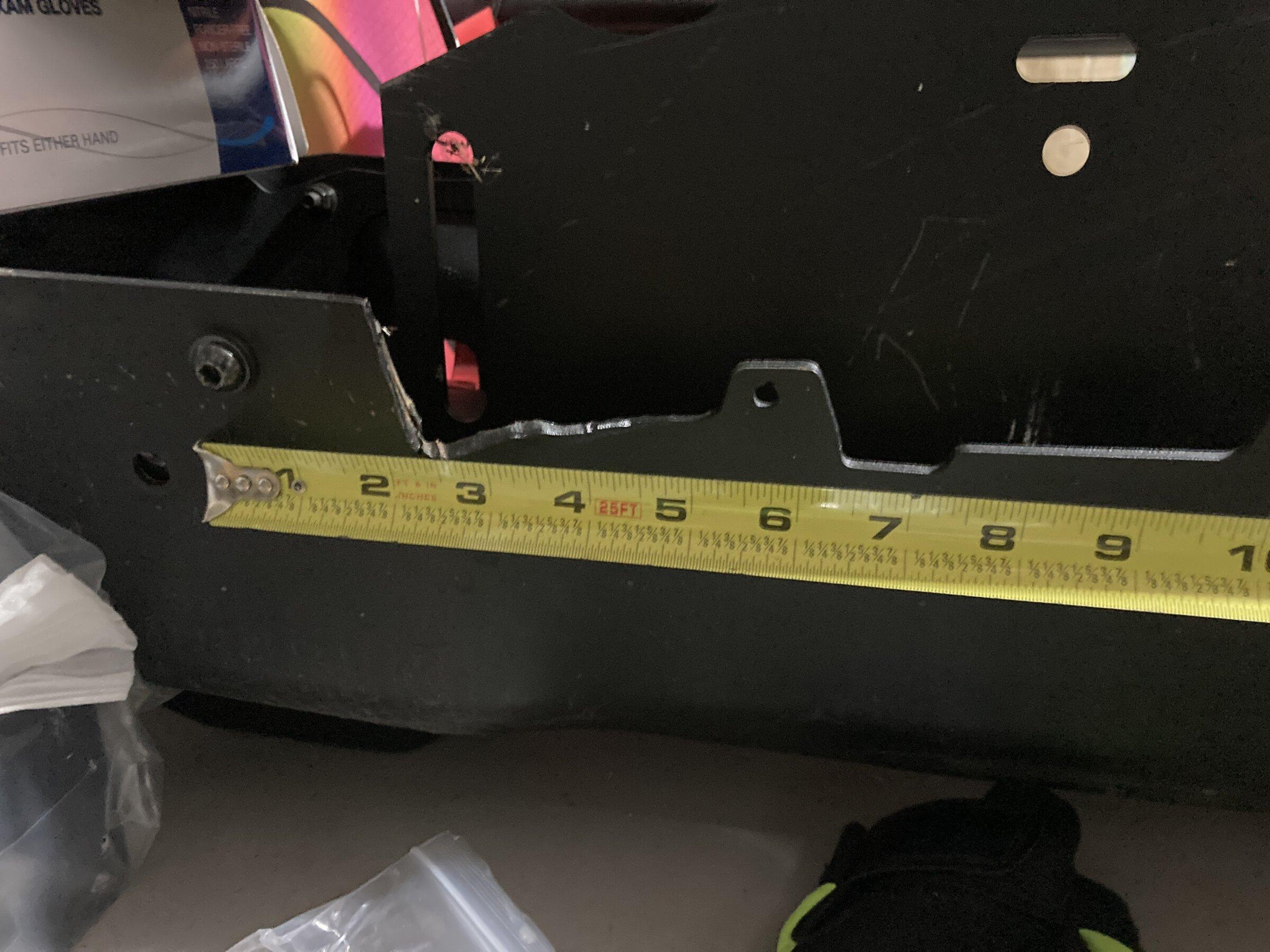

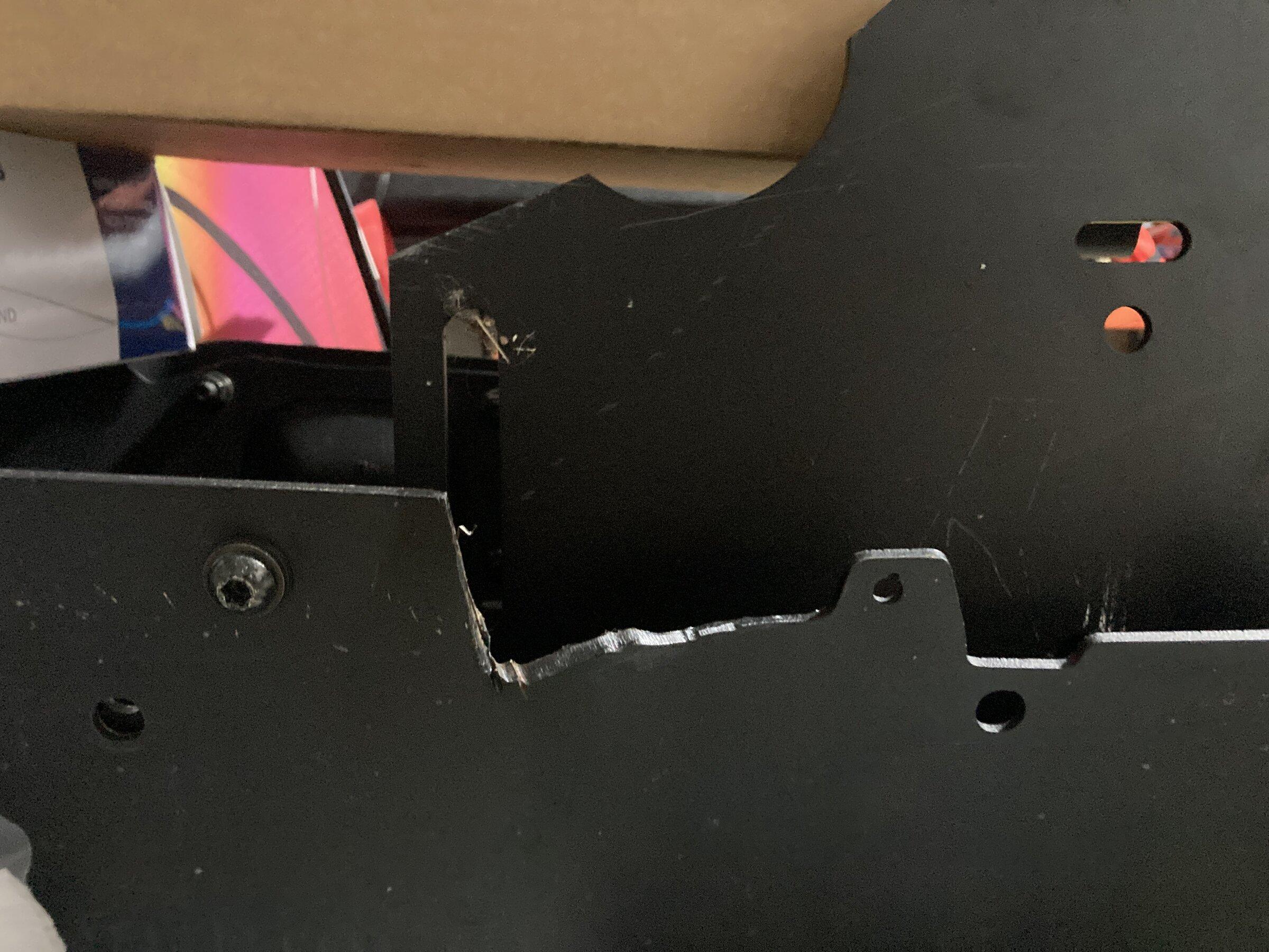

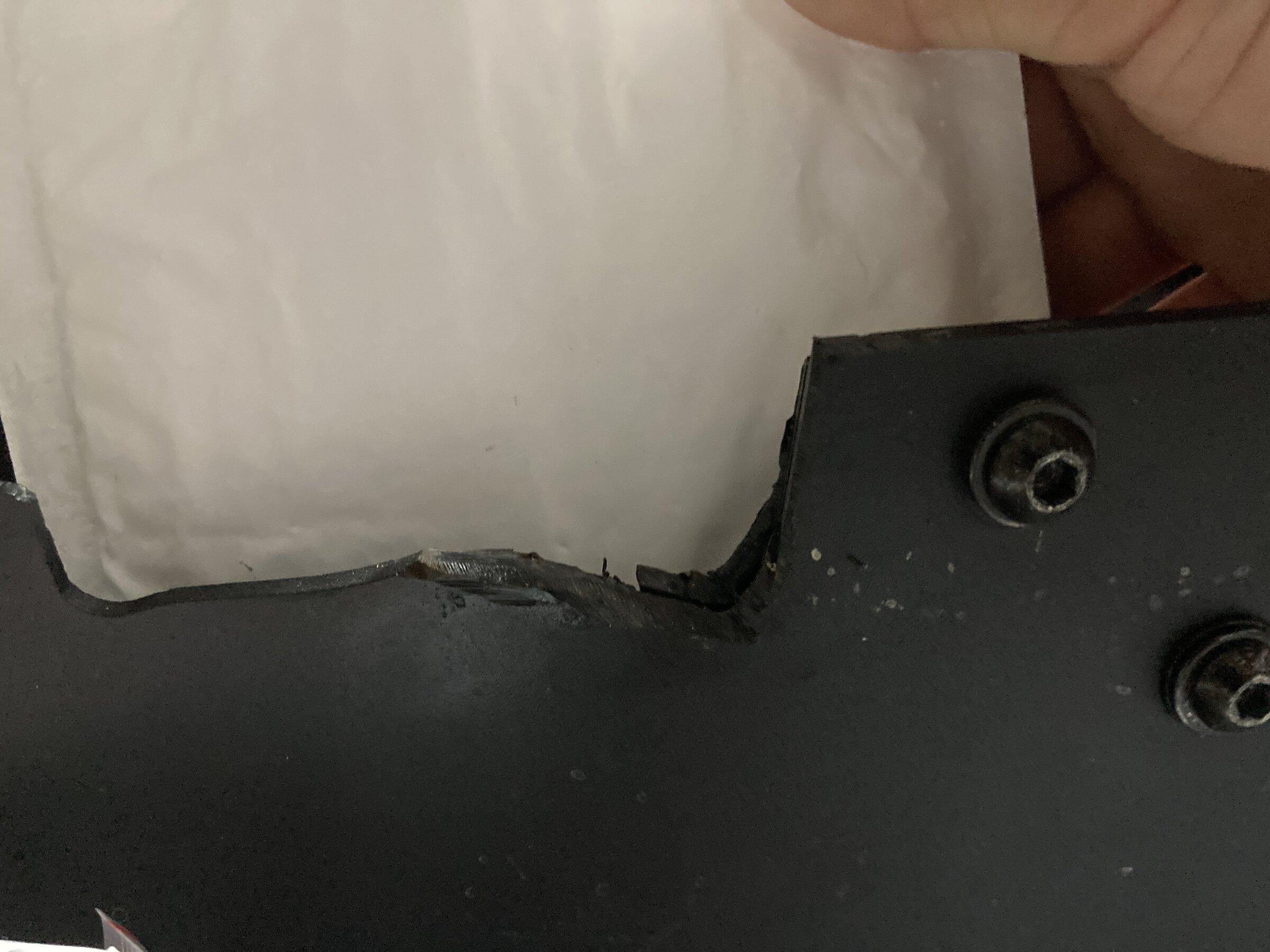

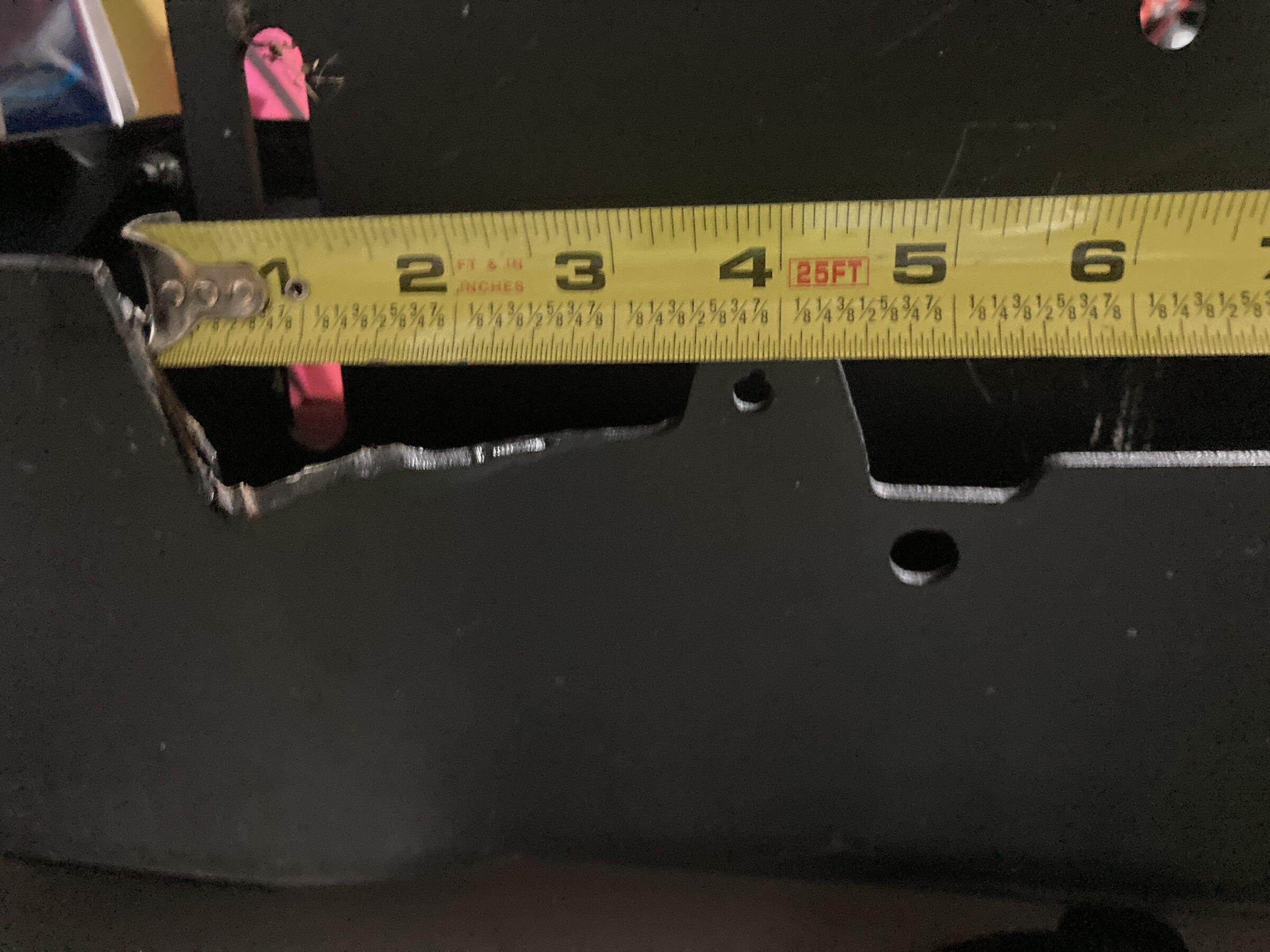

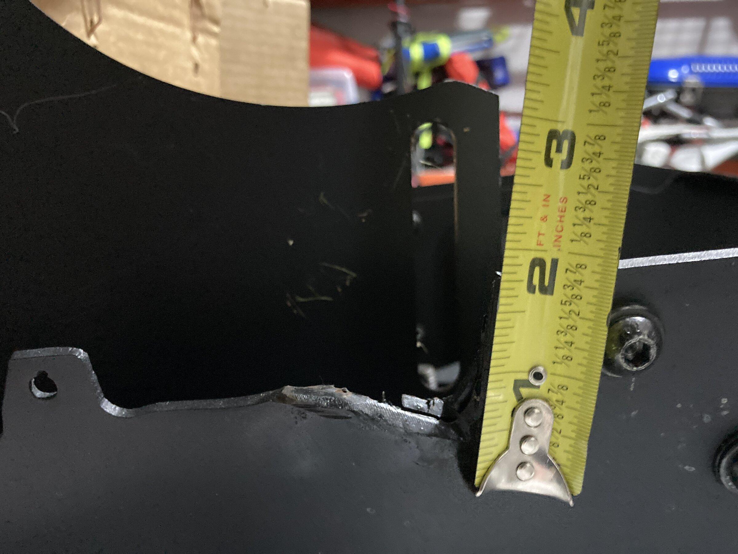

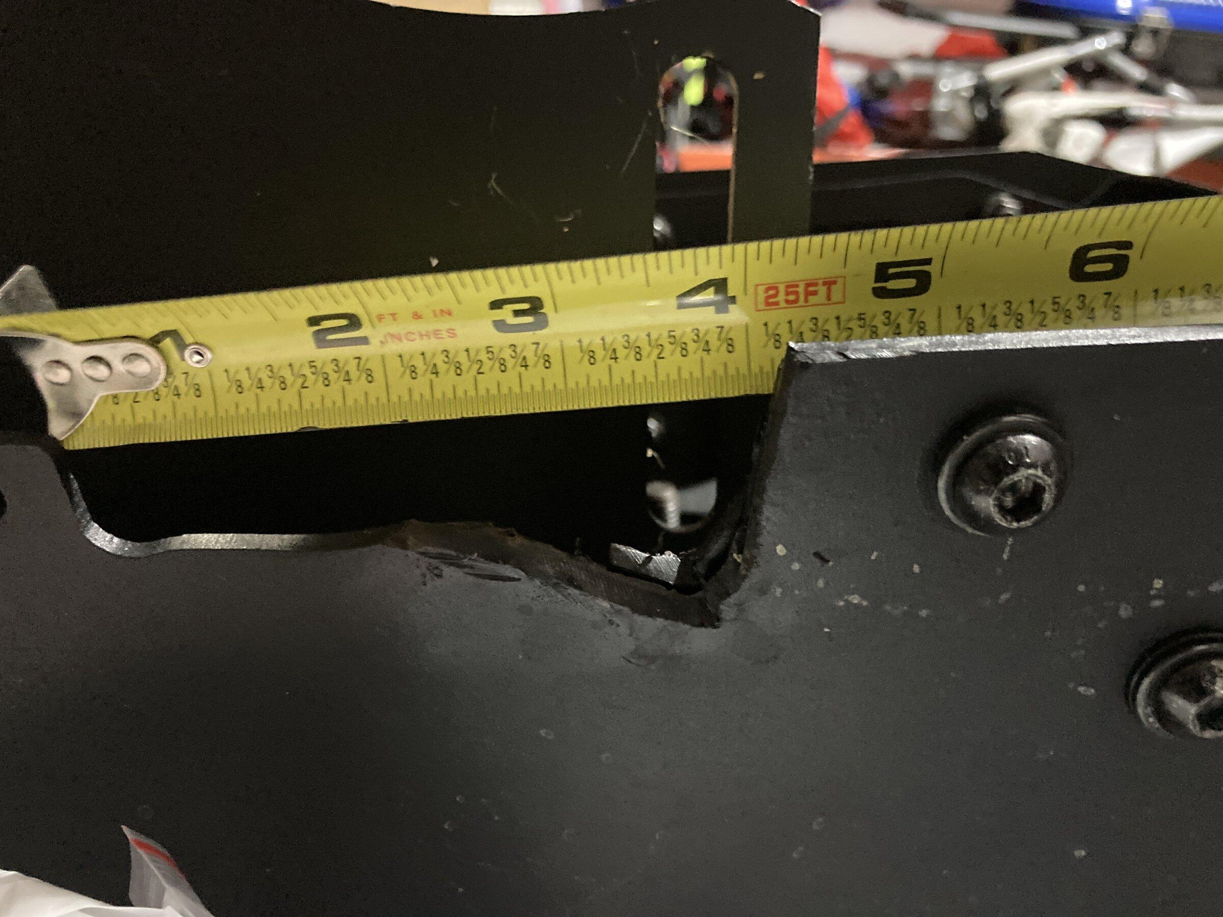

If memory serves he said he had to cut just the corners on the bottom in order to make the Mojave skid fit. Tried to take a few angles and some measured shots for you. You can usually pick up the eBay bumper cheaper than an OEM Mopar one which makes it a much more palatable project to cut. But honestly if the guy I bought it from didn’t tell me I would have never noticed

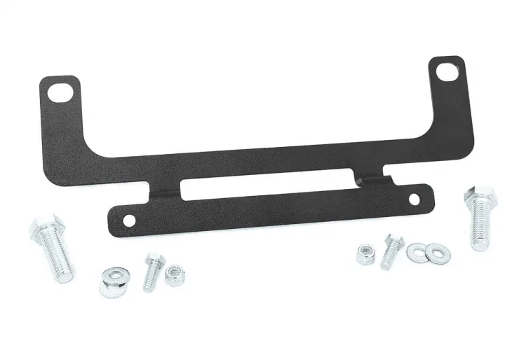

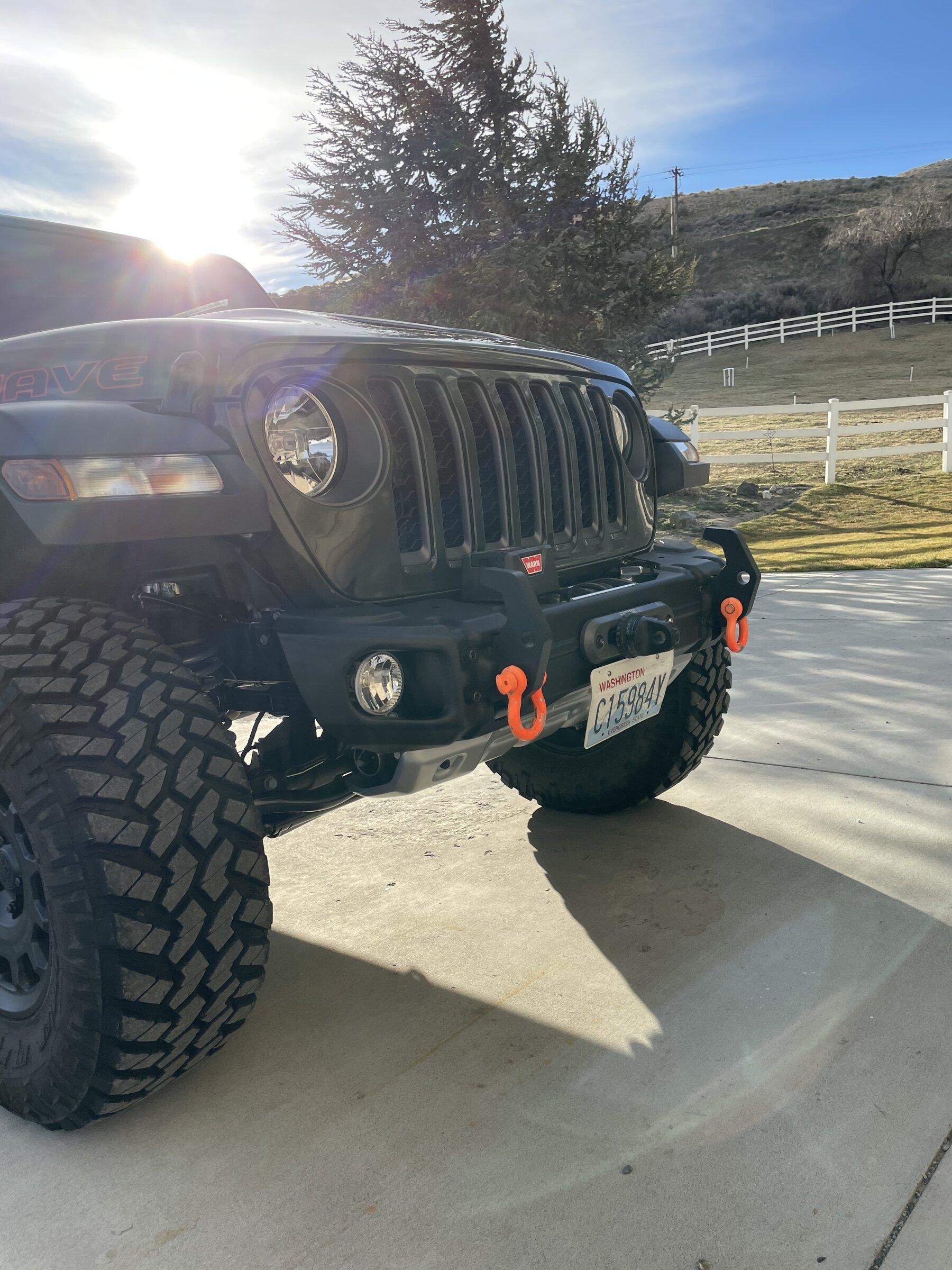

Is this yours? I was just curious if the license plate holes are there by default or you had to drill them.
It is mine and the license is held with a bracket mounted behind the fairlead. This is not the same brand but similar.

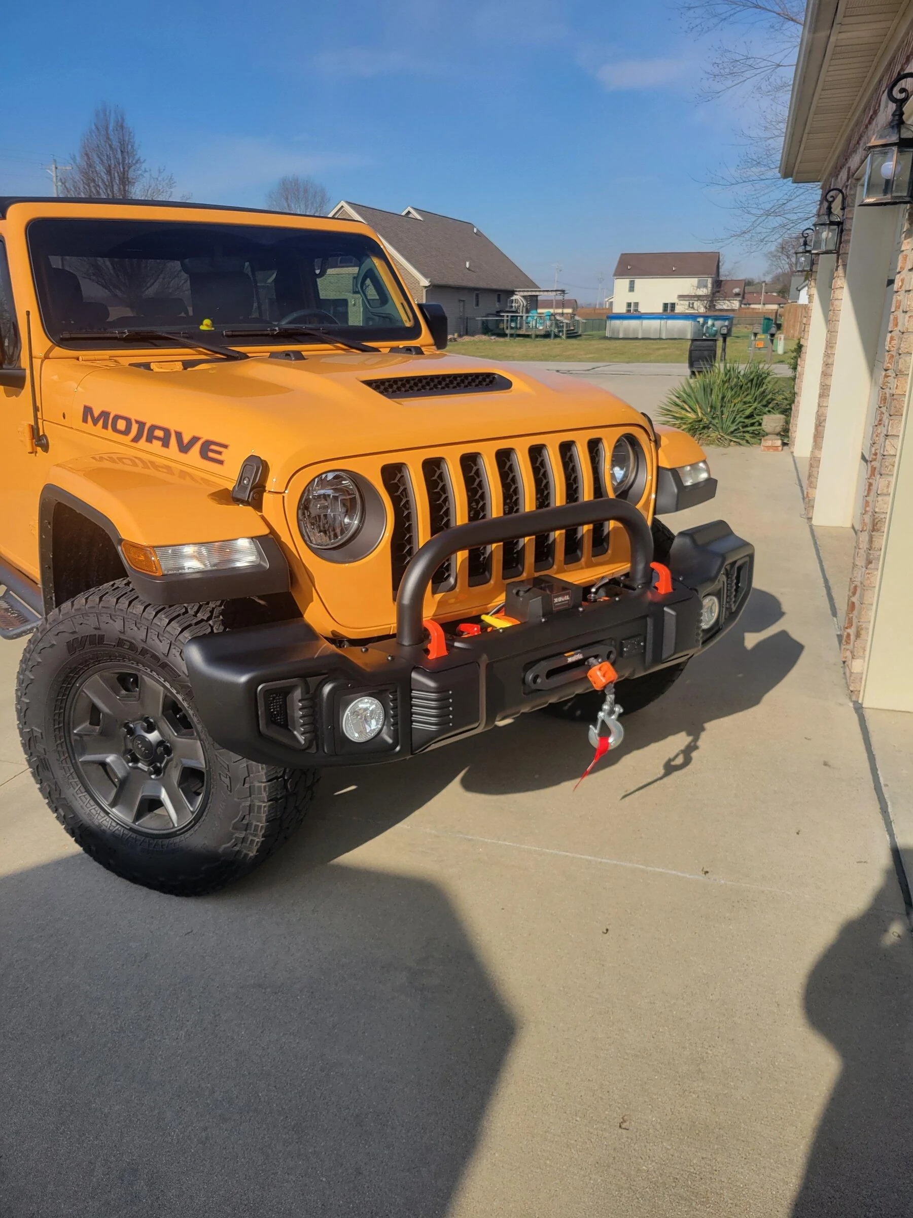

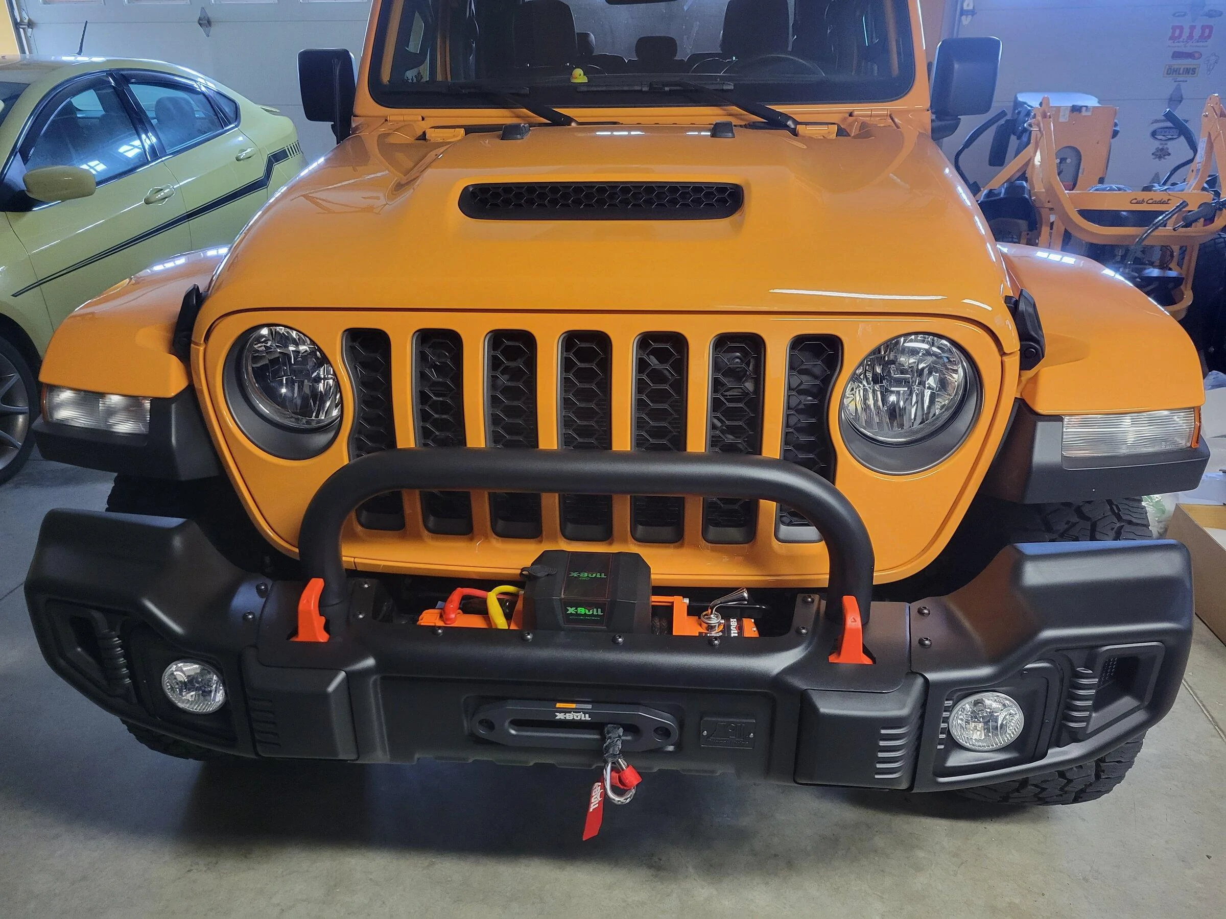

I installed the Rugged Ridge Spartacus w/overrider bar on my 2l Mojave and it clears the skid plate with no modification.

Very nice!
