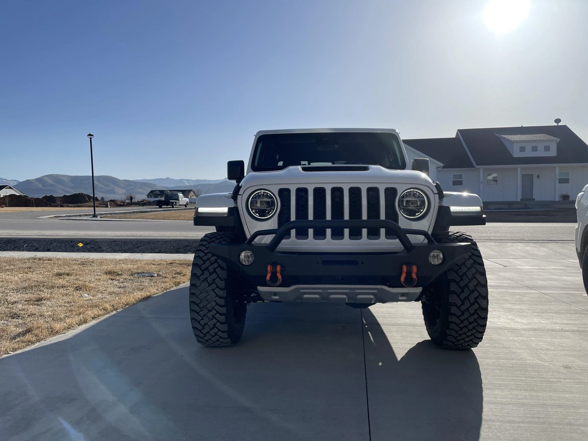

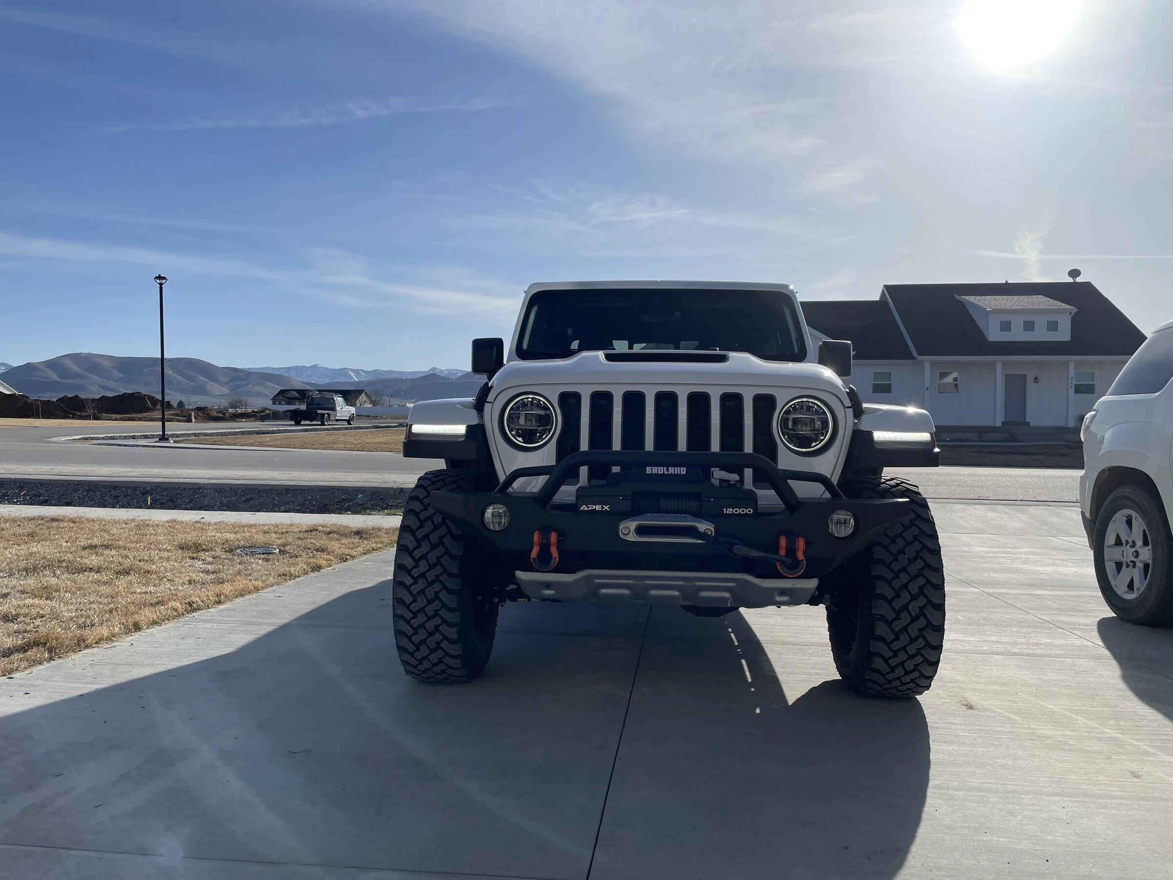

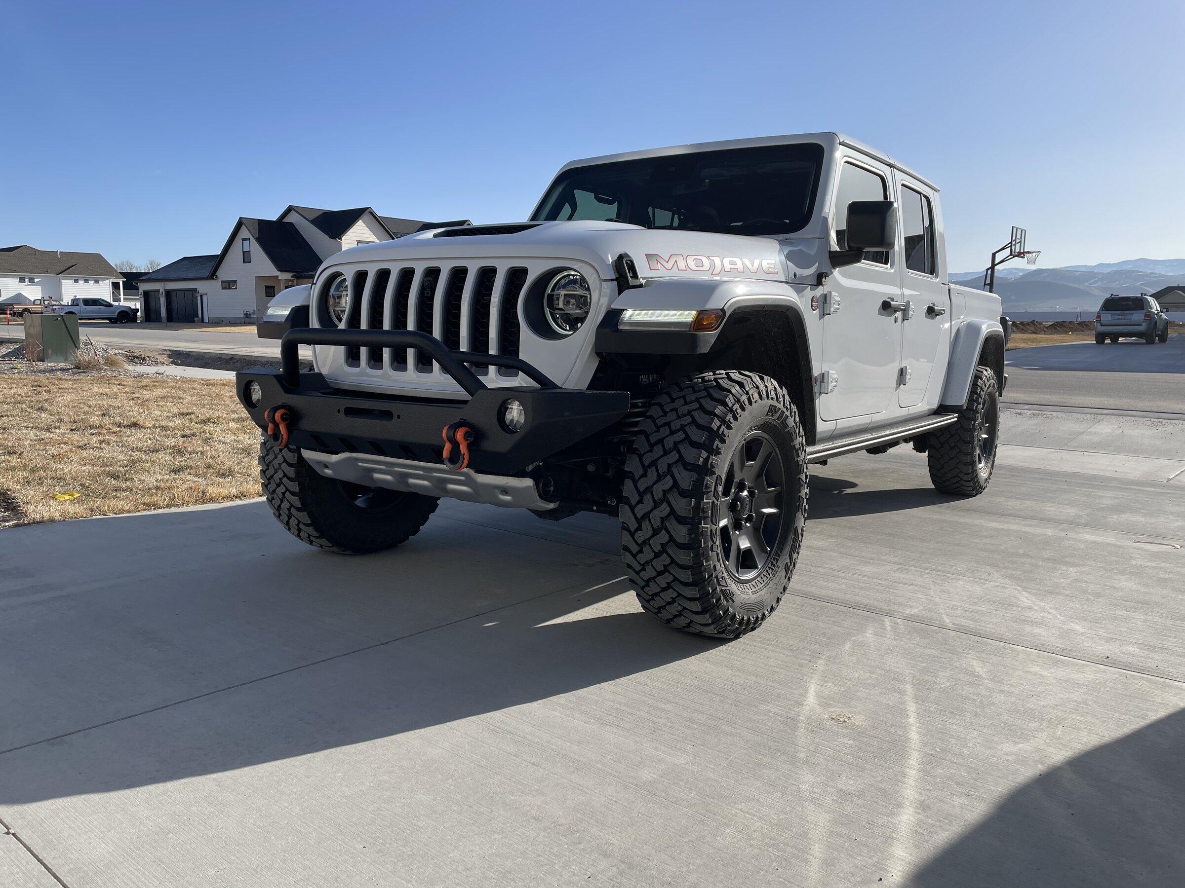

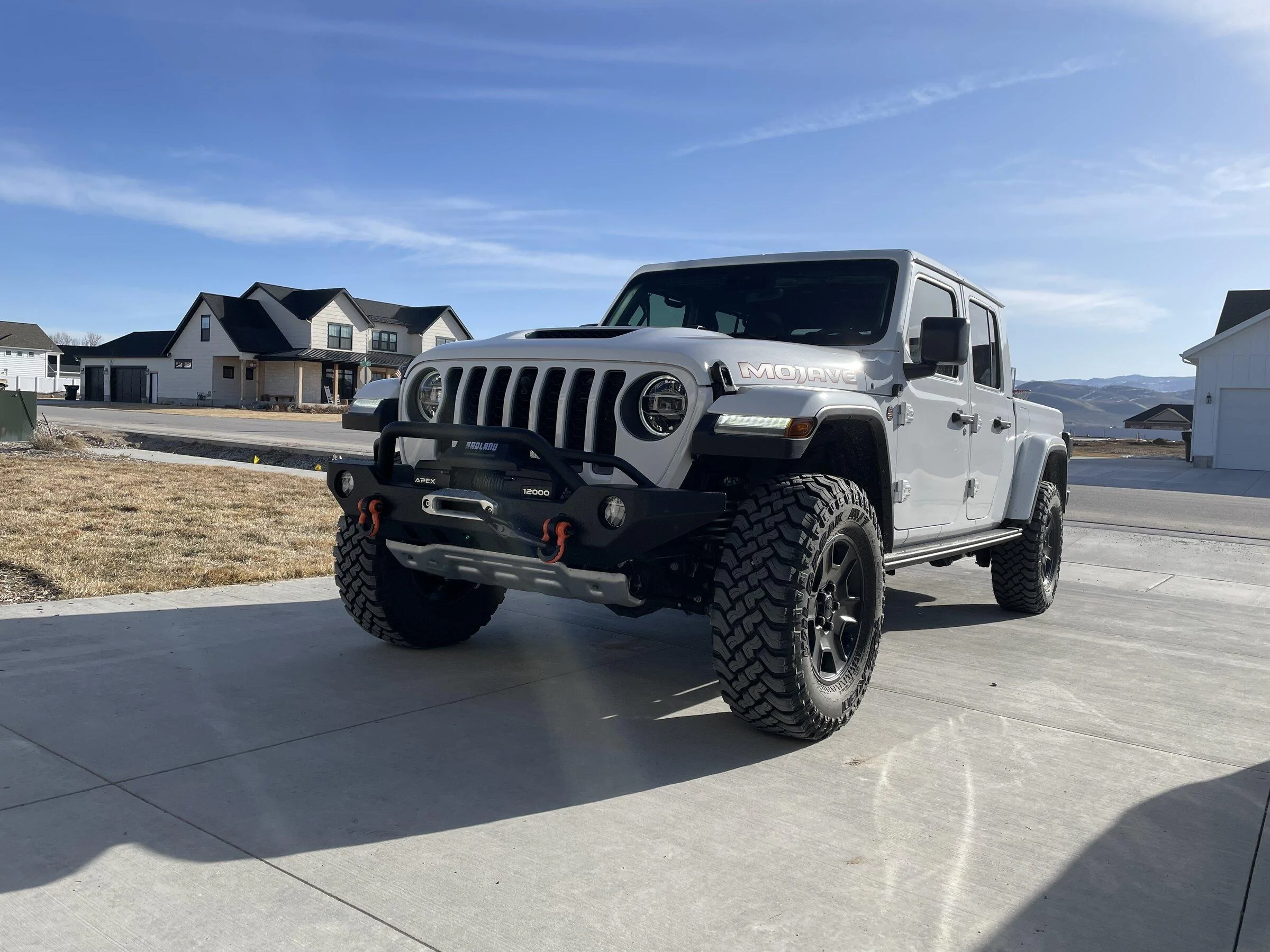

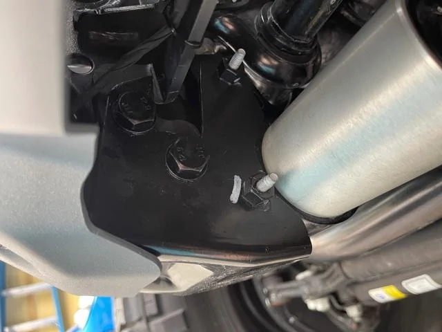

I ended up getting the Rugged Ridge Venator Front Bumper to fit on a 2021 Mojave. You will need to notch the old lower skid plate bracket in order to maintain the OE shock reservoir mount. I found it easier to roll the mount into place, with the shock attached, from the back to the front. This is why the notch is deeper and wider than you would anticipate. It needs to clear the back winch plate mount at roughly a 45 degree angle for install. Hope that helps!
