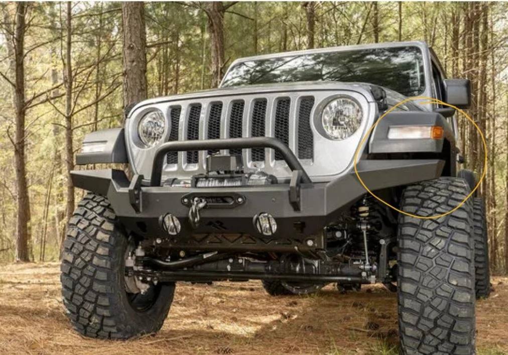

The pics on Quadratech show the bumper higher, is this a Mojave difference??
The difference you are seeing is the fenders on Mojave and Rubicon are higher clearance. Look at the black plastic the blinker is mounted in. Darksides is Mojave where the ad photo is Overland. Overland is thicker/bigger so when take that away and additional fender gap added it’s pretty big gap.
I couldn’t have explained it better myself. The Rubicon and Mojave DO have higher profile fenders than the Sport and Overland models. This is why there’s a larger gap between bumper and fender.

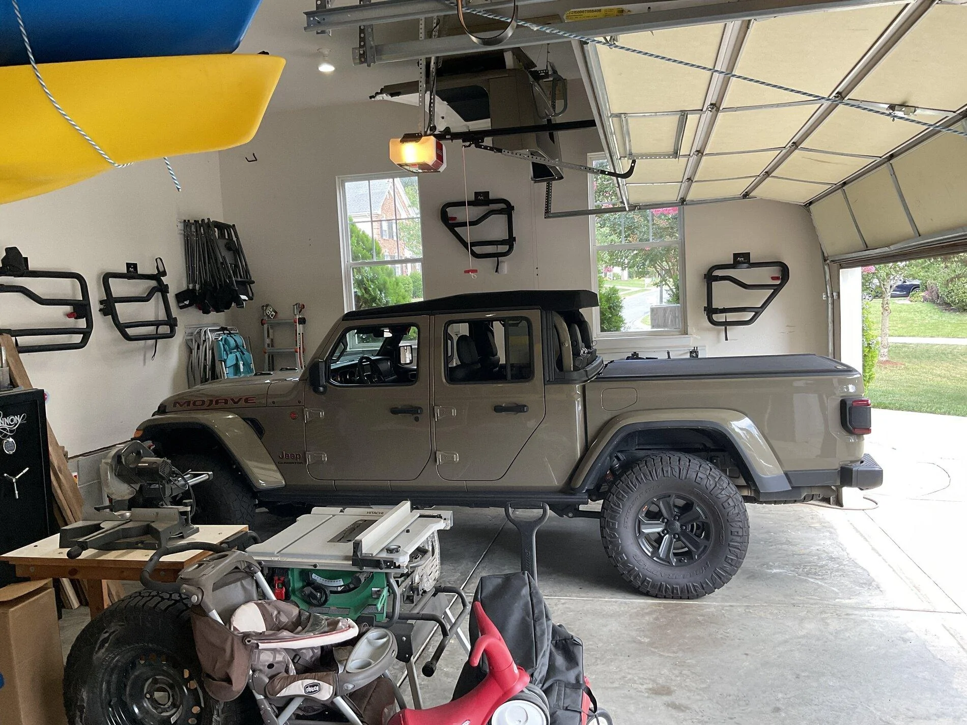

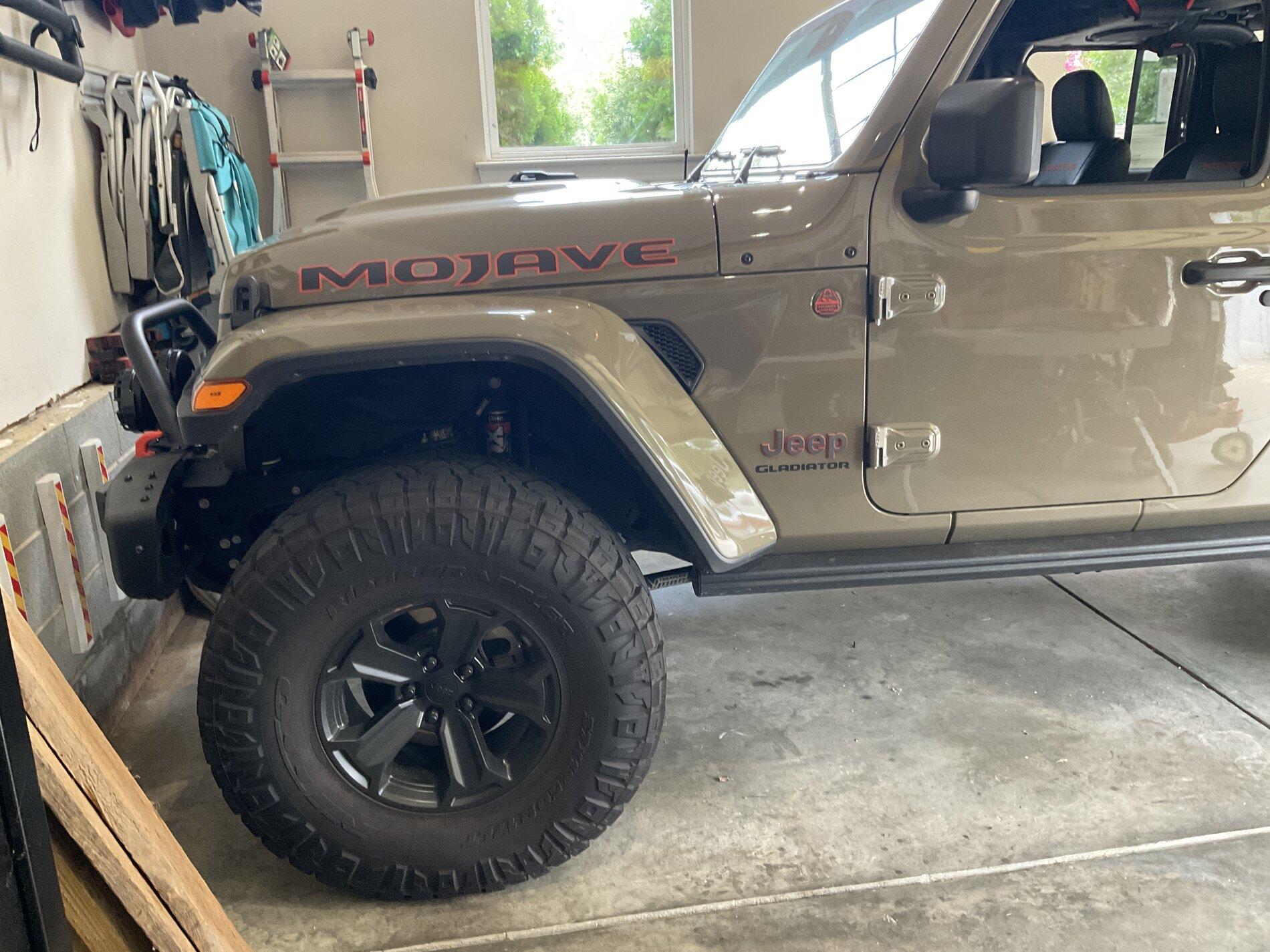

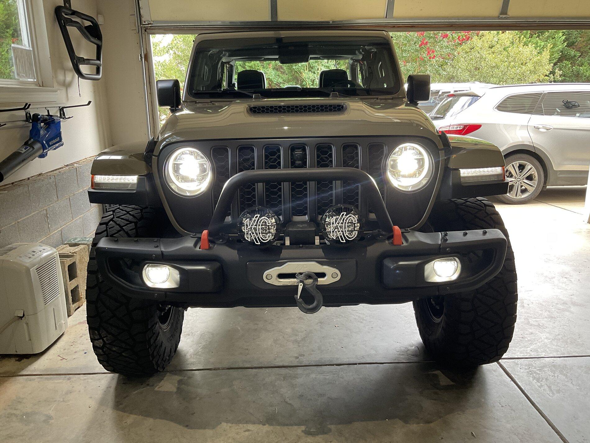

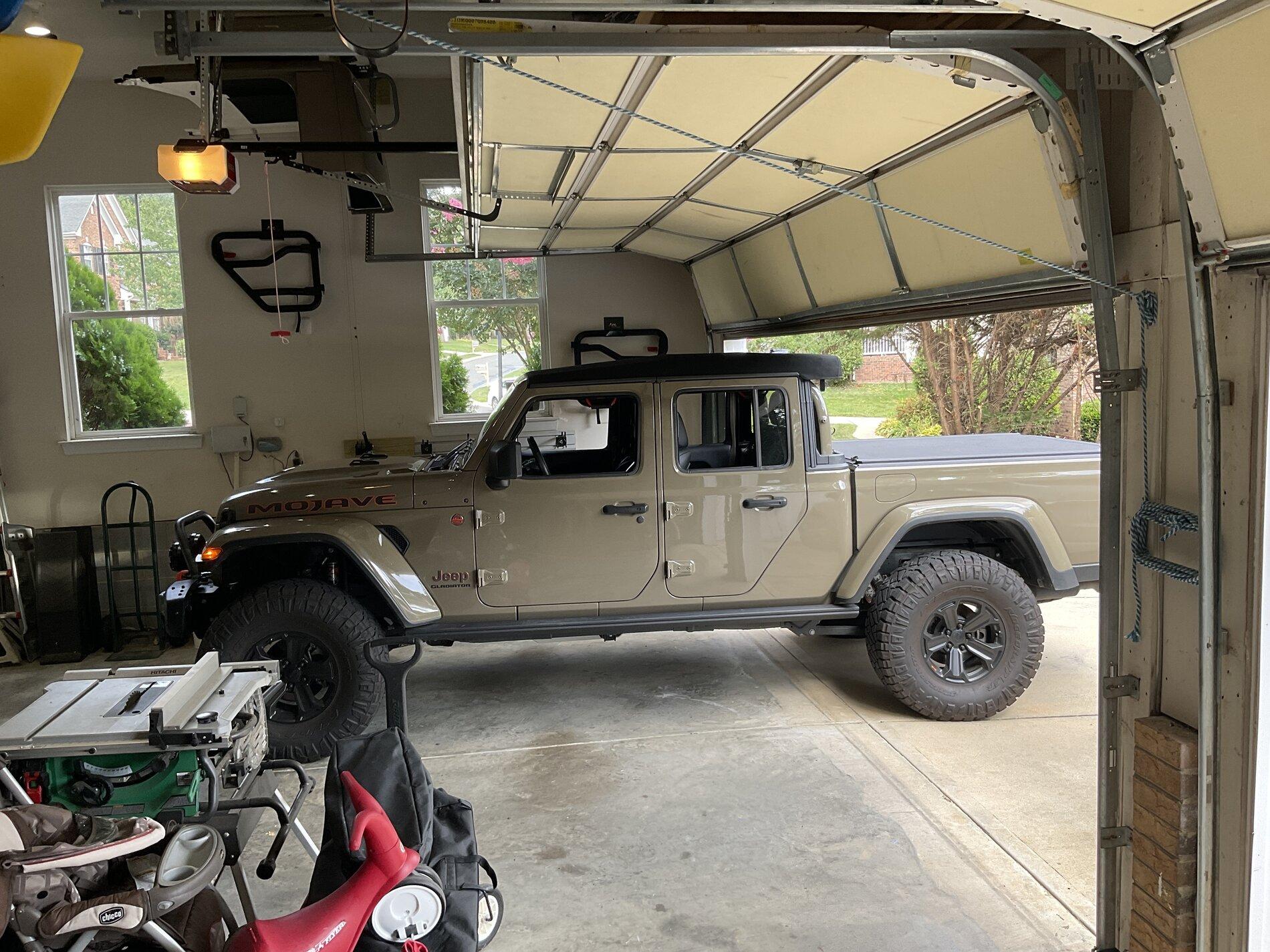

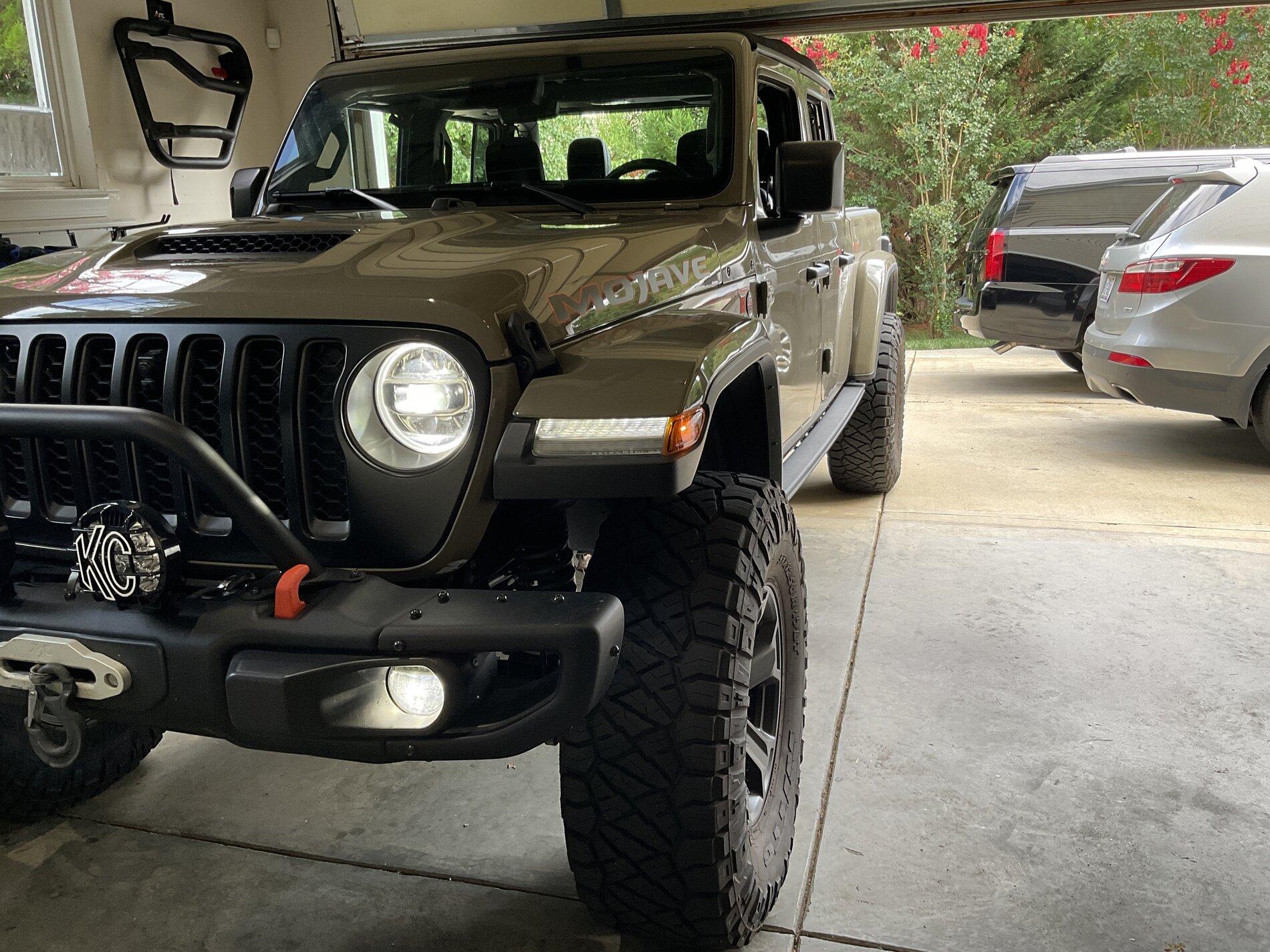

So, I have a Mojave I lifted with a 2” spacer in the rear and had planned to add a 2.5” in the front as I added my old JLUR Mopar steel bumper, winch plate, winch and bull bar. something told me to go with 3” up front, which I did. I have zero rake and am dead level. Not sure if that helps at all.

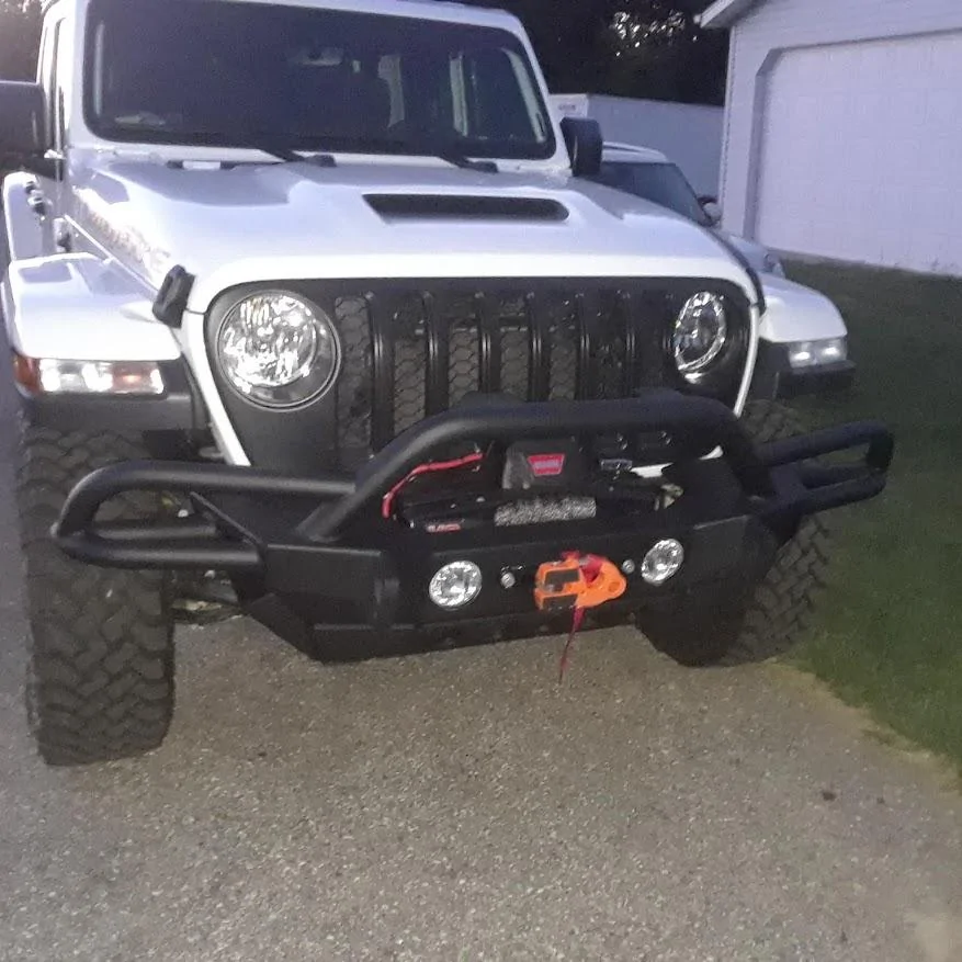

Here's what ended up on my 2020 Mojave:
Jeep Gladiator Mojave Aftermarket Bumpers front
Smitty full width, Warn evo 12k, stock fog lights transferred no problem. Winch mounts fairly low, never seen a bit of difference on my temperature gauge.
