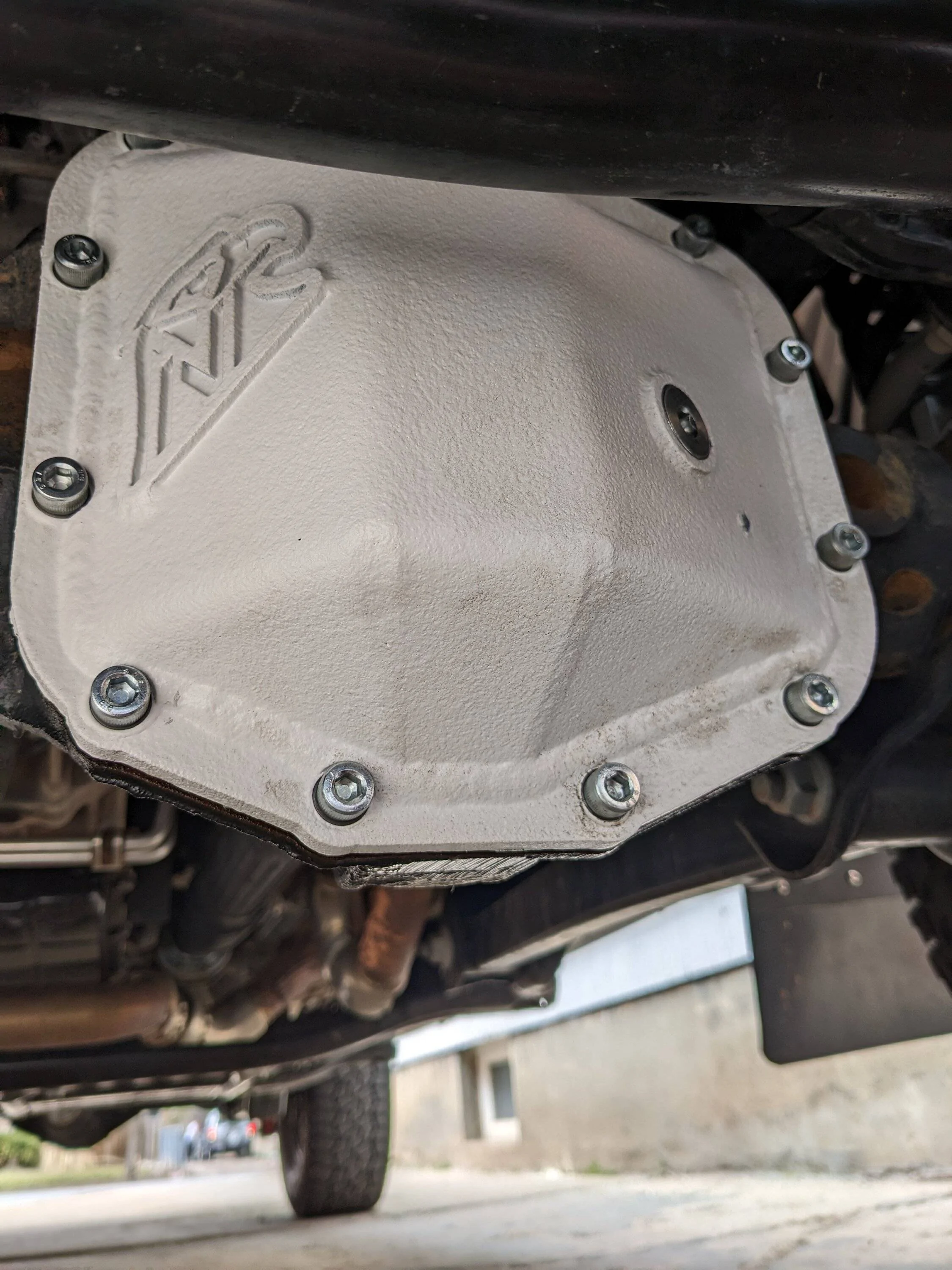

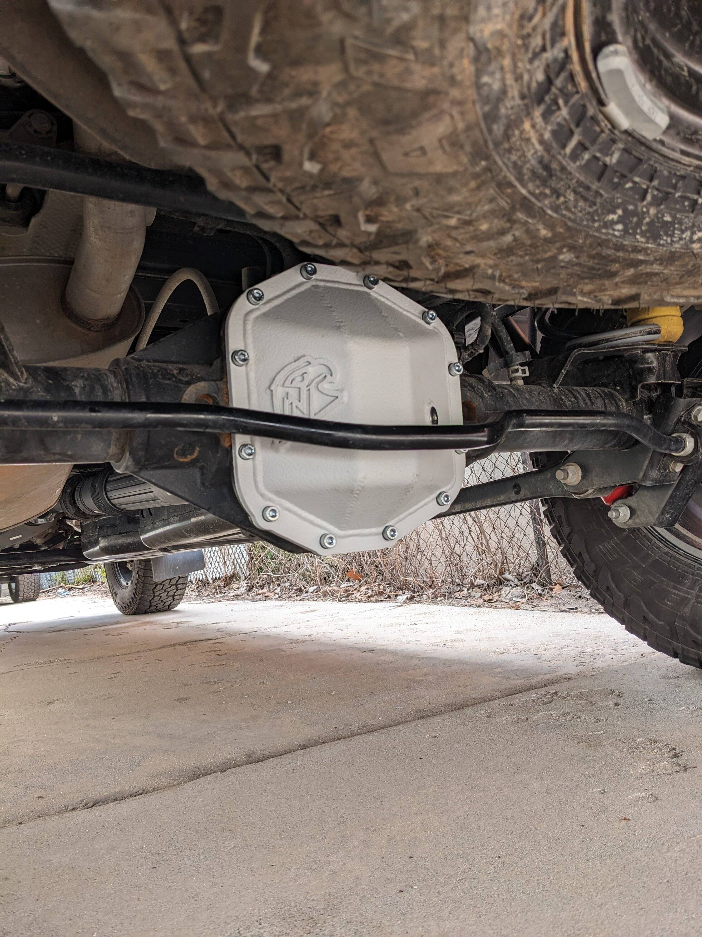

With some decent weather days before more snow, I installed my next venture HD diff covers. I coated them with some raptor liner and let them cure for a couple of days before the install.
I re-used the gaskets as my OEM ones are back ordered. So far it hasn't been leaking.

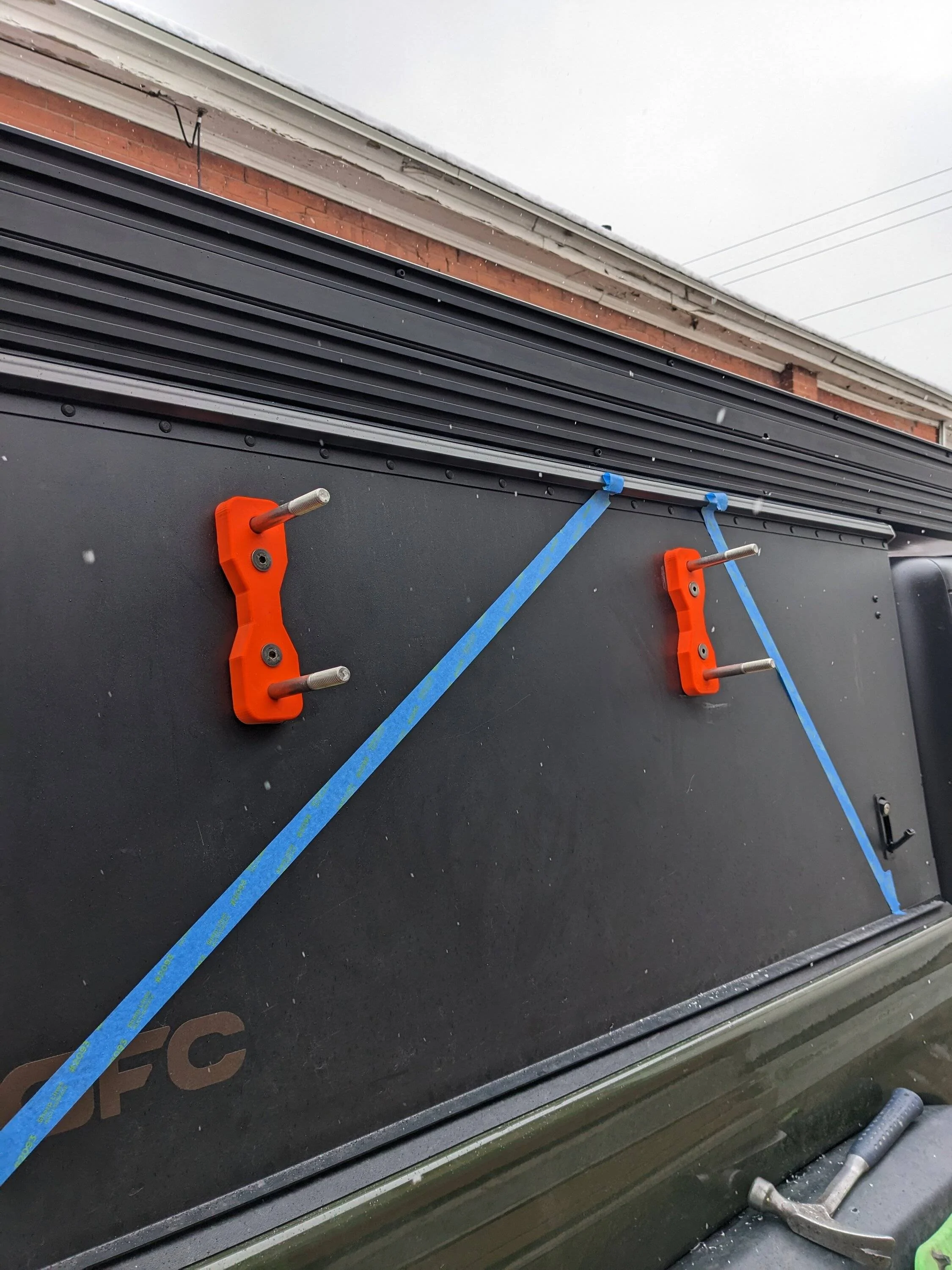

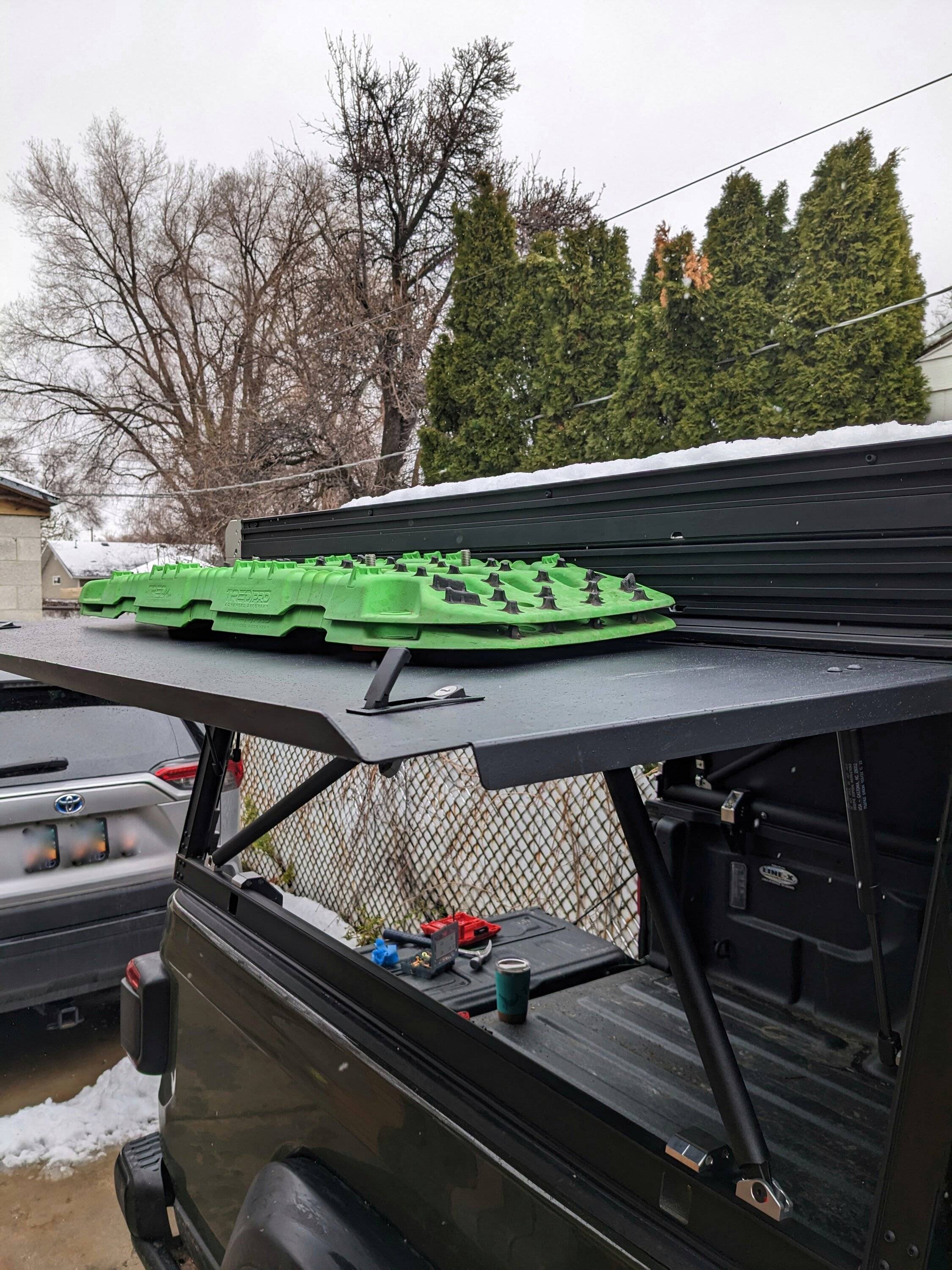

So I needed to put my tred recovery boards somewhere. On my last rig they lived on the roof rack. I have only used them three times since buying them back in 2017. They are definitely something I always have in the rig whenever I go out. Since I dont want to get a roof rack for the JT, I mounted them on the GFC doors.
I designed some mounts and then 3d printed them out of ASA. This is UV stable and has similar properties to ABS. I used a 40% infill. Hopefully I don't need to re print at a higher infill setting. I guess that's the purpose of rapid prototyping.
I first used some masking tape to figure out where the bracing of the GFC was. I obviously didn't want to hit one of those stiffeners.
I installed some 3/8-16 riv nuts in the GFC panel. The tred boards are heavy, so I had to put the mounts closer to the hinges in order for the gas struts to hold up the doors.

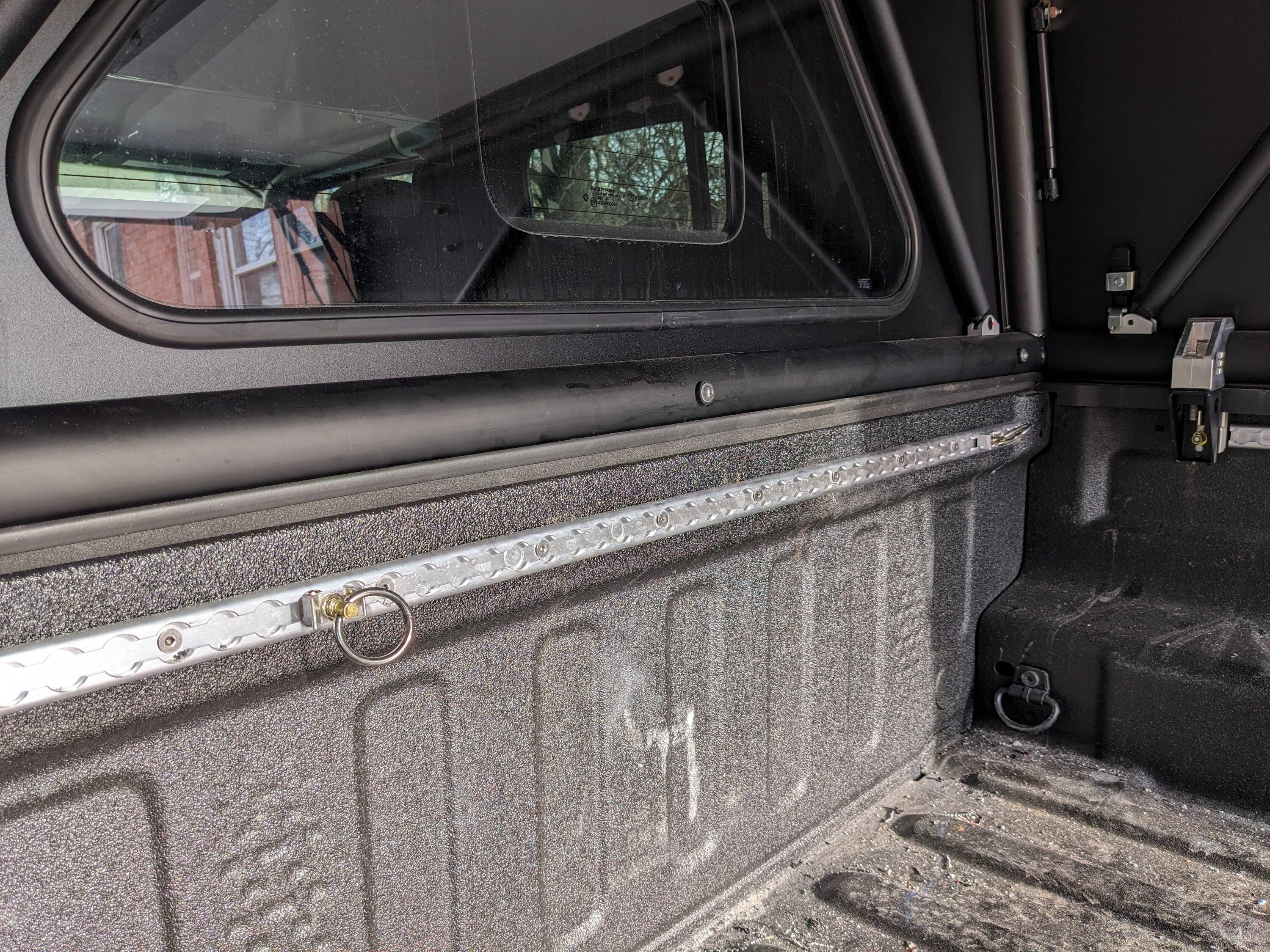

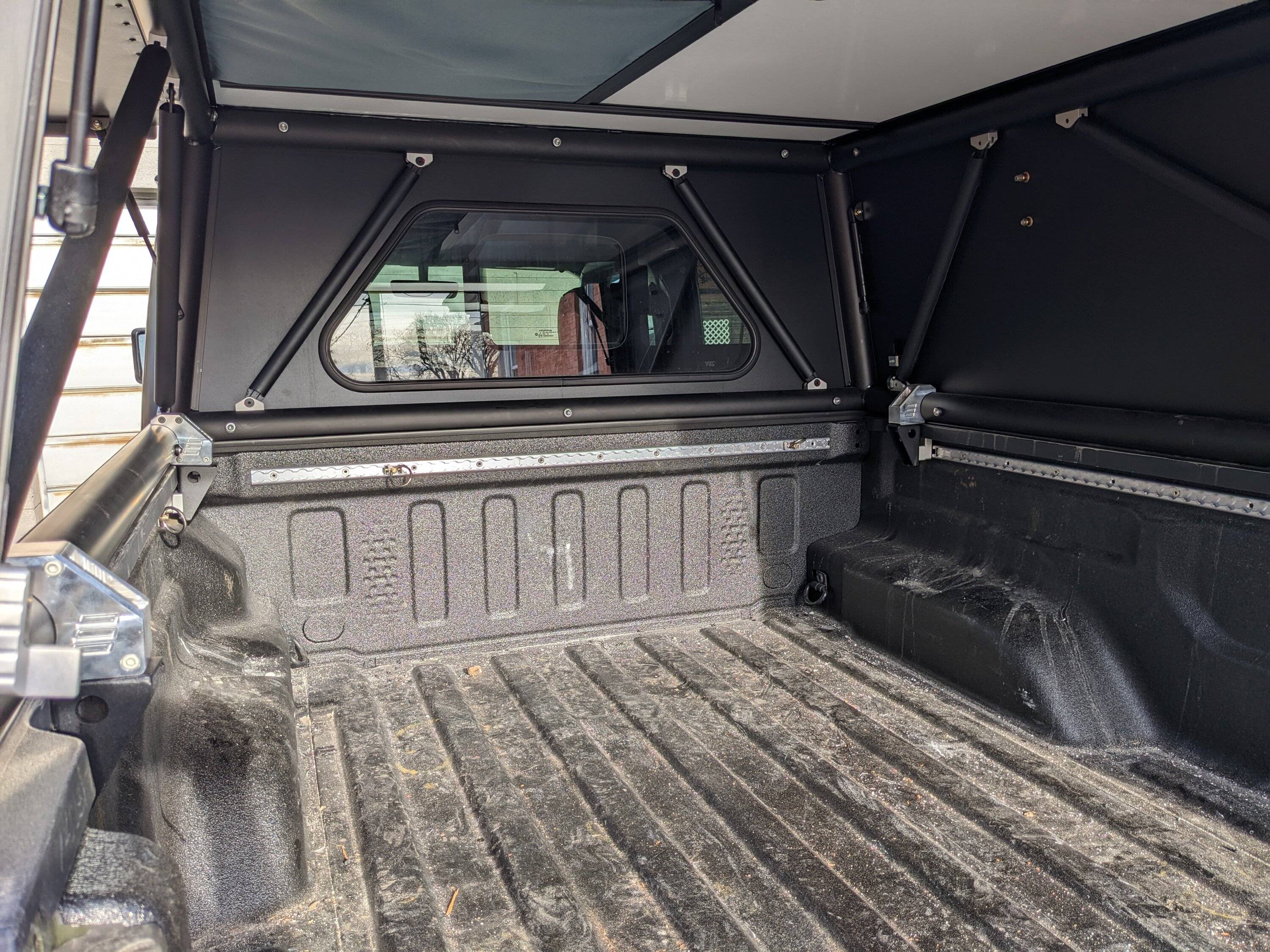

I sold my teraflex bed rails and needed a new tie down solution. I bought some L-track from uscargocontrol.com and then used some Riv-nuts to install the track. I ran out of 1/4-20 rivnuts so I am missing some fasteners in the side of the bed. Ill have to order some. I also have the wrong counter sunk angle on the screw heads. So Ill have to buy different 1/4-20 screws.
I had l-track in my tacoma and it was probably one of the best mods I did to it. The only difference was that I had the L-track in the bottom of the bed instead of on the sides. I might eventually add some to the bottom of the bed.

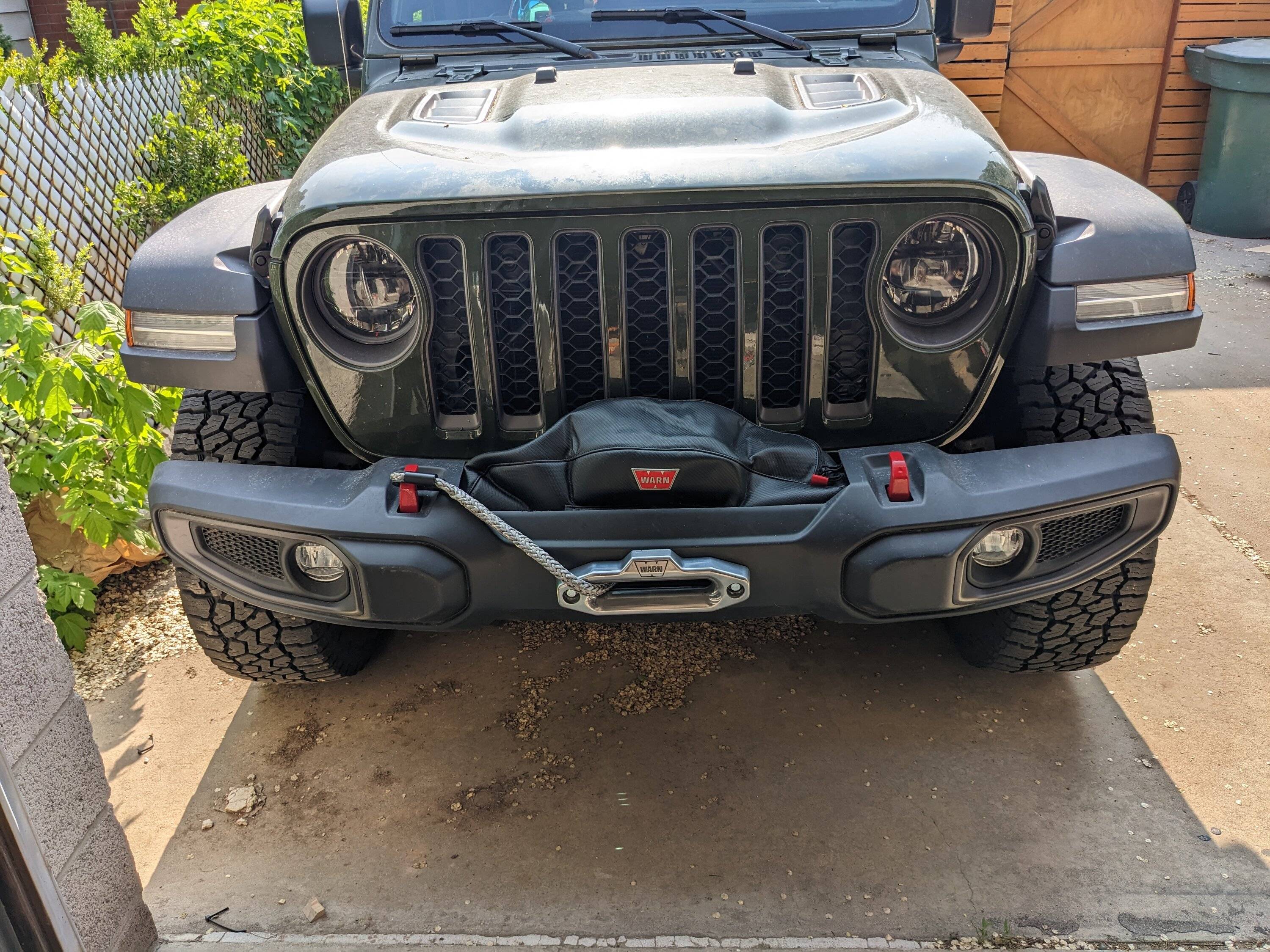

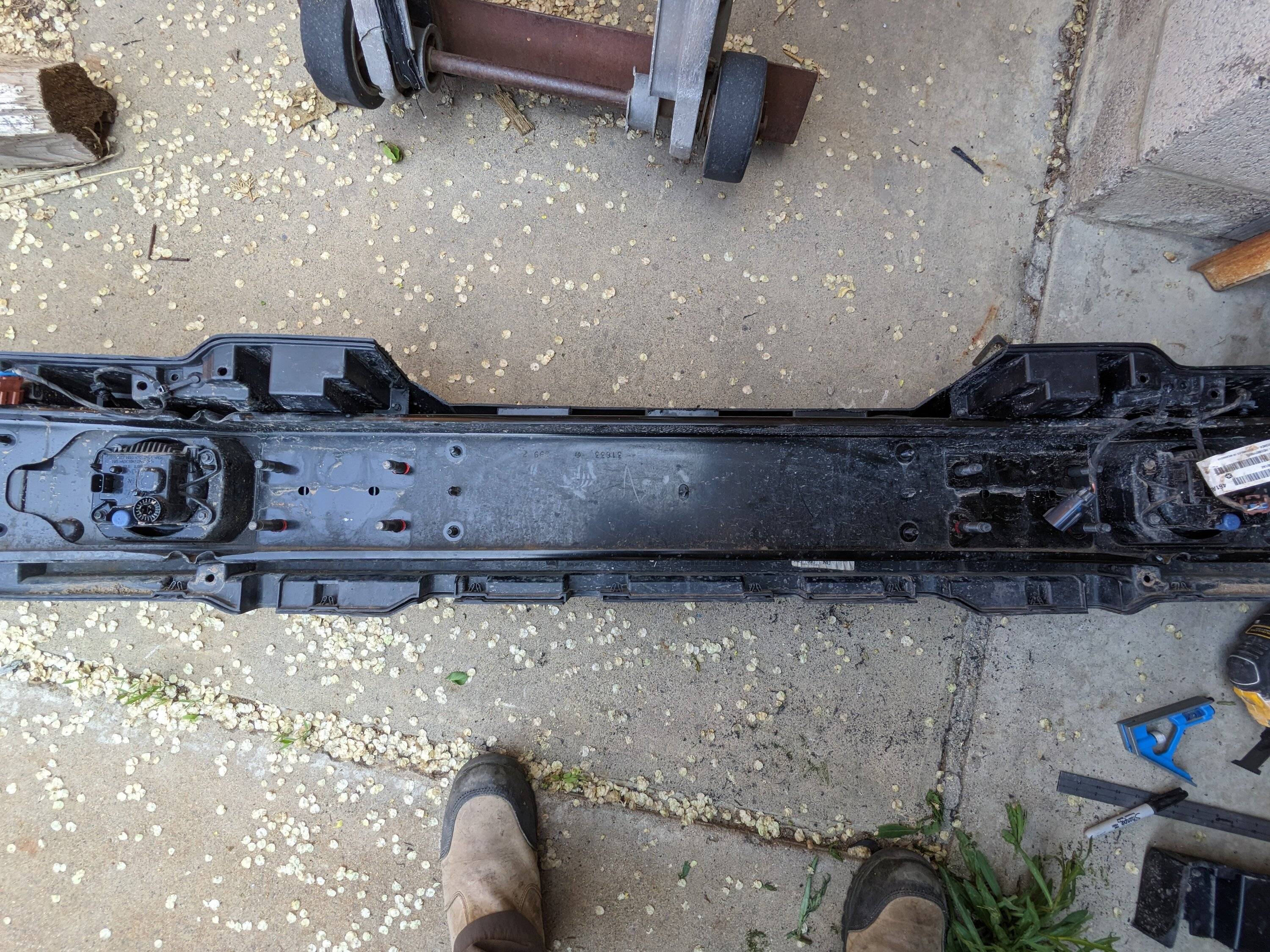

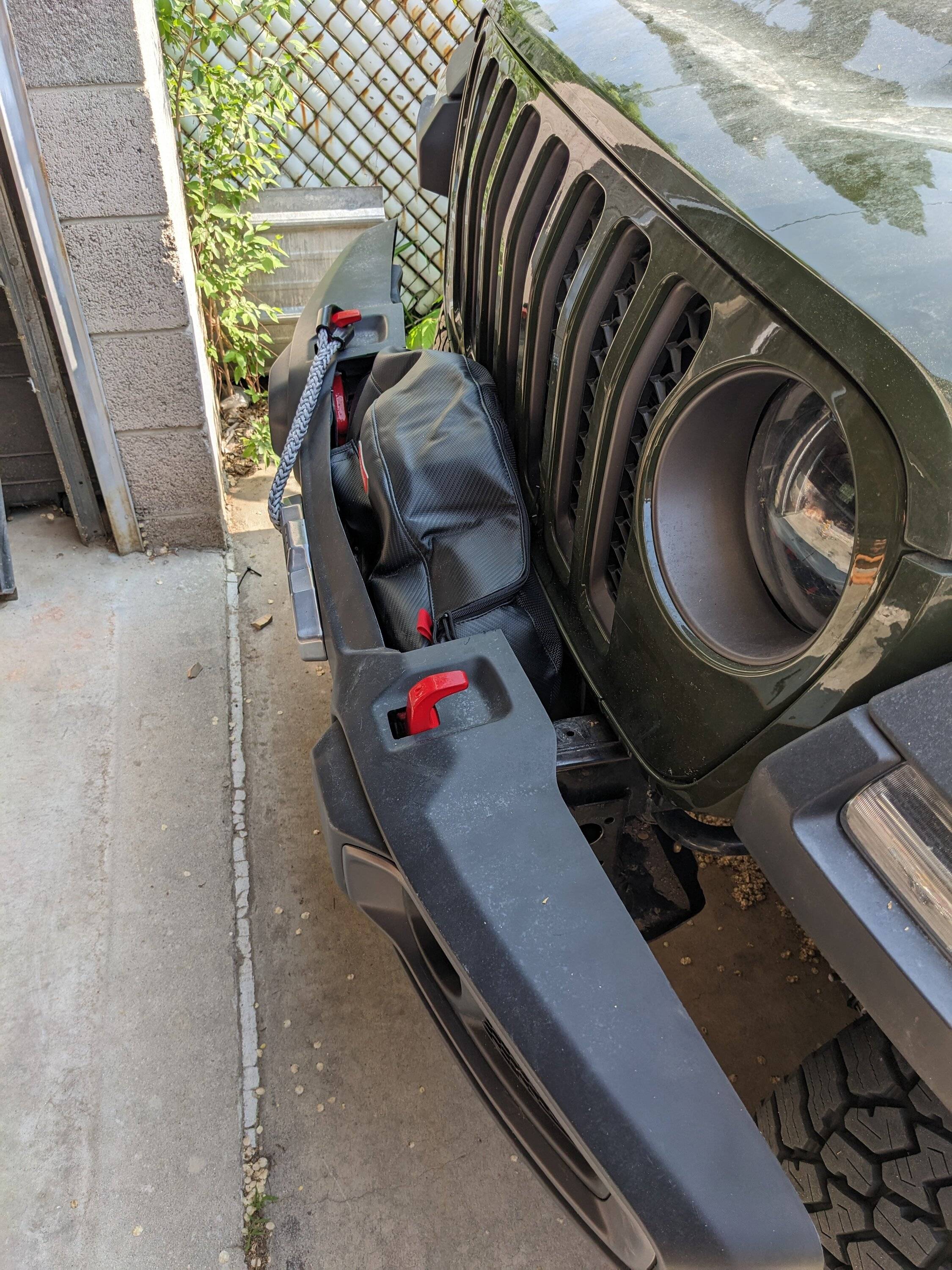

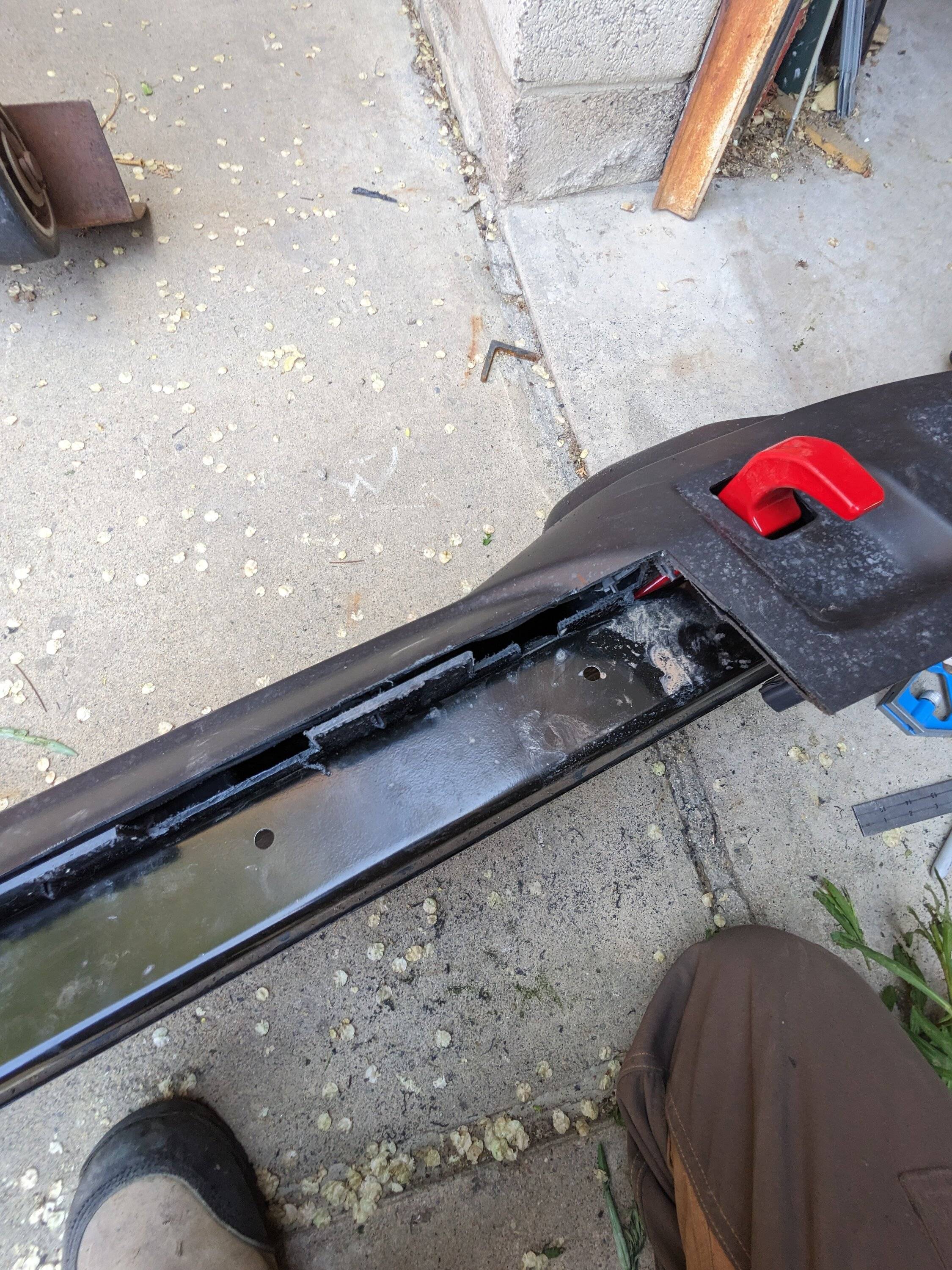

So I jumped on the winch in plastic bumper bandwagon.

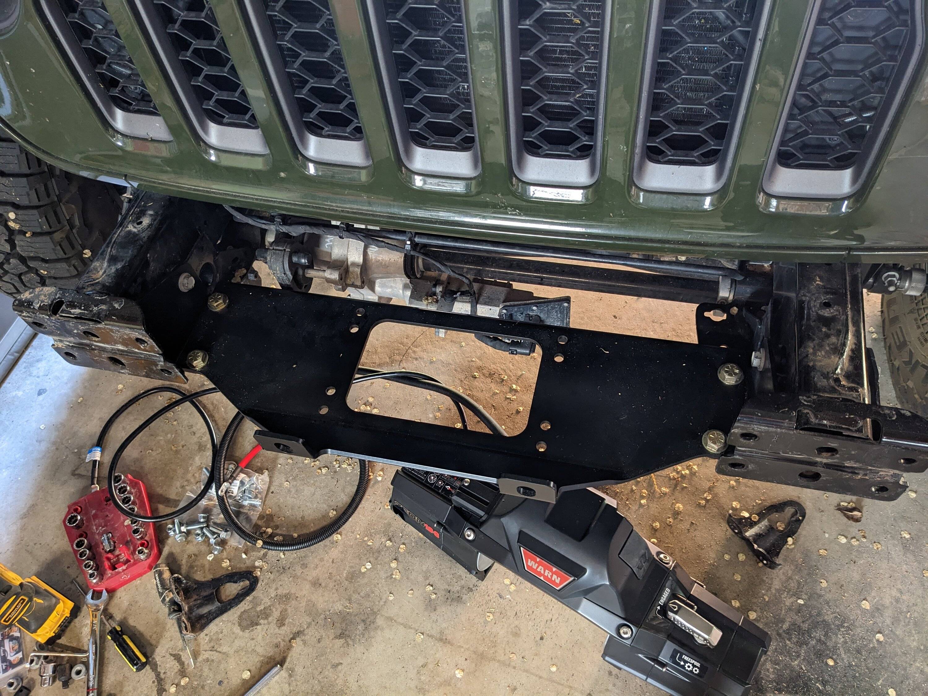

Got a Rock Jock winch plate, warn zeon 12s and went to town cutting.
I have had warn products in the past and have never had issues with reliability.
I figured I would try this before spending $1200 on a factory steel bumper. I do like the stock look.

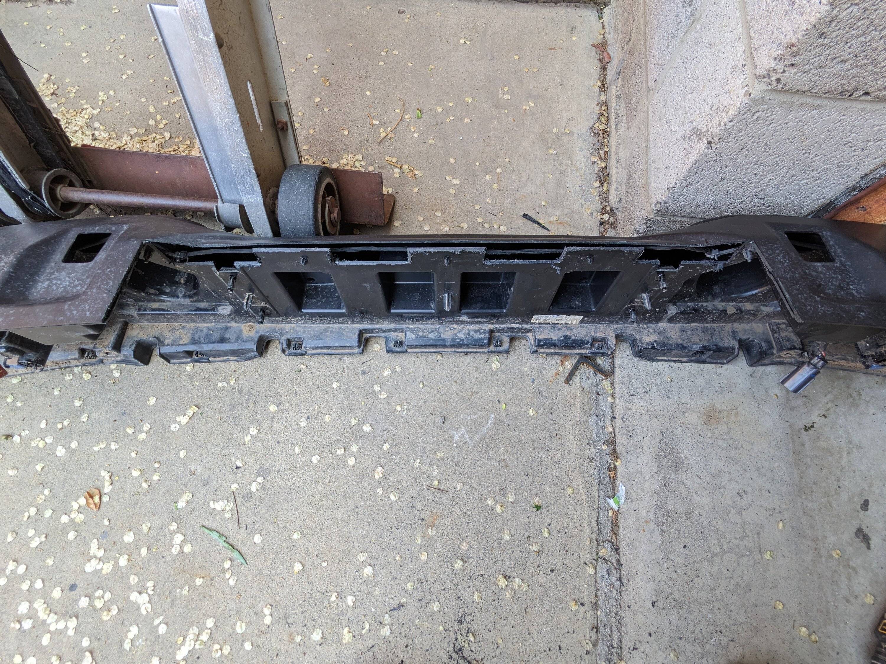

The process took about 8 hours from start to finish. First remove the stock bumper and get the winch plate mounted.

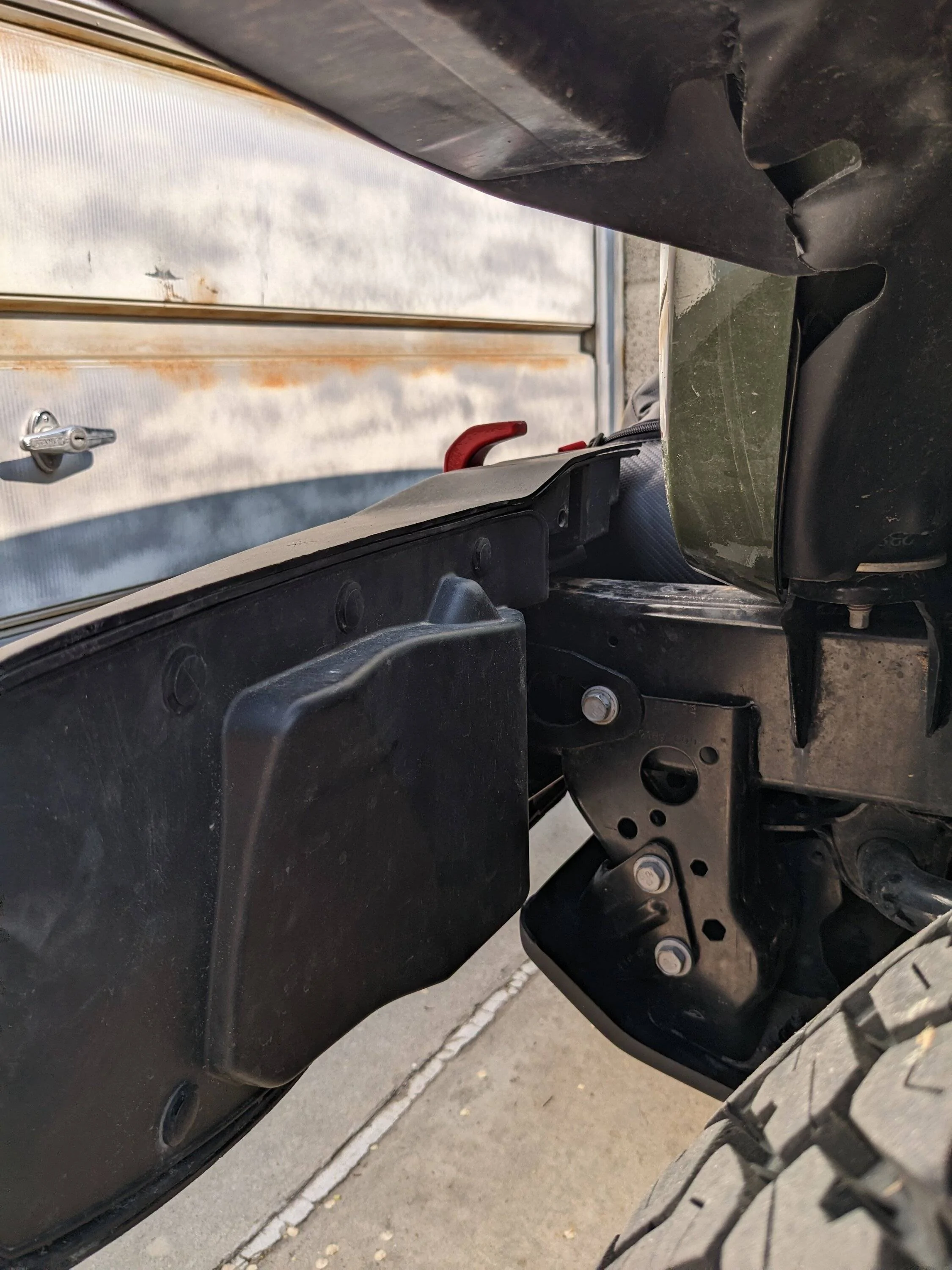

I then took a lot of measurements and cut the stock plastic outer shell of the bumper. As others have done, the stock bumper consists of three separate parts.
I then systematically cut what I needed. I tried to save a lot of the center metal portion of the stock bumper, but it didn't make sense with how much material was left over.
After cutting all the plastic, I cleaned up the edges with a palm sander and threw some paint on the cut metal portions.
I cut the fairlead pocket last.
