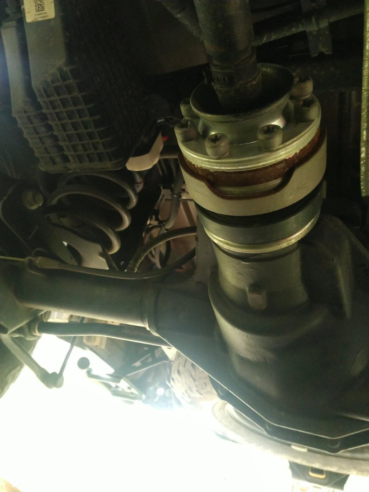

The pinion is "the about the drive shaft attaches to the axle. It will have a circular ring about 6 inches in diameter on it on the left back side of axle (front) or center of rear axle facing forward in middle.

Thanks very much. Just so that I know I am good, I see, going from the axle sIde towards the front a silver ring around a quarter of an inch wide then a black ring about an inch wide then a gap and then a silver sort of housing about 4 to 6 inches wide into which the drive shaft appears to go. Is this last wide silver thing the place I should put my jack? Thanks again.

I re read the original post. I think I am supposed to put the jack behind (toward the rear of the vehicle) of the pinion (the 4 to 6 inch wide silver part), jack it up a little, and then push up on the pumpkin.

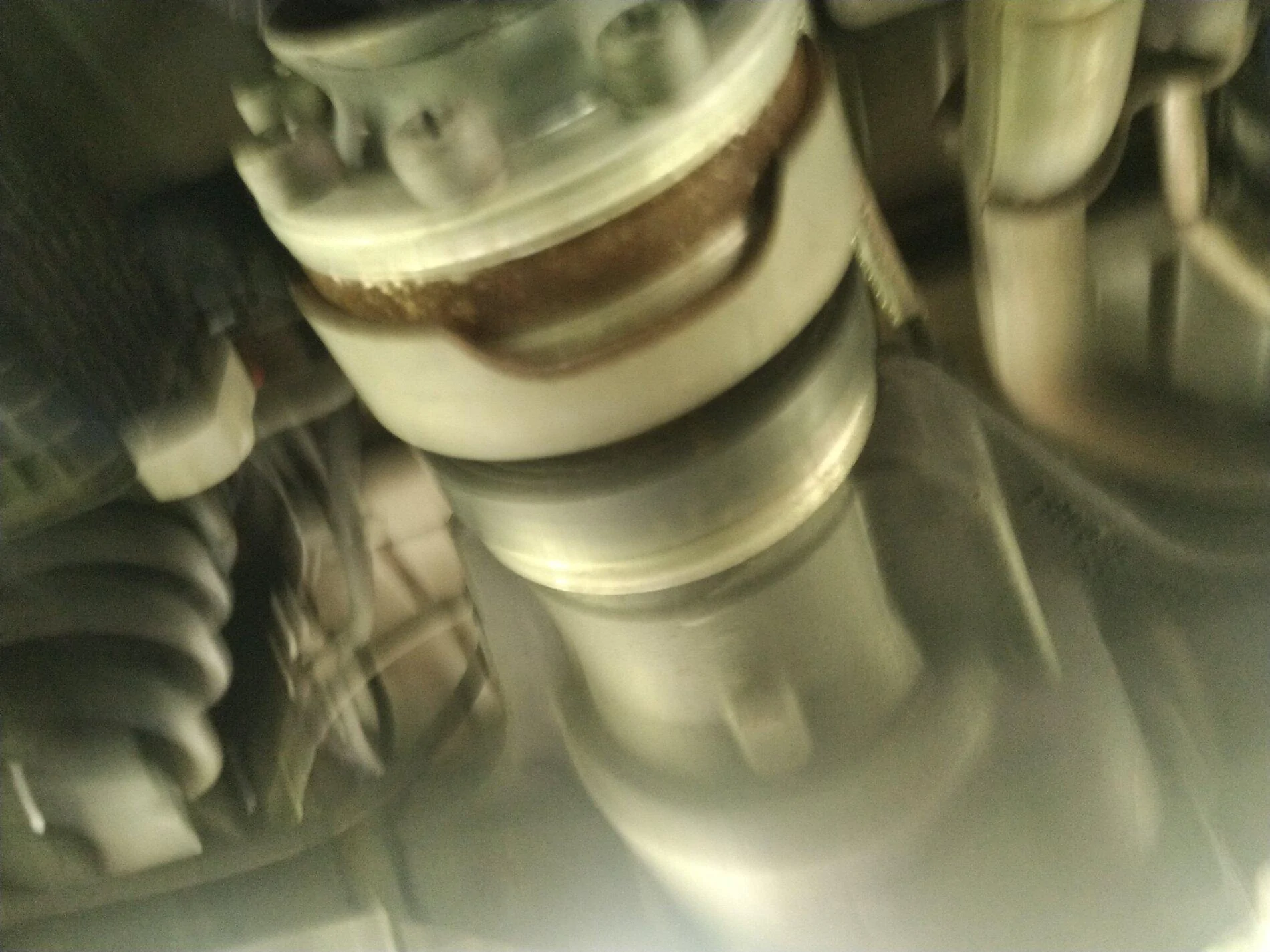

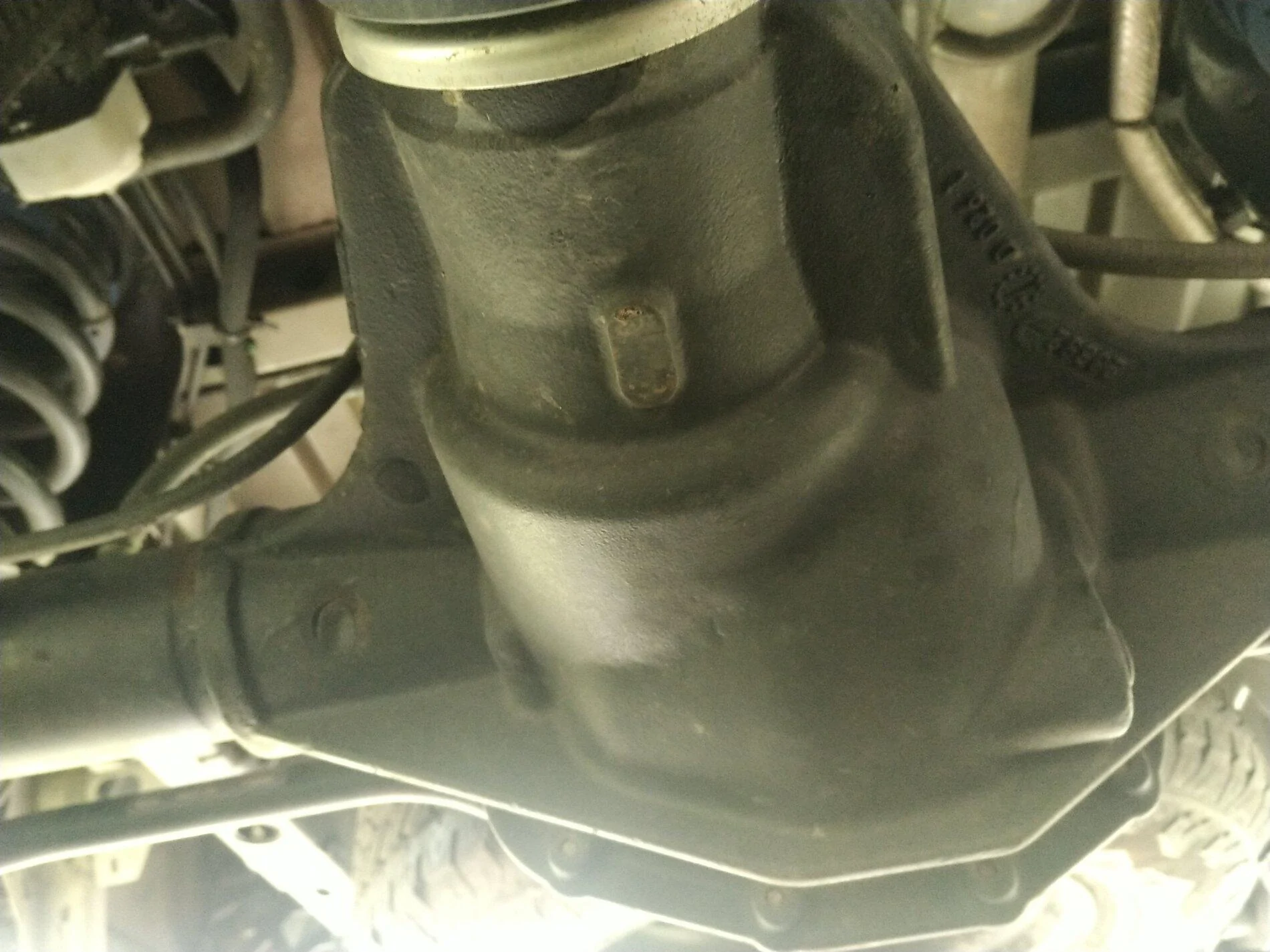

Here is a picture's of the pinion end of axle. The round "thing" is the driveshaft end. Sorry about not being earlier but I was driving home from work and then installing corner guards.
