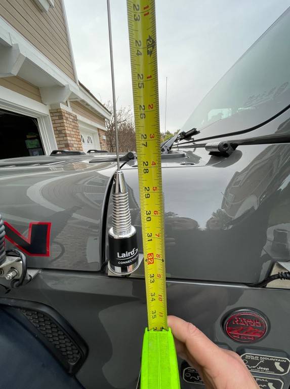

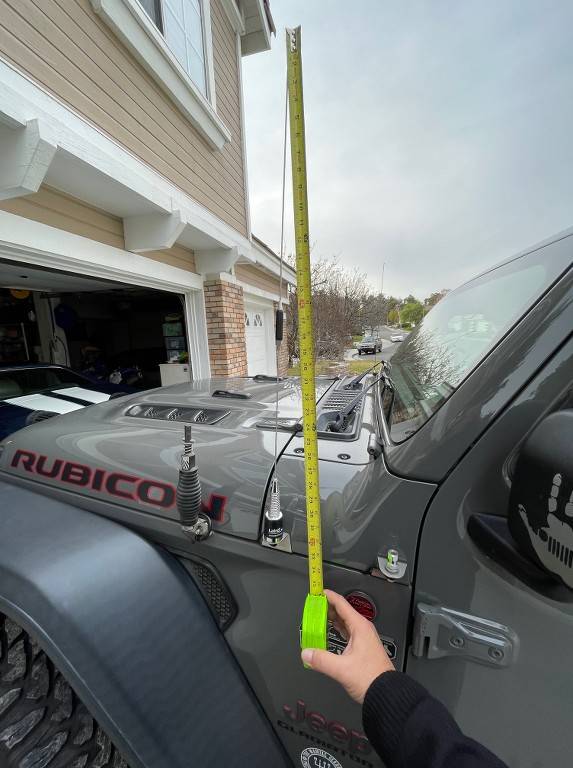

Not sure if your still following this thread but I was hoping you could measure the OVERALL length of your Laird antenna. It seems I overlooked the fact that Laird only specifies the whip length and not the overall length of their antennas. You would think that the overall length would be more important for customers trying to fit an antenna equipped vehicle in their garage or a parking deck. I figured I'll have about 36-37" of clearance using the Cooltech mount. Thanks!

I am no radio guru but isn't that tape measure going to interfere with your signal LOL? I really appreciate your help as my concern was with Lairds advertised whip length of 31" plus the coil and spring,it would have put me over my garage limit. No worries now! In all honesty, before seeing your reply, I called Antenna Farm and the Sales guy actually sent a warehouse guy to actually measure one. Same measurement as in your pics. How's that for sustomer service? You know who I will be ordering from!

Yes the tape measure would interfere but the bright yellow paint would help the antenna be seen by other antennas, therefore improving reception.....
Anyway, the PCTEL/MAXRAD MUF-4505 series is nearly identical to the Laird in size and performance and they are available everywhere. I've used them for the last 30yrs or more for GMRS and UHF amateur.

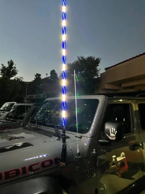

Who makes the black spring ? Been looking for one like that for my Ball mount.
That is a Gorilla Whips heavy duty spring that I use for my dirt direct offroad DDOR LED DREAM WHIP (4.5FT) 400 COLOR COMBINATION. Note: Light whips are heavy.

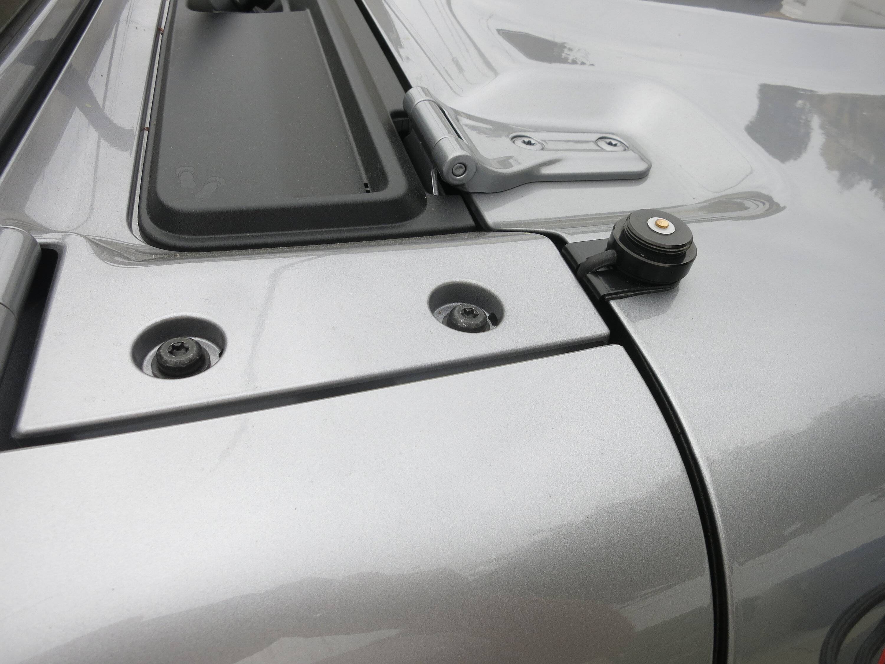

If you use a trunk lip mount on the hood near the hinges there is no drilling and the antenna sits up higher with less interference from the hood. Here is a big Larsen dual band amateur 2m/70cm on my hood mount.
Here's my Midland lip mount before being sent back.

Here is my Laird mount which is typical of other brands I've used and they sit very flat on the hood or trunk and are very strong. The midland looks like its tilted up or maybe it got bent?
I have Laird hood mounts on both sides of the truck plus an NMO on the top bed rail below the rear window and a universal HF/VHF/UHF mount on a rear bed wall above a rear tire.

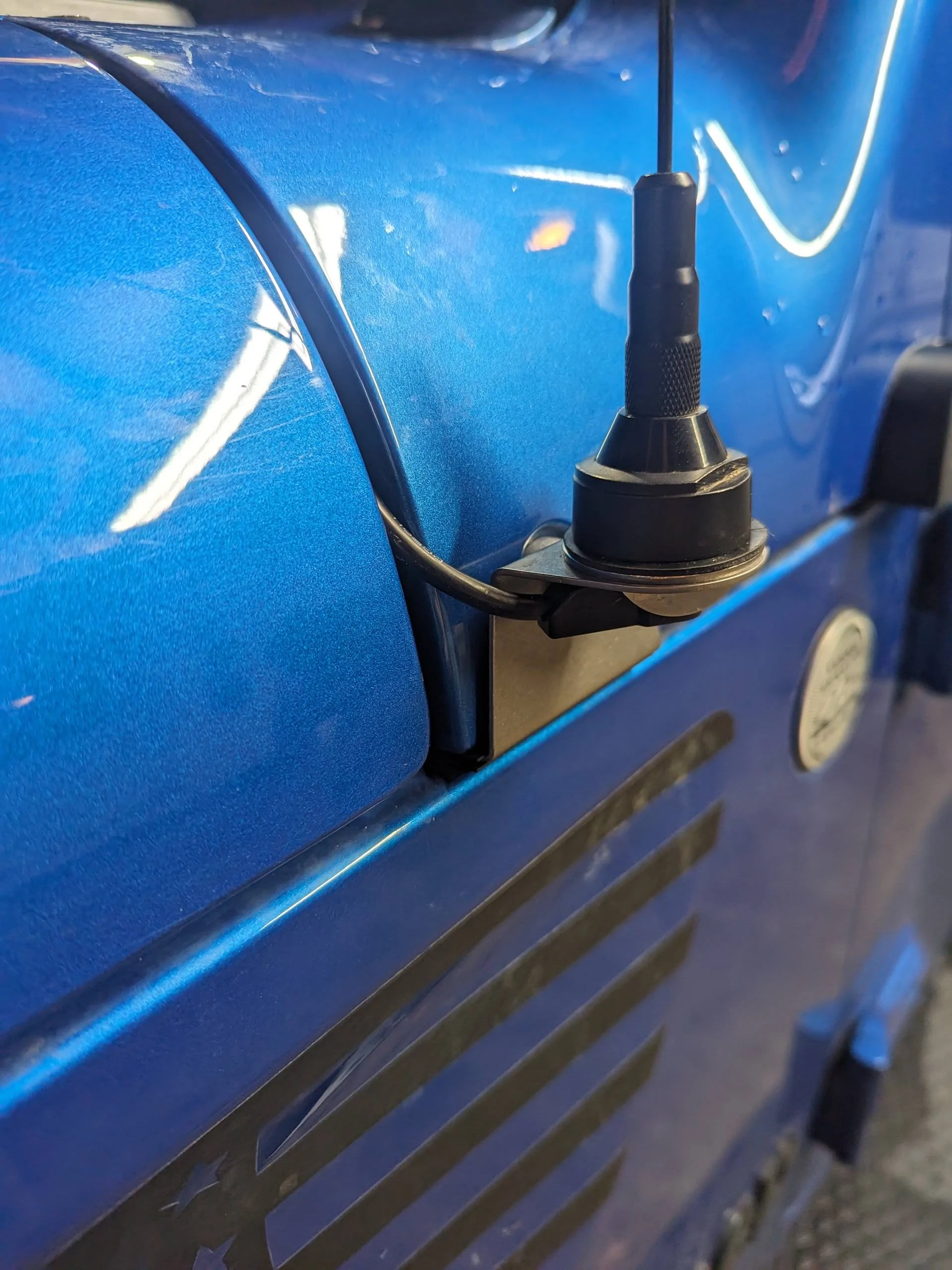

I went with a simple bumper mount. Took a bolt out and stuck the antenna in. I use two antennas: short for daily/close use or weather radio and long for off-road or when I need distance.
What type of system are you using, that doesn't look like a GMRS antenna. Also, do you see any performance loss by it being mounted on the lowest possible position on the vehicle ?(usually, the higher the better).
That is a terrible thing to do to an antenna. And yes it will suffer some degradation mounted low on the bumper.
For my CB I use two antennas. The one mounted is short, reaches a little above the hood. The second is a much longer firestik antenna with a spring.
The short antenna is greatly degrading as the Jeep blocks most of it. I have no issue getting the wx and is good for around town when I don’t want the large one. The long antenna works fine for communication.
