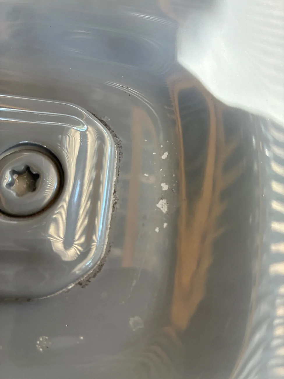

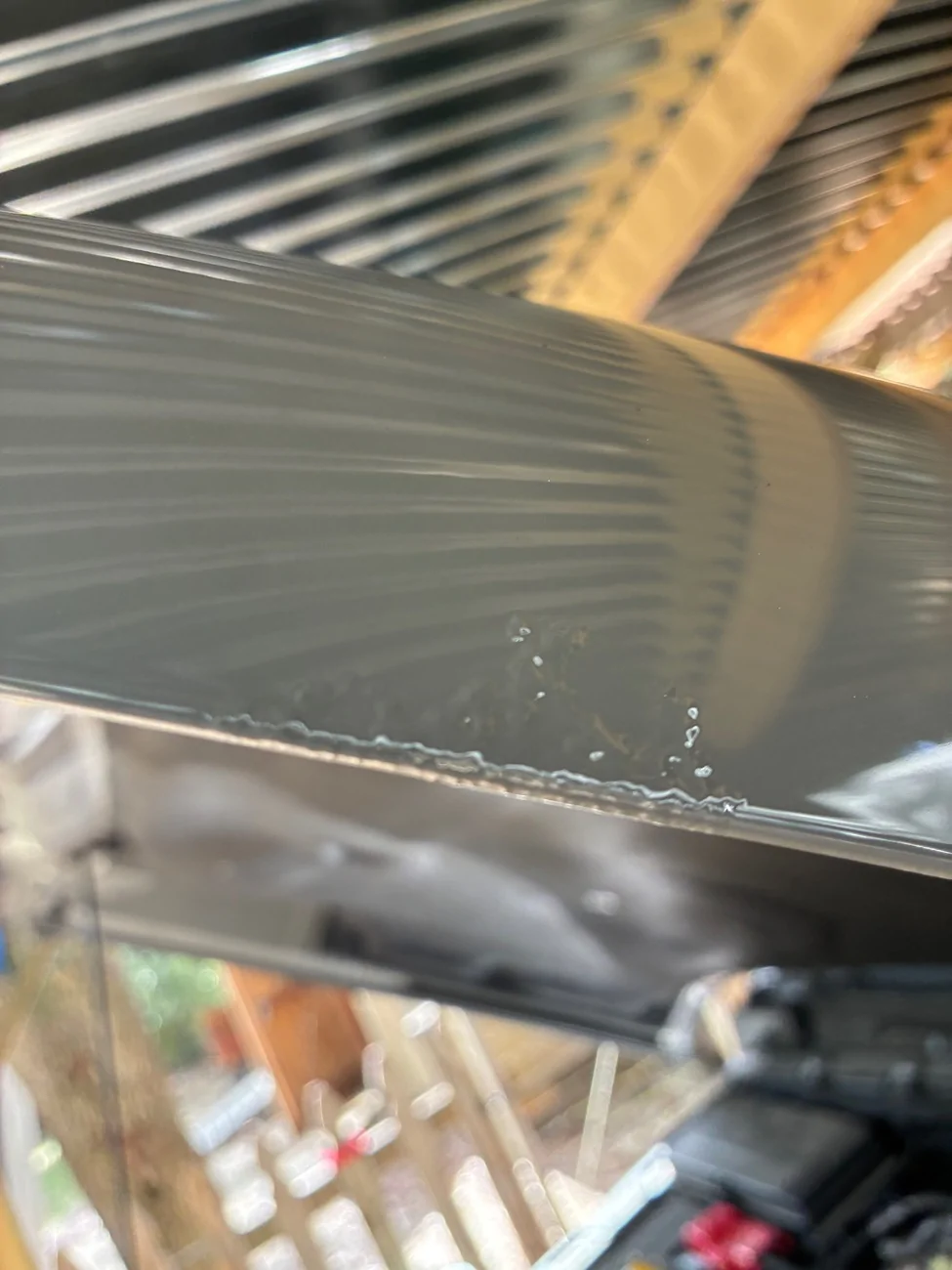

Waiting on approval to have my new to me 2022 Willys 45k miles hood repainted. Tiny spot just behind the drivers side hood latch and pitting near the passenger side hood hinge well. Local dealer doesn’t have body shop, quick stop there to document with service advisor, then off to recommend body shop for more documentation and consult. Back to dealer with quite and submit claim. Body shop has done several and is sure it will be approved for full hood repaint.
Jeep Gladiator Corrosive warranty on Gladiator IMG_1511
Jeep Gladiator Corrosive warranty on Gladiator IMG_1494

When it comes to the paint warranty, make sure they inspect "Everything"!! I had the same small bubbling on the hood. When I took it in they inspected the entire vehicle. Under the door by all the welds, door hinges, lower tailgate welds, etc... I went from a hood replacement too all 4 doors and a tailgate. If you don't know where and what to look for you will definitely miss it. Just an FYI

Sadly, the bare aluminum hood develops a thin oxide layer almost immediately after being exposed to air. When the panel wasn't properly cleaned, chemically treated, and primed with the correct etching or epoxy primer, the paint may not bond well. Over time, the paint lifts and forms blisters.
This is also why Jeep is switching from aluminum hoods back to steel.
