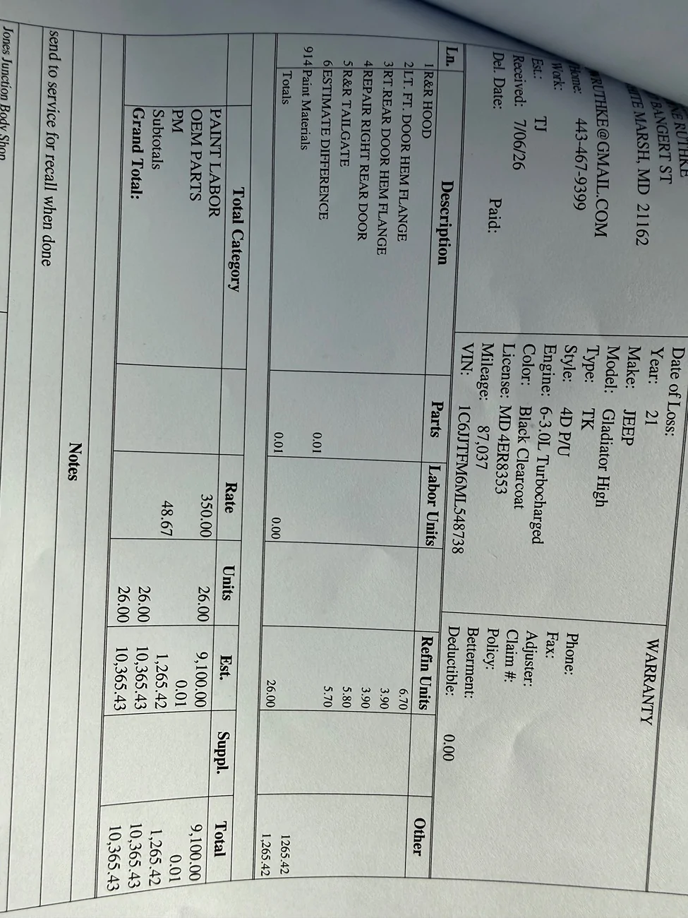

Just got mine back from the dealer who self performed the repair. Be forewarned, the new hood is no longer aluminum and weighs a ton. I’d be inclined to ask if they can do an aftermarket hood. It’s incredible how much heavier the hood is and now the lift spring doesn’t lift it at all.
Do you have the part # of the hood you got?
I got part #68766102AA and it’s a heavy as hell steel hood. Just repaired June 2026.
Your post made me check. Thanks for mentioning this.
