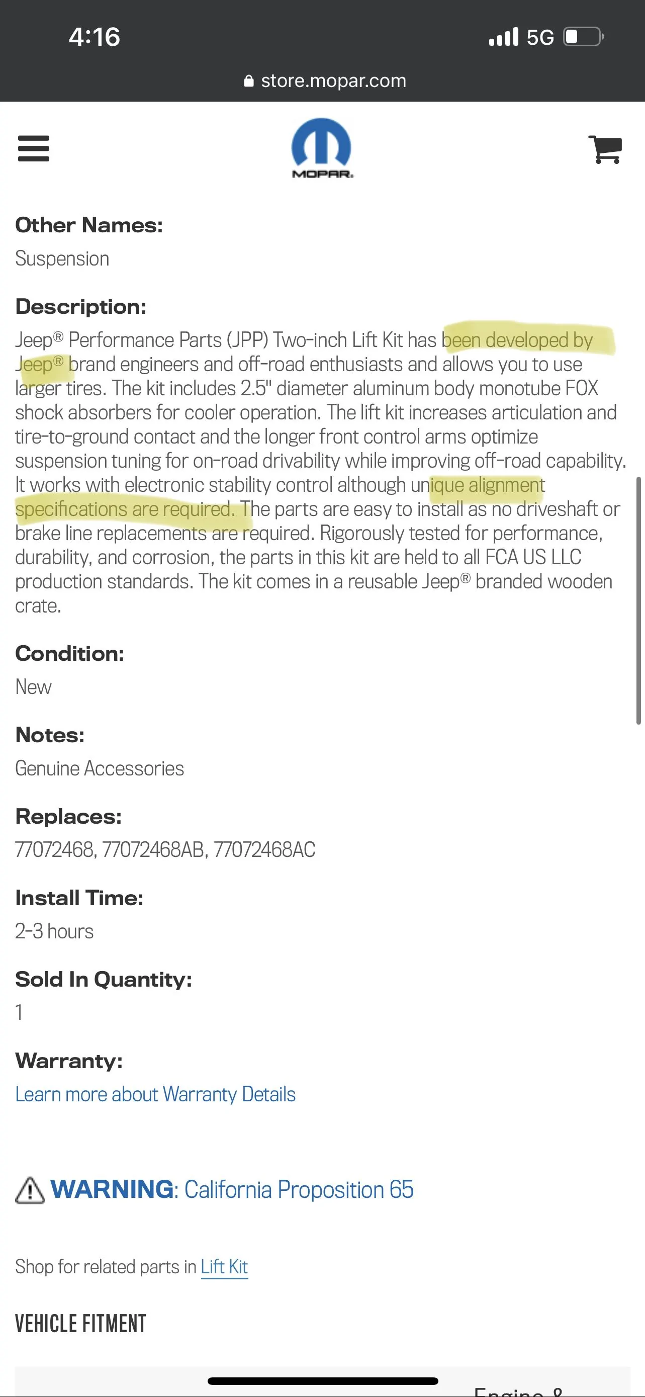

Complete fn idiots. Their manager tried to bully me into accepting their fix because allegedly I didn’t say it wasn’t 100% stock it has the mopar lift and I cussed this mofo out on the phone for 45 minutes saying it’s got a factory part number installed by a factory approved “trained” technician so yeah it’s “stock” basically told him my prior history with vehicles “used to work on multiple high end cars in; nascar, Ferrari challenge, Porsche GT3 cup, ALMS, Grand Am and quoted directly from jeep and this dumbass was like well we have high success rate with this bracket…. And I lost it like it does not belong on that kit.
Did you install the Mopar longer control arms? Those should have corrected the caster after the lift.

A Mopar lift is not stock. You cussed a guy out because they want to further modify your already modified vehicle to correct the geometry? Real classy.
It is not stock. Where the lift kit came from, part numbers, who installed it, is inconsequential. It's modified from it's original configuration.
Those Mopar lifts are trash. They do nothing to correct the geometry. I would take that crap off and buy a real lift with adjustable control arms, front track bar and at least a rear track bar correction bracket. Get all of the geometry back in spec.

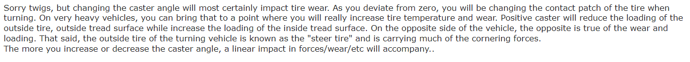

Yeah, too much caster is a problem. People seem to think "gee, a little bit helped my wander, I'll give it more" and then they introduce other issues.
I see people talking about 6 degree caster - that's the bleeding edge of trouble.
Mine was lifted about 1.25" and the caster was under 5 and it tracked and handled like a dream. It didn't wander, on a flat road without wind you could let go of the wheel for a long ways and it would keep between the lines. No way I'd have ever put more than 5 degrees caster on that truck.
Toe can impact handling, and too much caster combined with incorrect toe (for YOUR vehicle) can cause poor handling and actually in that case, caster can contribute to tire wear. Caster is generally not associated with tire wear, but if it's too far and other settings are wrong as well, the combination does wear tires.
A positive caster of 5.5 - 6.0 drives great on these things.
That's a blanket statement that doesn't work for all.
Each lift, each set of conditions will mean different settings will be "best" for "that truck". I've done alignments for decades - and one reason there are ranges in specs is because conditions can vary - tires, tire sizes, a lot of things enter into it.
6 is bleeding edge and can introduce instability.

Yesterday I mentioned "caster wobble"- well, the guys who believe "more caster is better" may be causing their own death wobble. Again, I've done alignments since before IBM even made a PC, before there was an alignment computer.
Jeep Gladiator Cough death wobble, cough. 2021 overland 13k miles 1659277169468
Jeep Gladiator Cough death wobble, cough. 2021 overland 13k miles 1659277518124
Gee, does THAT sound familiar???
Too much caster can lead to loss of traction for steering and braking around curves and corners, too. I was going to write it up, I have all the info in my college books, but I ran across a Ford guy who agreed with my college texts (I spent a college quarter in alignment)
