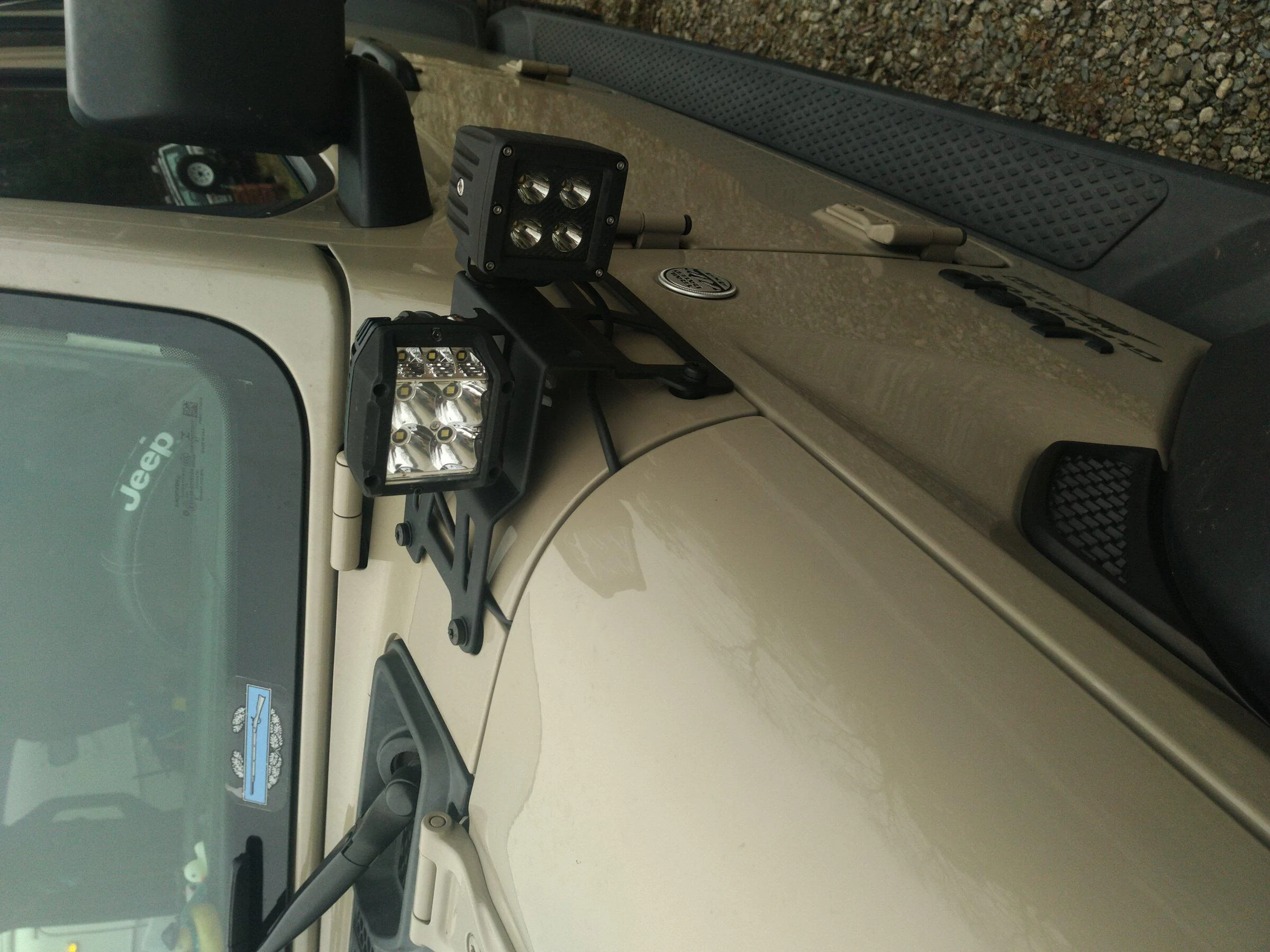

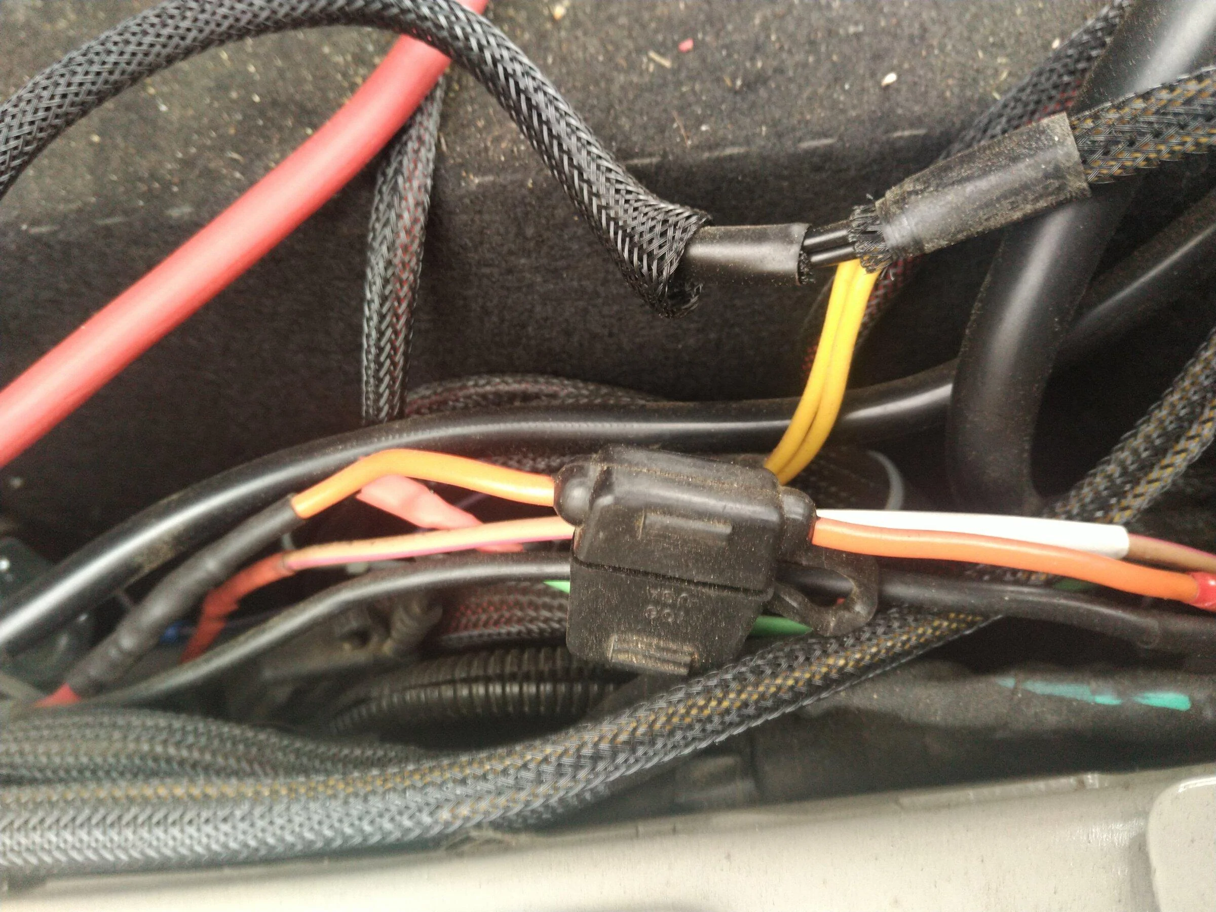

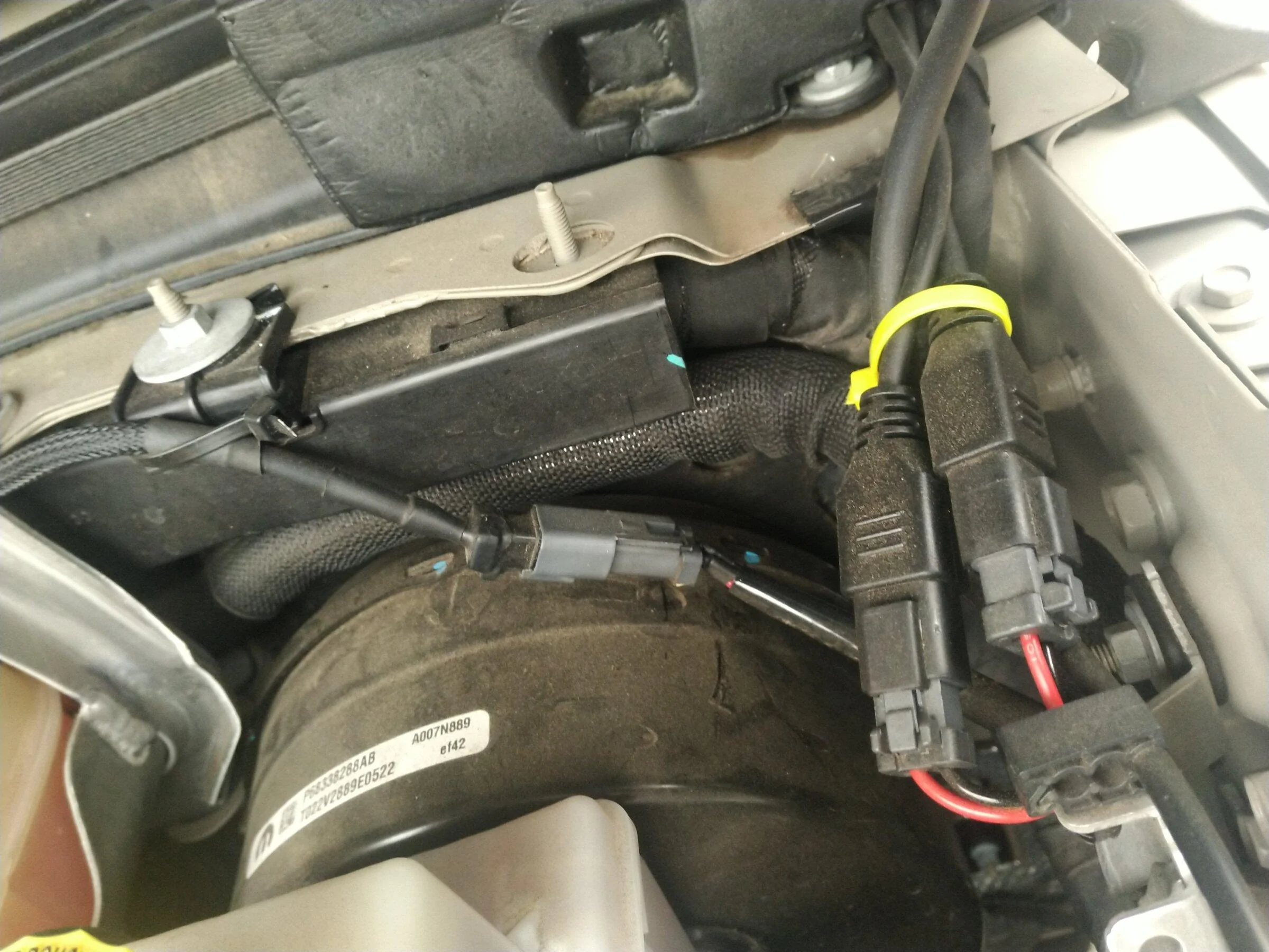

I'll try to send a pic or so give me a few minutes.
Jeep Gladiator Cowl Light Wiring Assistance IMG_20211217_130333
Jeep Gladiator Cowl Light Wiring Assistance IMG_20211217_130432
Jeep Gladiator Cowl Light Wiring Assistance IMG_20211217_130458
The wire loom running across the back is for the lights. You can run the light's straight from the AUX switch wires but I do recommend a fuze on the lights at that connection.
