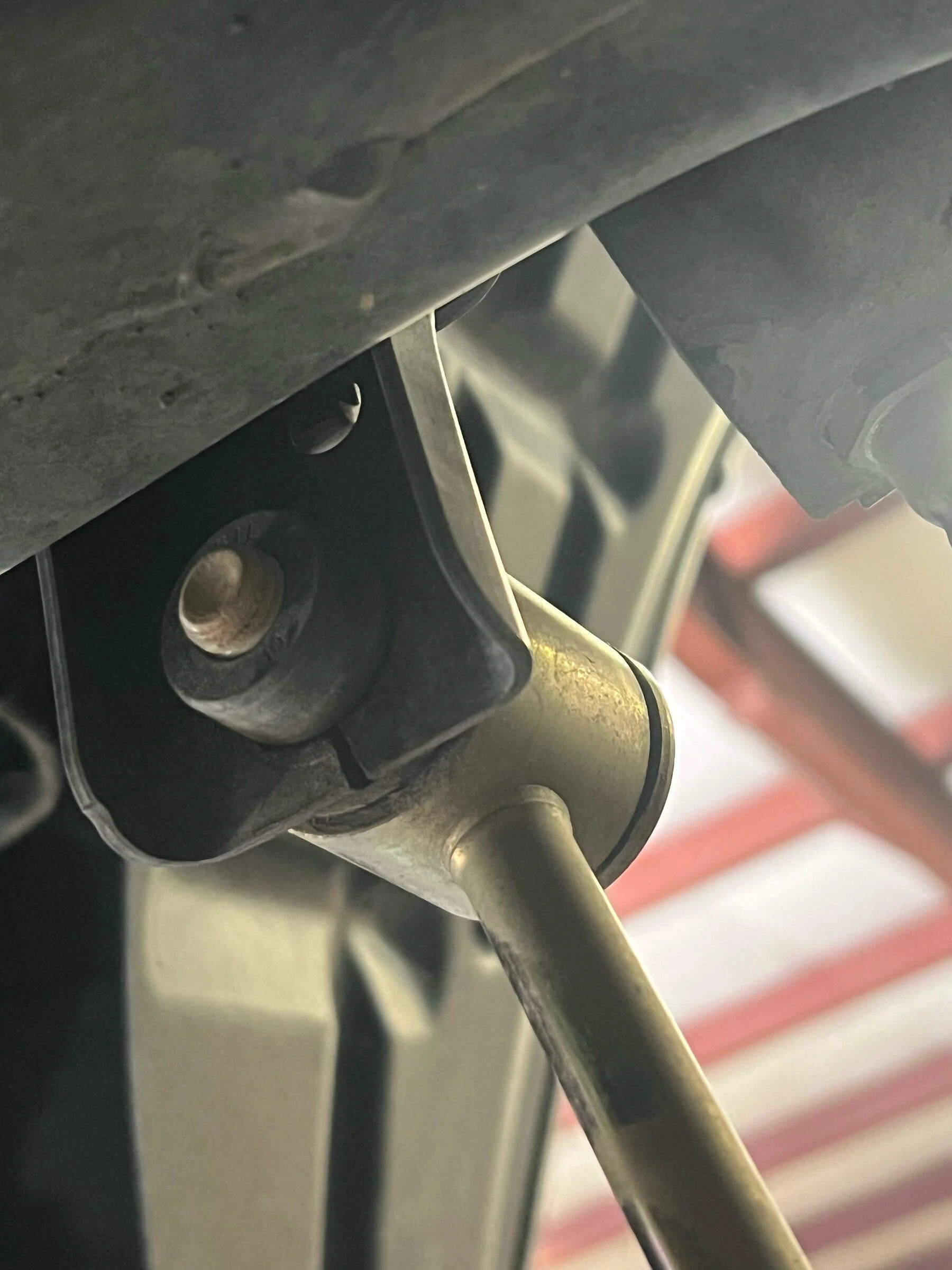

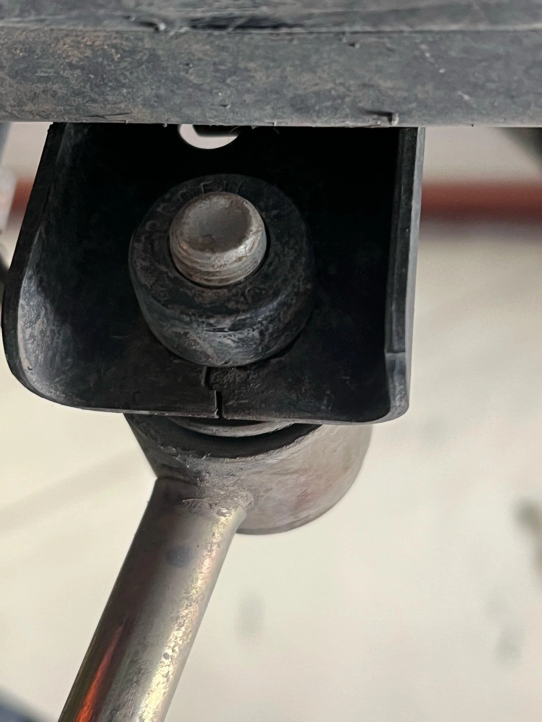

Cracked both rear sway bar end link mounts. Back plate? Weld?

Wow! well that's interesting... how did hat even happen? Maybe the bracket was already fatigued? Did you hit a rock on the bottom side of the link?

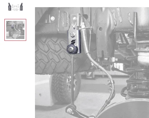

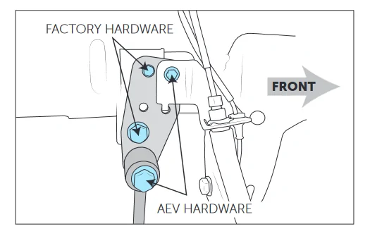

The Metalcloak brace only supports the original mounting point for the link, the AEV bracket drops the mounting point about 1 1/2" lower. I'm thinking of just going Clayton links in the original mounting point, keeping the AEV bracket (cut off the ragged edge) for the added thickness at that weak point.

You could do longer arms if you wanted metalcloak. I would suggest calling AEV - they might warranty it. It's only a 20 dollar part I bet anyway. Mine have been just fine, although I have not done any hard core 4x4 trails yet. Personally I'm working to figure a way to make an electrical rear sway disco rather than opt for any of the other options.

I do plan on calling AEV in the morning. Part of the bracket moves the brake line and sensor wires closer to the axle to compensate for the lift. I'm thinking a heavier duty set-up would be preferable, as I do moderate wheeling.

I noticed also that the end of the link was slightly egg-shaped, so I just ordered a pair of links and a pair of brackets. With the wheeling that I do, I figured that will give me a spare set for when it happens again....
