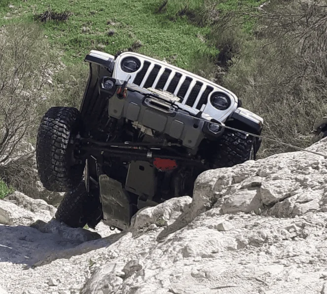

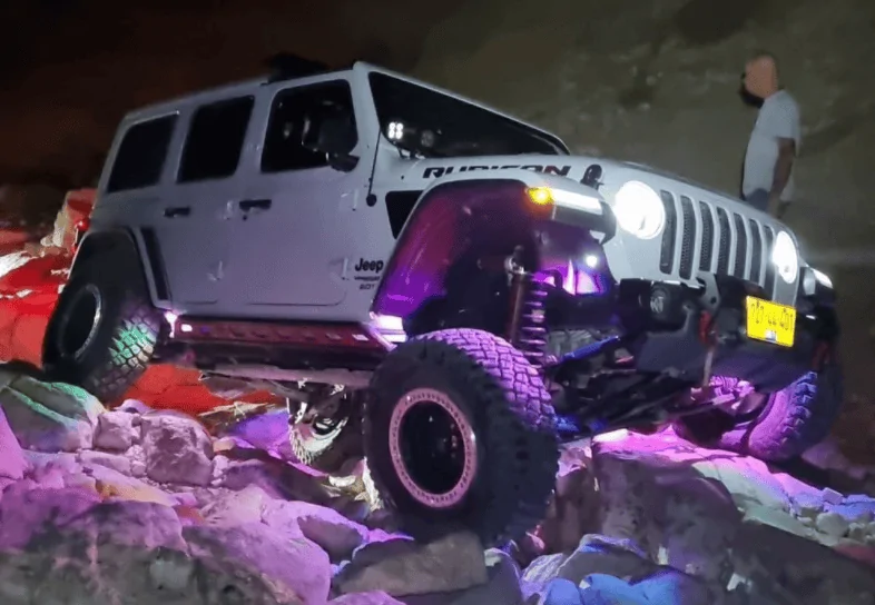

You can fully articulate the rear on these with the front level. It's how I swapped rear springs, front on the ground, had it flexed literally to the max (and then some, I disconnected the shocks)
I had one side shoved up as far as it could possibly go and the other hanging so far down it was stressing the brake line so I know these can fully articulate either end without the other end being twisted.
Here are some the opposite way -
Back sitting pretty level, front fully extended - you can do the opposite and have the rear, say one wheel up on a rock and the other down in a hole, maxed out, but the front still have both feet firmly planted - you'd be stressing those small mounting tabs a lot.

In the pics above the rear axle doesn't have much "tilt" to it, not a lot of difference. If you turned it around the front would be reasonably level, both tires on the ground but the rear left hanging.
Say if he was going down and not coming up, the front wheels would be over the rock on more even ground and one of the rears would be left hanging in the air.
I can also grab images - of the rear maxed out at the far end of shock travel and the front hardly tipped. All it takes is a rear wheel up on a rock and the other hanging over a hole but the front can be fairly level - and you have stressed those mounting tabs to the max.
