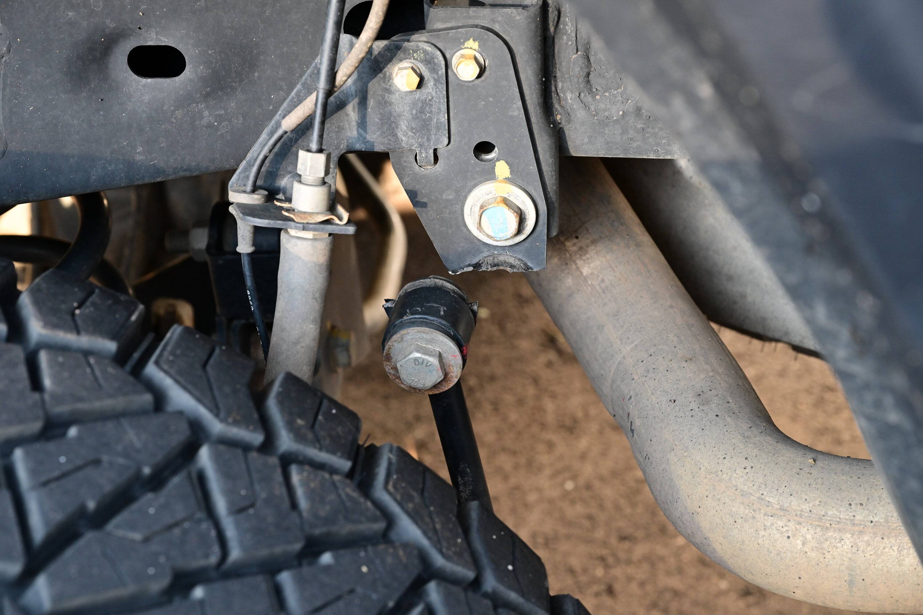

Cracked both rear sway bar end link mounts. Back plate? Weld?

I always ask are you lifted?
If so are your shocks the proper length, do you have appropriate bump stops, and do you have extended links?
That mount seems to be the fuse in the rear.
Plating it would probably help.
11,445
30,507
Yup. There's not a lot of material there, and when these things flex, no matter how the rear is flexed, when it's at limits, there are stresses that are not exactly straight down or straight up. There are angular pulls as well. The more I look - the more concerned I am about lifted Jeeps and things not being exactly right as far as shocks, and sway bar links.
That axle swings down and to the side a bit, that bushing in the stock type link is going to resist turning, and that bolt sticks out, not supported on the head end.
I can't say anything good or bad about them yet - but I do wonder - since these frames and perhaps some other structural pieces, are high strength steel, and knowing that high strength steel is a different formulation and needs DIFFERENT welding materials and techniques - any thoughts as to if that's playing a role anywhere?
One of the things I was thinking about. Is removing the threaded insert. Then welding in a block of 1/2" steel that has a threaded hole. Or making a double shear mount. The other thing I can't figure out. Why did they use that type of end instead of a ball joint.
If the frame is like a Power Wagon frame. The frame was heat treated after welding.
40,500
54,019
I have no idea why they didn't use a ball type joint....... it makes little sense unless they figured the rear would be more stable in movement - wrong.
This is a different steel used in these even before any heat treating. They are a low carbon steel and will fracture more easily once they reach that point.
High strength steel like these frames use shows a reduced plastic ductility and brittle fracture compared to a lot of mild steel. It allows them to use thinner steel, a lighter frame, and still be as strong. Welding to it is different than welding to mild or other carbon steels. But it will crack more than bend once it reaches that point.

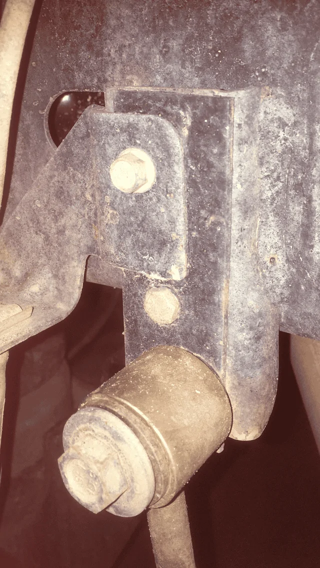

Someone asked me in one of the other threads about this for pictures of the support bracket I fabricated. I couldn’t find the old photos, but here are some new ones. Forgive me for how dirty it is. It’s winter…
Jeep Gladiator Cracked both rear sway bar end link mounts. Back plate? Weld? 2420AB6E-BF7D-4385-B913-84F7F898924E
Jeep Gladiator Cracked both rear sway bar end link mounts. Back plate? Weld? F0942828-A3BE-4039-95A5-2DBD9FAD88E4

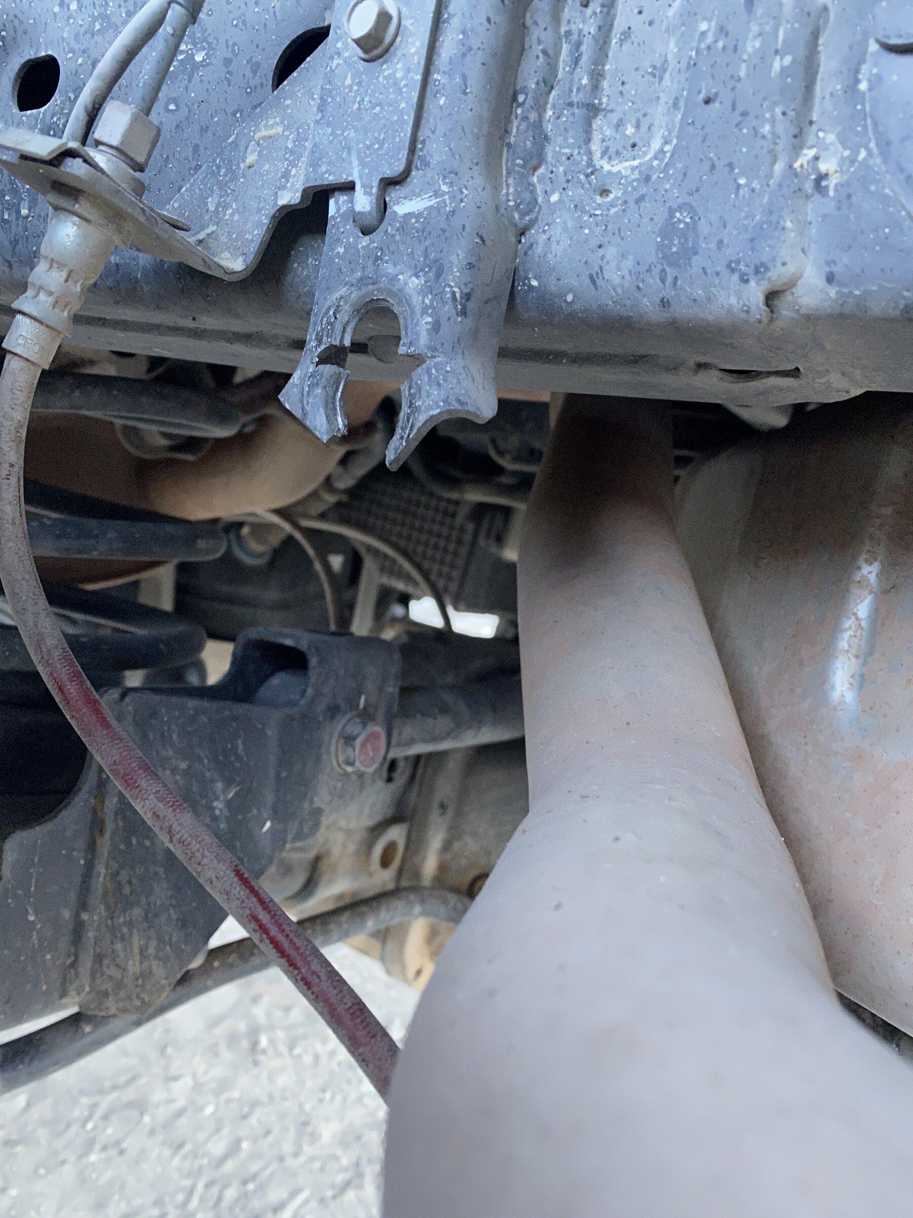

Guess I should have taken care of the crack before going on another trip...
Jeep Gladiator Cracked both rear sway bar end link mounts. Back plate? Weld? 94A50B68-95EC-471C-98EB-F523FEE66839

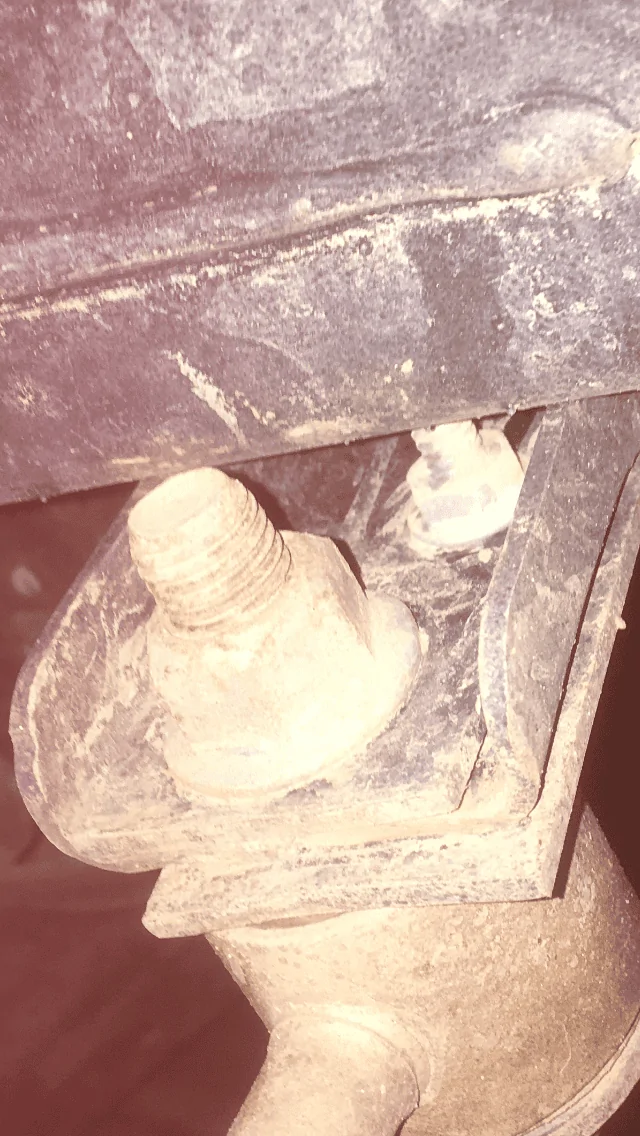

Jeep Gladiator Cracked both rear sway bar end link mounts. Back plate? Weld? 288EC302-BC90-4654-A4C7-17E09209CA4D
Sounds like Metalcloak will be coming out with a brace soon.

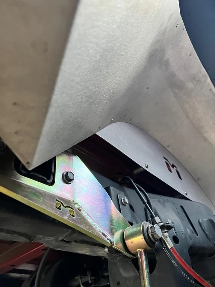

I believe this is one of the reasons why AEV used a secondary/doubler plate in this area on their DualSport lifts. Surprised there aren't more out there, it's a fairly simple design.
Just ripped my AEV bracket where the sway bar mounts....
Jeep Gladiator Cracked both rear sway bar end link mounts. Back plate? Weld? Z08_0447A
Wow! well that's interesting... how did hat even happen? Maybe the bracket was already fatigued? Did you hit a rock on the bottom side of the link?
