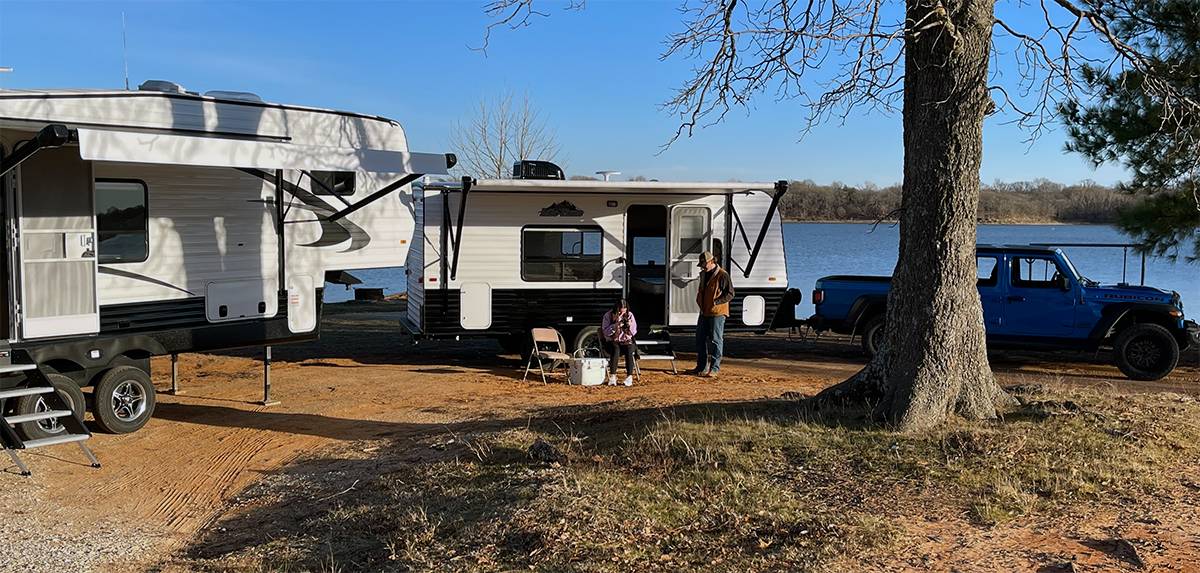

Sadly, I agree with your conclusion. I tow several different trailers, either RVs or a 16’ flatbed almost weekly for short distances and my Rubicon is capable of towing everything I have hitched it to but it isn’t an ideal tow vehicle. Today we took 2 RVs to our local lake to get some pictures for an upcoming ad and I had absolutely no trouble with the 3,500 pound, 21’ travel trailer that you see in the picture. The largest RV I’ve towed was a 26’ long, 8' wide travel trailer with a dry weight around 6,000 and even with a weight distribution sway control hitch the wind pushed it around and it struggled going up hills. The only thing that ever bothered me towing with the JT was the lack of visibility from the OEM mirrors. It isn’t bad now that I have a set of tow mirror adapters and rampage mirrors. Those little things help a lot but pulling anything other than a flatbed and the Jeep factory mirrors just aren’t enough. I also feel that the JT is underpowered for daily towing. It will work but it isn’t what the JT was made for. My personal opinion is that you would wear it out very quickly daily towing a 5,000 pound enclosed trailer, even short distances. I traded an F150 for the Gladiator and do not regret it a bit, but I love my Jeep way too much to expose it to the stress of towing 5,000 pounds every day. If I still did that on a daily basis, I’d have at least a half ton full size truck.

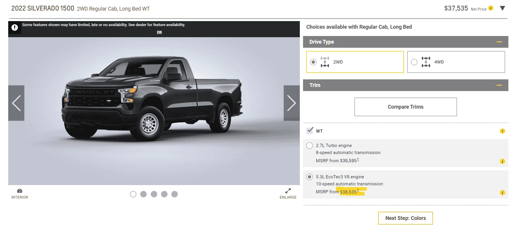

If you are doing work get a work truck, chevy has some very competitive 1500's with 5.3L v8 no frills plain white singe cab work trucks for much cheaper then a JT or other high demand truck (aka ranger) get the cheapest truck that does the job reliably, beat it up, use it ,depreciate it as part of your business expenses and keep something nice for home once your business takes off.
i know people have their brand loyalties but a simple chevy with no features is pretty simple and the 5.3L has been around for ever.

Ok, this helps too. I think for these cases where you are gonna tow on a weekend, a boat, something like that then I love the Gladiator use case. But yeah, getting vibe for regular towing it probably just isn't the right call.

I am considering this route as well. However, given my life situation, I am thinking a truck I can use for work but is also acceptable for not-work and my only vehicle probably works better at this juncture.

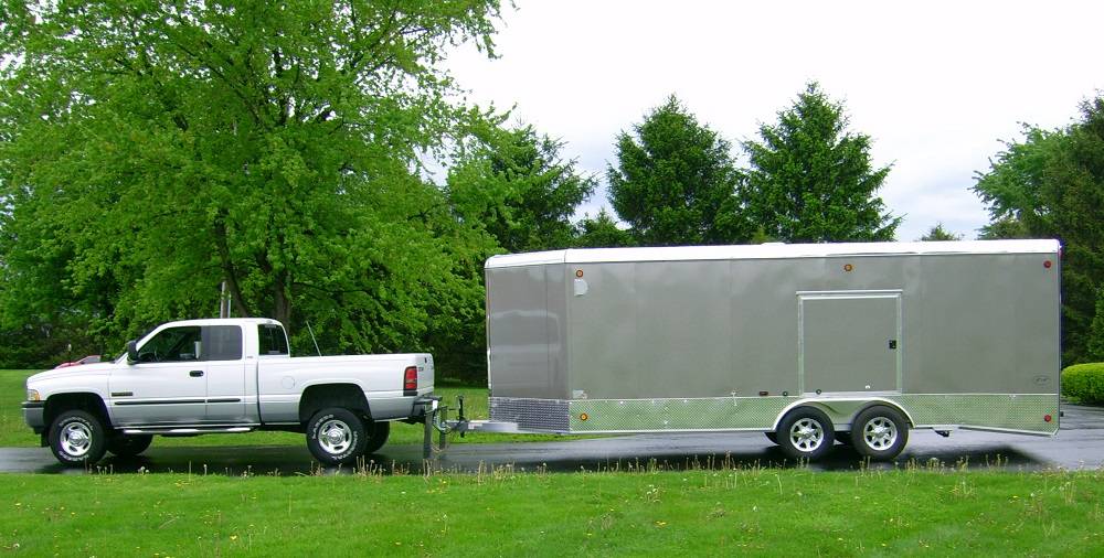

Previous to my current occupation driving truck, for over 20 years I was in my family's truck cap & accessory business as shop manager/lead installer of truck accessories including all types of hitches & towing equipment.
This experience provided the basis for the general views that I expressed about the pitfalls of aftermarket add on towing mirror extensions.
The fact is, the vast majority out there will be a disappointment at best for long term durability, and down right useless due to vibration/wind buffeting in most cases.
If the OP decides to go with a Ram truck, the OEM factory accessory tip out towing mirrors will be the way to go for an extendable mirror that was designed as a permanently mounted solution for daily towing use.
When deployed in the towing position they will provide him a good rear view back along the sides of the trailer, plus the advantage of having a convex mirror portion built in which will provide the additional rear view blind spot coverage he needs while towing his enclosed trailer.
When using the truck for personal travel without the trailer, they can be quickly/easily retracted so he isn't driving around town with mirrors sticking out like "Dumbo's ears" everywhere he goes. ;)
My '01 Dodge Ram 2500 has the 1st generation of these OEM factory accessory tip out towing mirrors.
They work very well when towing my enclosed car trailer, and are rock solid with no vibration or buffeting issues at all.
