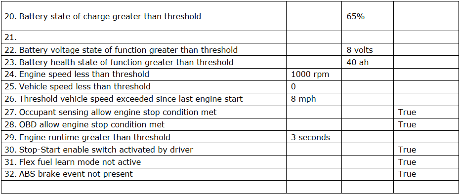

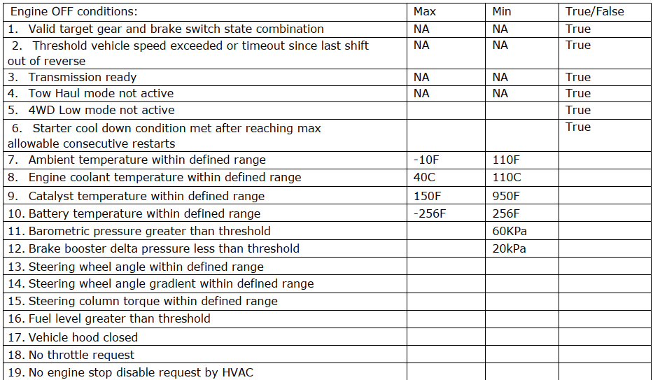

Is anybody aware of a way to track down the reason behind `Not Ready` ?
There has to be a way to determine the 'reason'....

Extreme cold or extreme hot exterior temperatures will disable it. I'm not sure but I think it displays the message when it's blocked from temperature extremes.
No, unless you can monitor dozens of criteria like O2 sensor temps, cat temps, and a whole list of other stuff.
You could have a sensor that's incorrect and lying to the system telling it that something has not reached a certain temperature and so on. Or the IBS could be way off (so reset it)
Jeep Gladiator Dealer Trip / No resolution / Trying to come up with solutions for ESS issues 1673653818763
Jeep Gladiator Dealer Trip / No resolution / Trying to come up with solutions for ESS issues 1673653840815
20, 22, and 23 above are why I strongly recommend performing the steps below - make bloody well sure that BOTH batteries are 100% charged independently, and reset the IBS.
These steps helped my 2020 greatly. It worked a lot better - not perfect because the batteries were aged, but it helped -
Yes, normally that's around 110 degrees, and 10 below zero for high or low temps and it will display that. I've seen the low side before, but not the high side, thankfully.
That's surprising. I know mine was off for heat several times last summer when the ambient temp was maybe 90.
We hit mid to upper 90s here several times last summer. HVAC needs trumped everything else those days so can't say if it would have worked or not due to temps.
