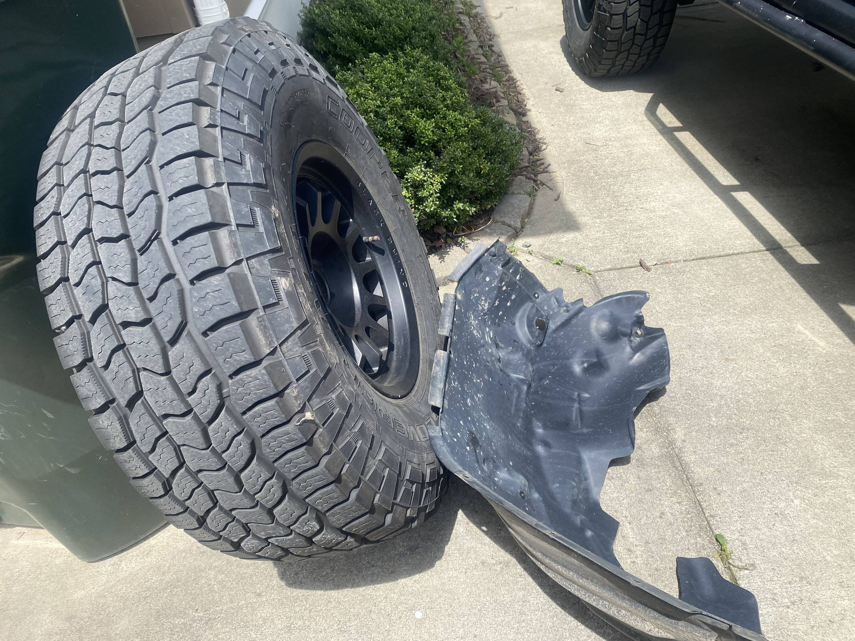

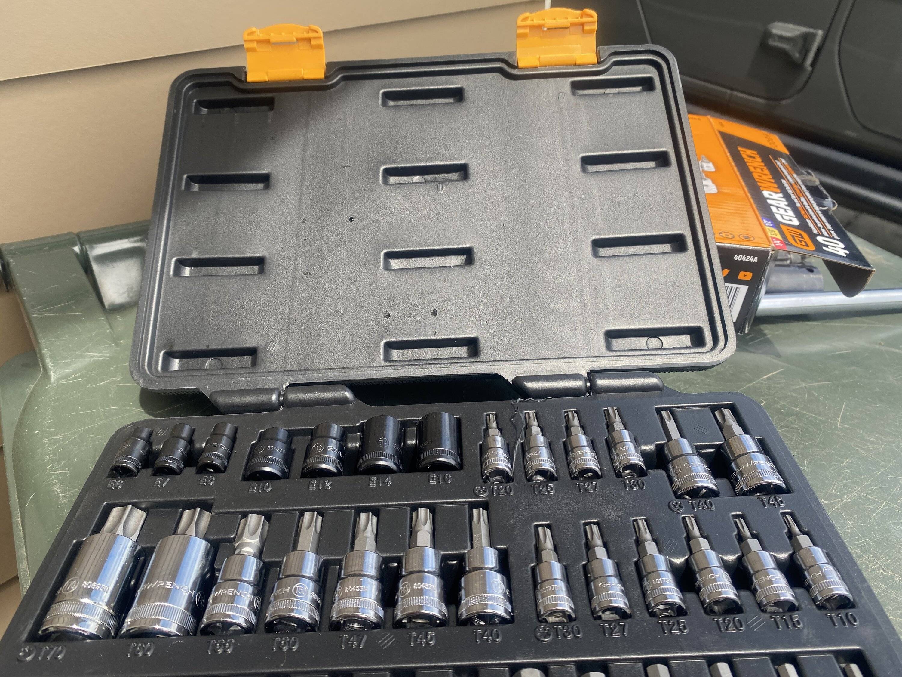

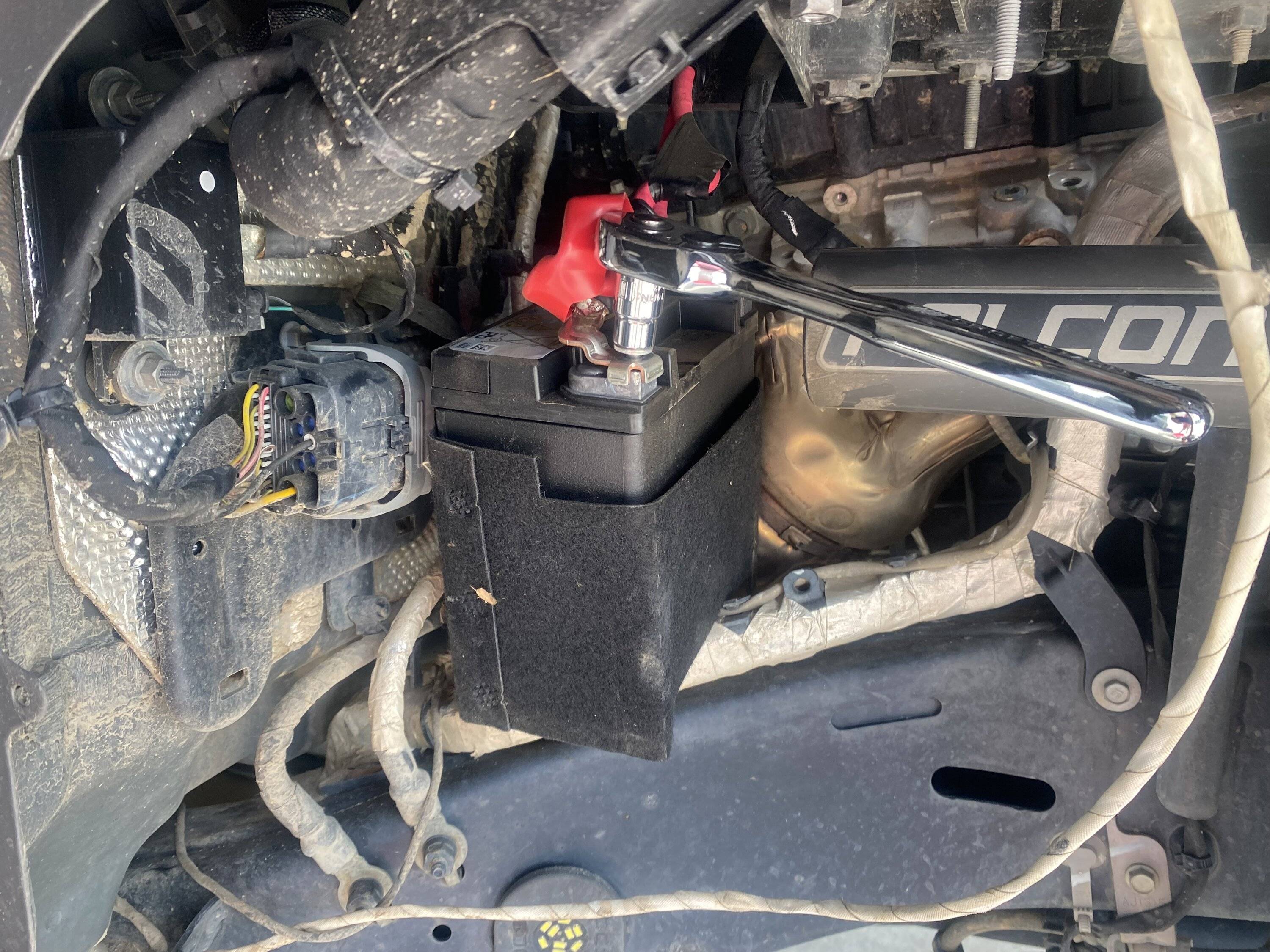

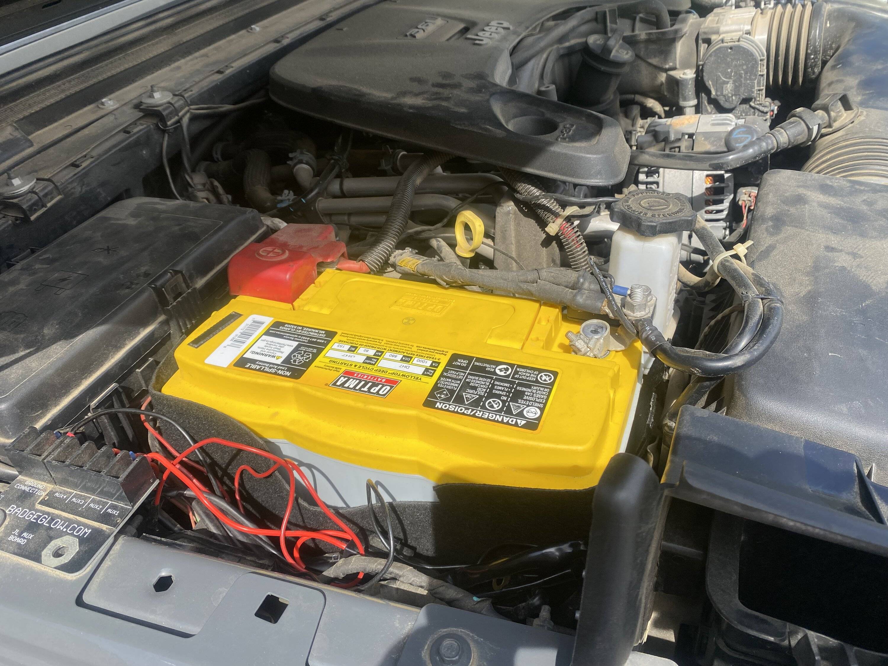

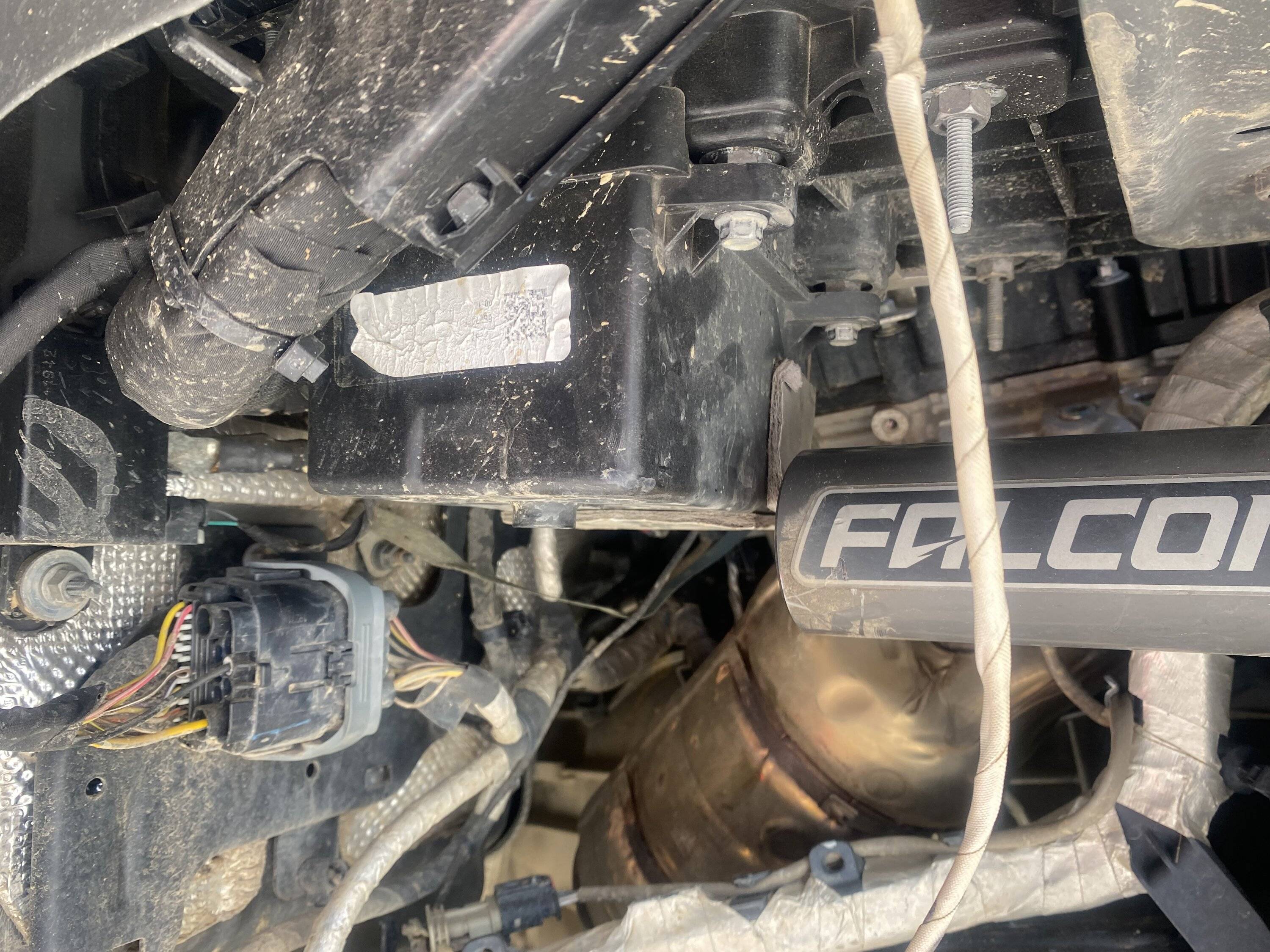

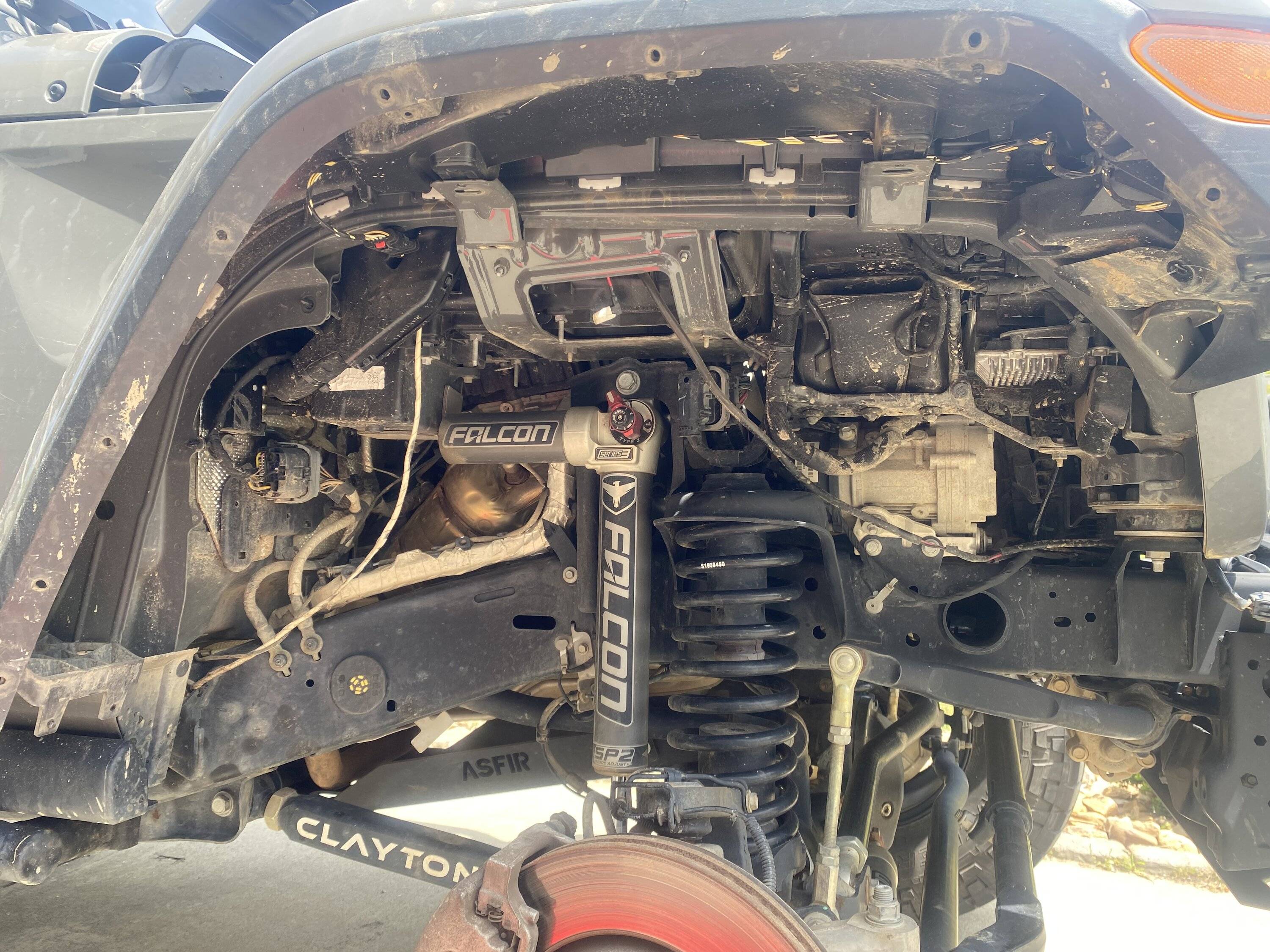

Great thread - thanks for posting. I had same issues. JT left me stranded in the middle of three lane traffic…. Luckily another forum member showed up to jump start me and follow me to the house. But he did it in a Ford…. Either way replaced my main battery with an Optima 880 CCA and the Aux with a Duralast Platinum. Both from Autozone (who provides a 10% military discount - thanks!). Ended up costing me $482 all in with taxes and core returns.
my only issue now is my front and rear cameras don’t work. I am going to try to reprogram my mini tazer tomorrow to see if that fixes the issue. Initially my check engine light was on, but in the trip back to autozone to return the cores it went out.
Thank you @OVERLORD for posting the YouTube video. It was spot on. Much easier method to get to the Aux battery.
I added a photo of the bit set because I was super mad that I had to buy the entire set to get the right socket to remove my from seats when I replaced the flooring. Turns out you need the E6 to remove the “stems” from the old Aux battery and install in the new one. Win-Win!

As I did not have an E6, I found that pressing a 4mm or a 5/32 will do the job as well.
