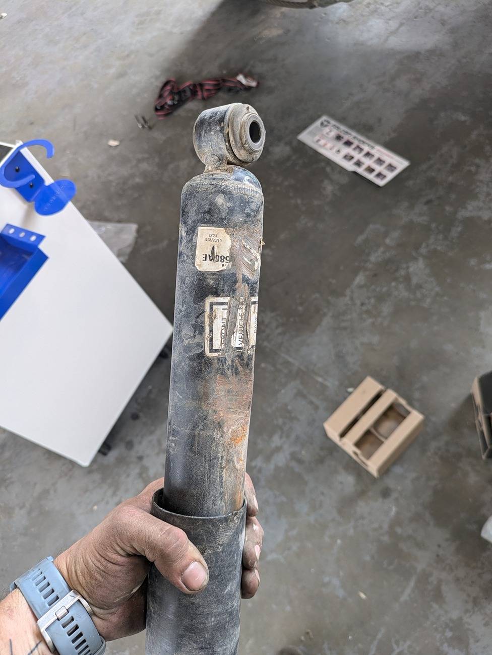

disassembled and retorqued the list kit over the weekend, checked balljoints, other suspension components thoroughly. swapped wheels and tires from our Sahara and deathwobble still there. spoke with 2 reputable jeep shops monday, they both told me the same thing, pull the dampner, check for any dead spots or variable resistance. mine had a dead spot. new dampner installed problem solved. can hit any pothole at 80mph and no wobble. amazing
one of the shop owners told me he was in the dont replace the dampner camp for years, but ha has had several 2020+ jeeps with wobble that they found nothing wrong with but a bad dampner
take it for what its worth

My DW became light wobble and is now gone. #1 control arms take lots of torque, it is easy to not hit the values. #2 Track bar bolt holes have lots of room to move. It needs to be really tight or even better, replace with larger hardware. #3 My drag link rod end were bad at 40k and could see the movement. Replaced it. The tie rod looked fine, but was NOT. Rod ends were bad when I finally pulled it off and replaced it. #4 Ball joints passed the pry bar test. They were NOT good. They were floppy when removed and were badly in need of replacing. #5 My tires were both off balance and the tread was cupped, both from wheeling and from the wobble that caused uneven wear. I replaced them and am 100% wobble free. I mean absolutely great now. Feels like stock and I'm on a 4" lift with 37s. Tires absolutely can cause wobble, but not death wobble. Tolerance stacking is what causes DW. Enough parts that have a little movement add up to enough overall.

FYI, Dampener is never the cause. It only covers up wobble from another source. Once more item I forgot is the steering box. There are 4 bolts there that need checking as well.

I drove around for 2 weeks without a steering dampener, post 3.5" lift, on 37" tires. No issues what so ever with DW.
Mine was completely inoperative for 18 months, no death wobble.
