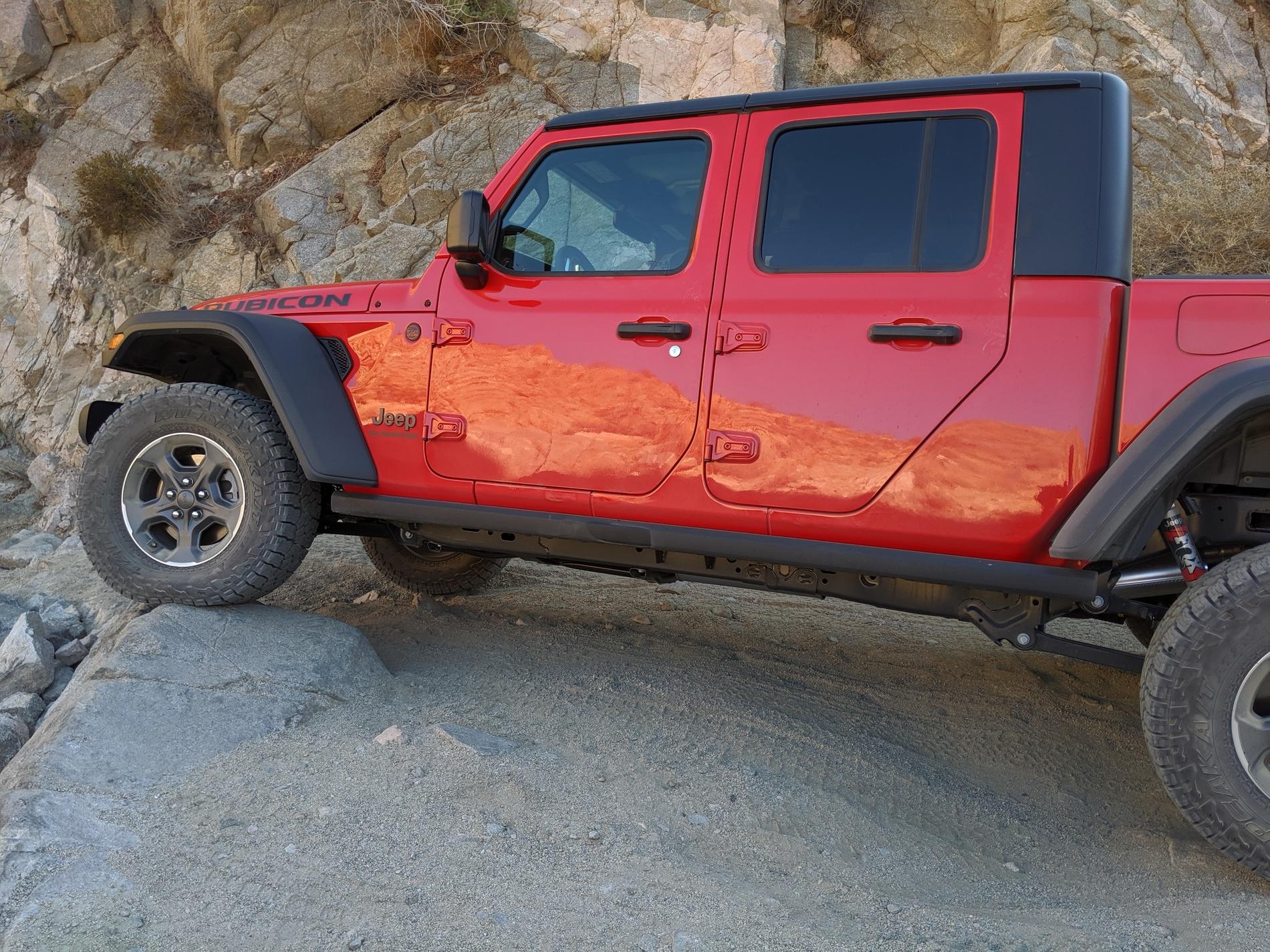

Gladiators are a unique brand within a brand that could create it's own club or forum outings with trails specifically set up for it's unique wheelbase. While this can be seen as a challenge, I don't see it necessarily as a hindrance to having fun on the trail.

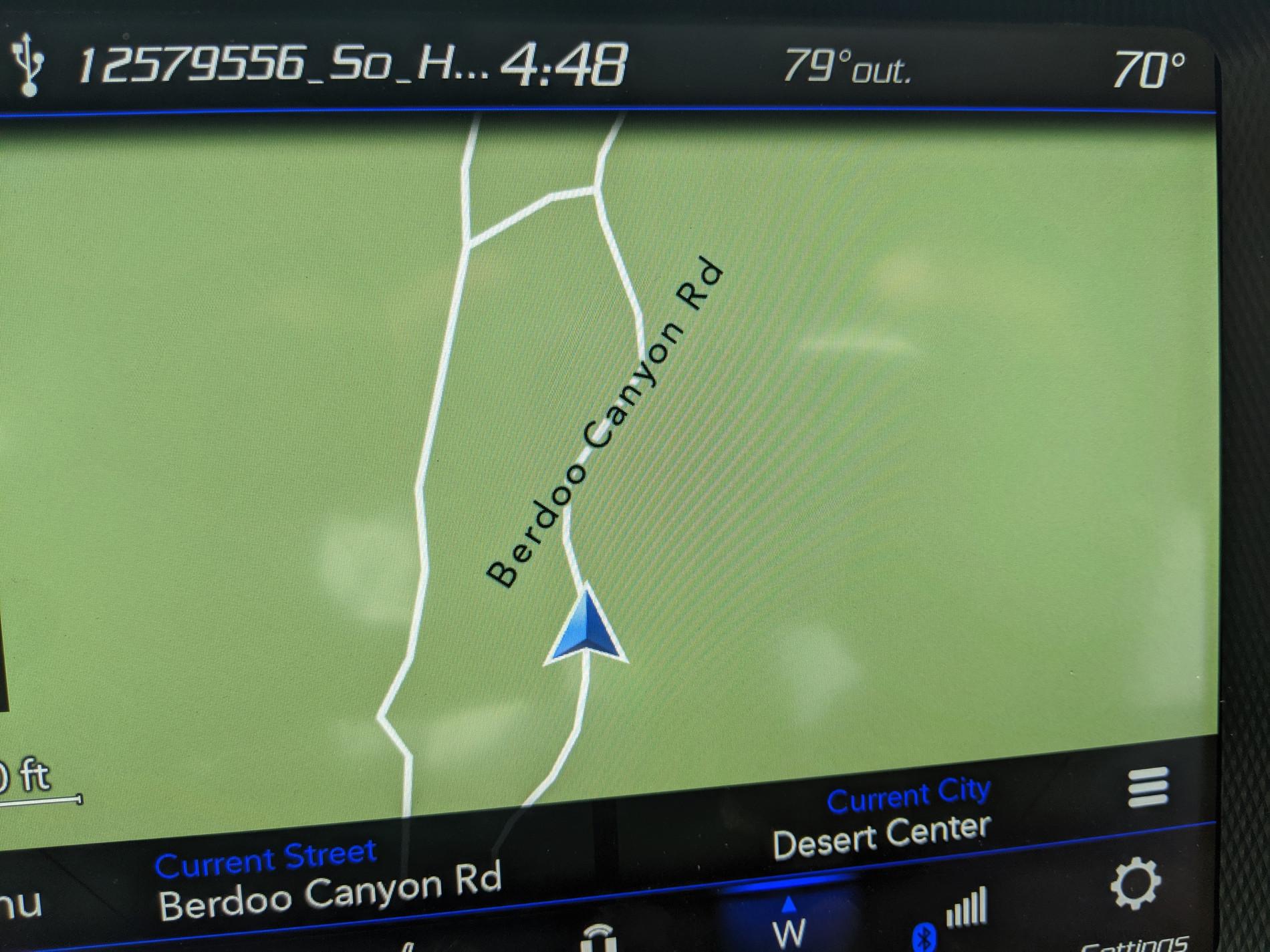

Every year, I organize an annual Joshua Tree during MLK II weekend. My run has brought together as many as 41 Jeep owners (with a couple of Toyota drivers as guests). This year will be interesting as I will have my Gladiator lifted 4.5" with the EVO MFG suspension and 38" tires. Berdoo Canyon road will be much less challenging than in stock form. I will answer lots of questions about the Gladiator and my build on that run, and maybe the shorter wheelbase JKs, JKUs, JLs, JLUs and even TJs and TJUs will be able to keep up with me!
