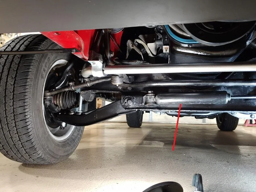

You have a lot of good things to say...HOWEVER PLEASE do not call the Steering Stabilizer a Band-aid. A Band-aid is something you put on a problem after you have incurred that problem. The SS is an integral component of the steering and suspension system.
Mallai
Oct 25, 2019
NY
2020 Gladiator Sport S 2019 KTM 1290 R 2018 KTM 300 XC-W
I have 400 miles on my Gladiator. I recently replaced the stabilizer with a new Fox unit. The stock vehicle ā€œwanderedā€ all over the road and I just couldn’t deal with it. The Fox stabilizer tightened the steering up perfectly. But now I have major DW and don’t know what to do. Jeep will probably give me a hard time because I changed the stock stabilizer. I’m driving to Georgia in it next week (1800 miles) and don’t know what I can do. I’m really not at all happy with this purchase, coming from a perfectly good ā€˜17 Ram 1500. What would you do?
40,483
53,965
Even in the 1980s it was integral. It shouldn't be used to fix issues of worn or damaged parts or POOR design or modifications that put the thing outside of the borders of its engineering, but it's been a part of 4x4s for decades as shown here - 1982, factory design -
