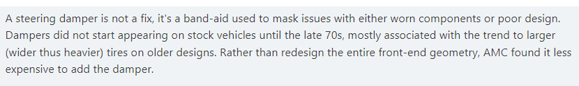

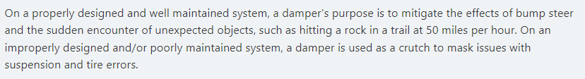

Change your panhard to a Clayton HD AND at the same time change out the panhard bracket to a Synergy weld-on bracket. look at my other reply in another dear wobble post
whatever you choose to go with........... it's truly only masking the true problem that the truck still has.
Norm Layton says -
Even a long-time suspension engineer for FCA and other companies concurs.
It typically happens with worn or loose parts, lifts, and tire and wheel swaps that change the scrub radius and cause the tire to want to pivot around a different point, back and forth. So those who swap to the "cool wheels" to "wow their peers" are asking for death wobble.
If you are happy, then it's cool. But if things are 100% correct, tight, and within engineering design, no damper is needed.
This is a quote from a true expert, not people on forum sitting at home figuring out what the experts and engineers can't -
Yes, Chrysler says "if it wobbles, replace the damper" in their docs - that's because it's a cheap, easy, fast way to cover what they may spend hours trying to find - and gets the customer home quickly and quiets them down.
